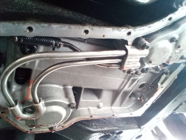

This is with the transmission pan and filter off.
May 18, 2023 at 5:09 PM

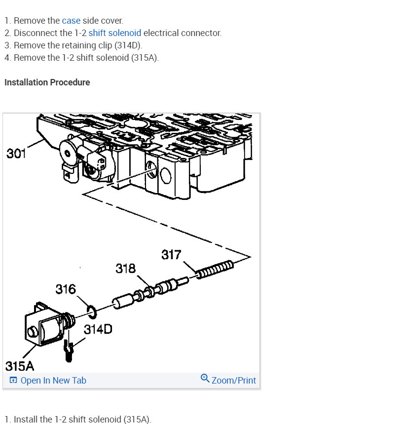

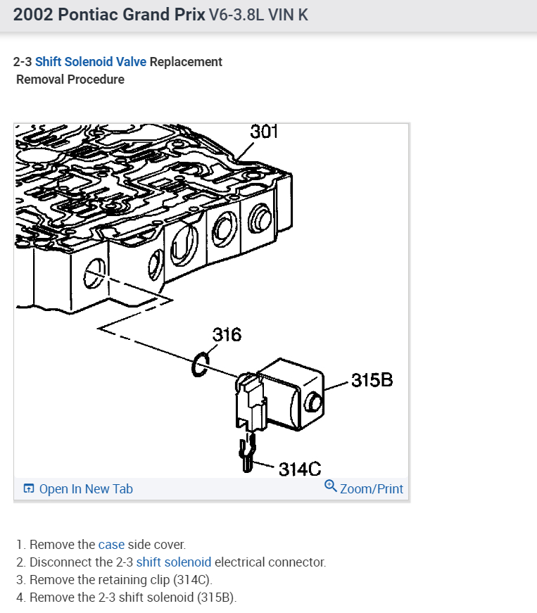

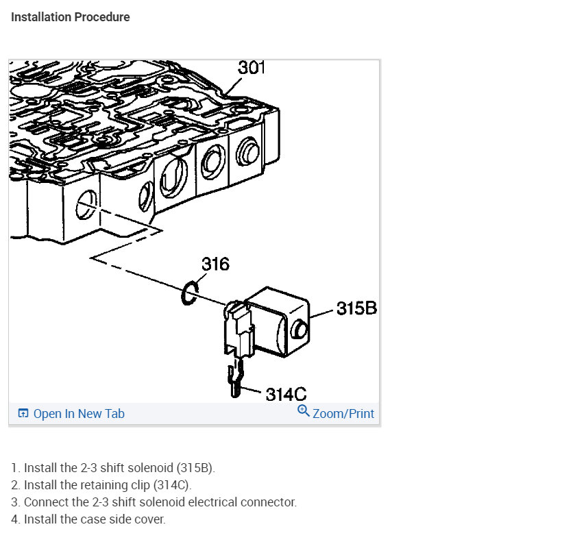

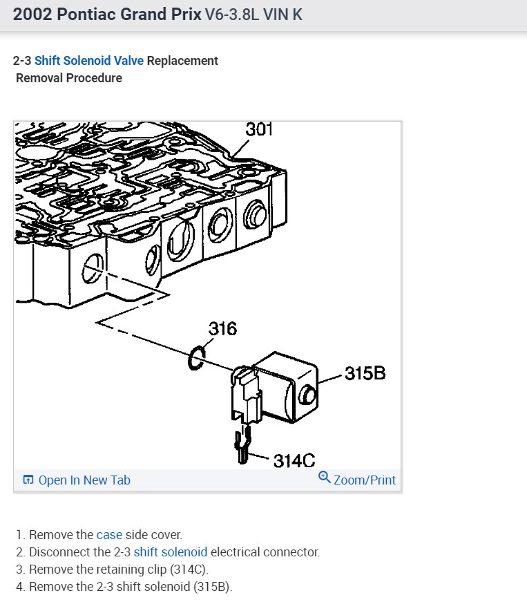

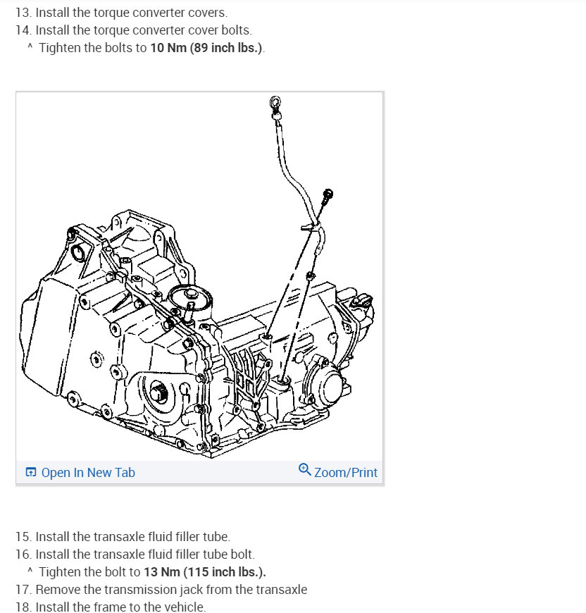

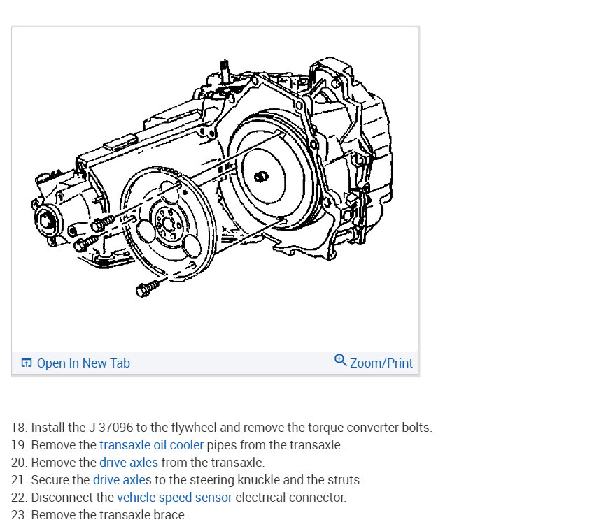

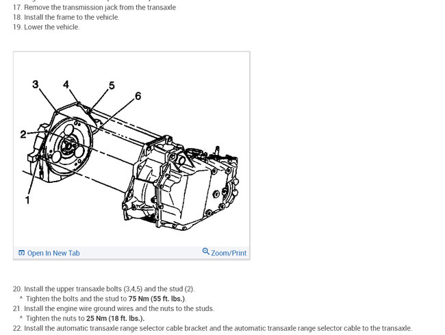

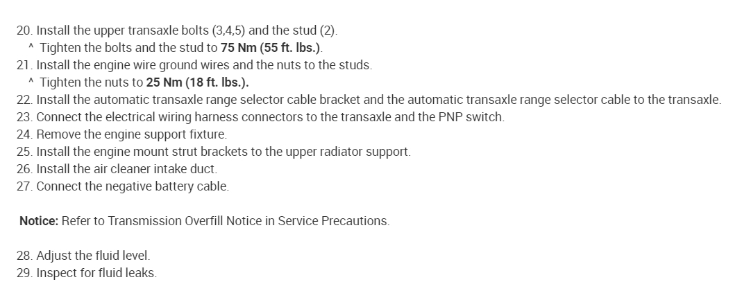

Sorry the pan you need to remove is on the side of the transmission to replace the shift solenoids. Here are the location and instructions in the images below. Check out the images (below). Please let us know what happens.
May 19, 2023 at 12:07 PM

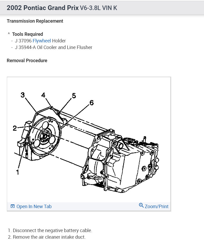

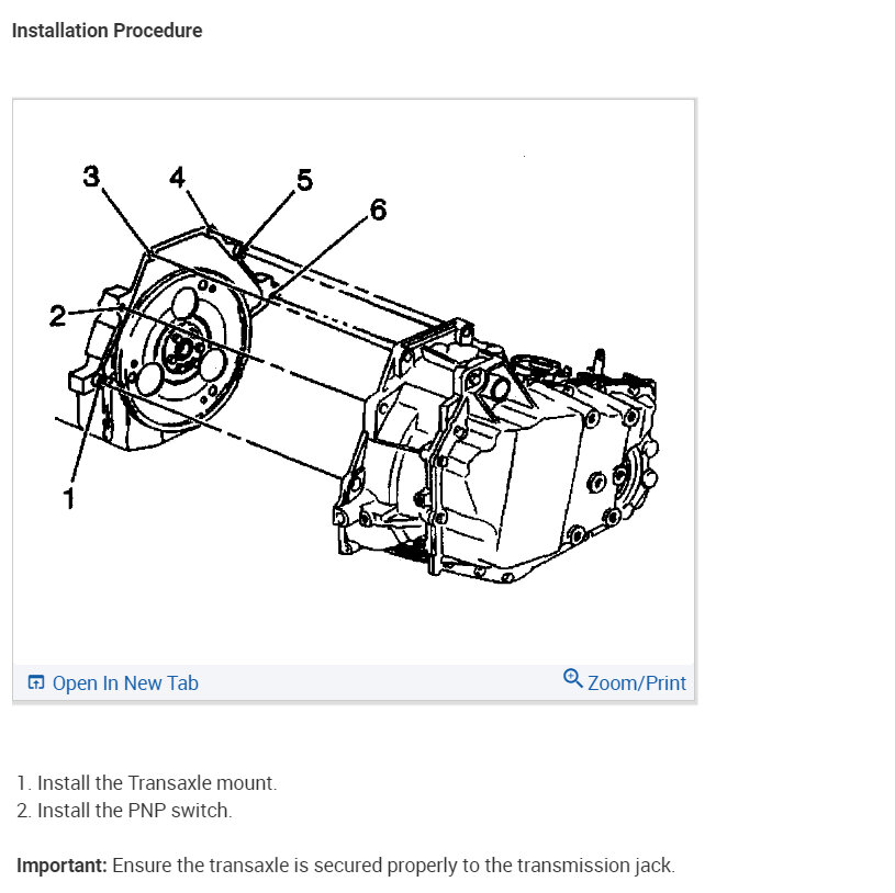

So, do I have to drop the transmission to get to the shift solenoid?
Jun 3, 2023 at 6:03 PM

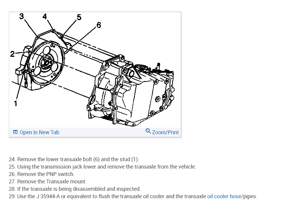

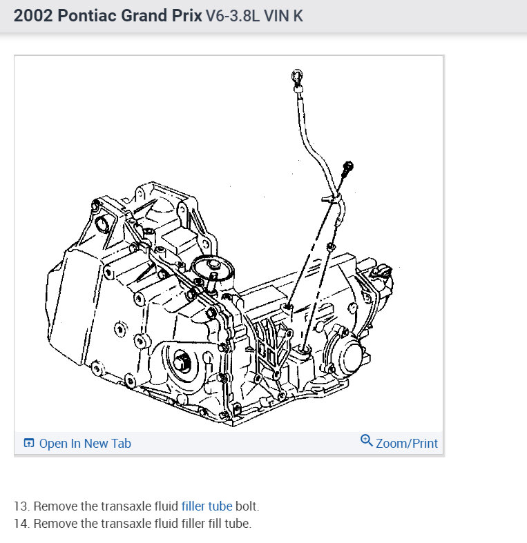

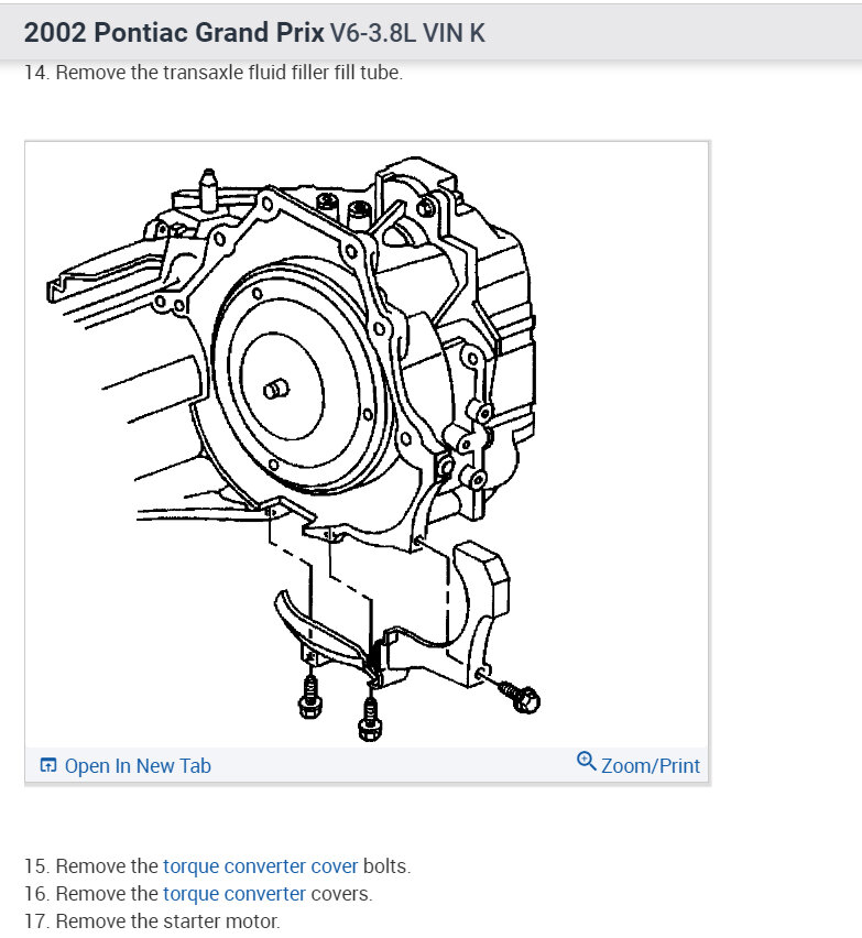

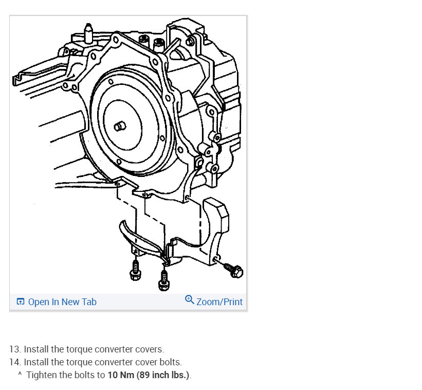

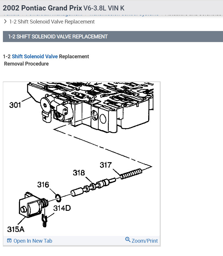

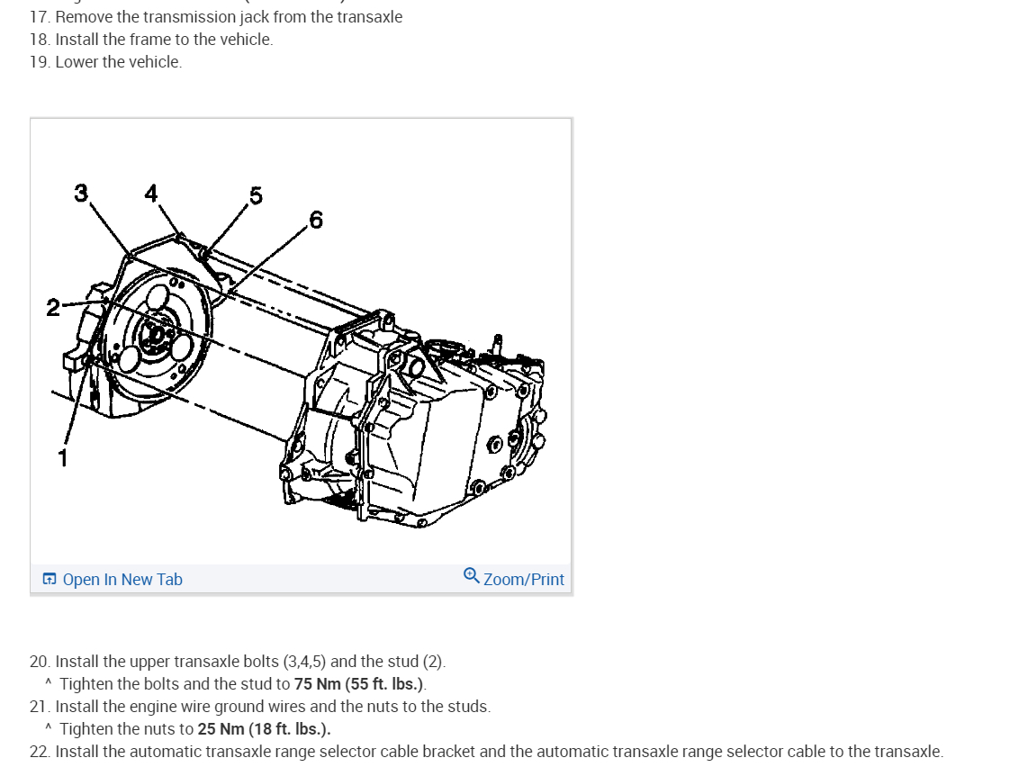

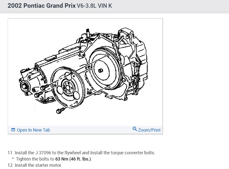

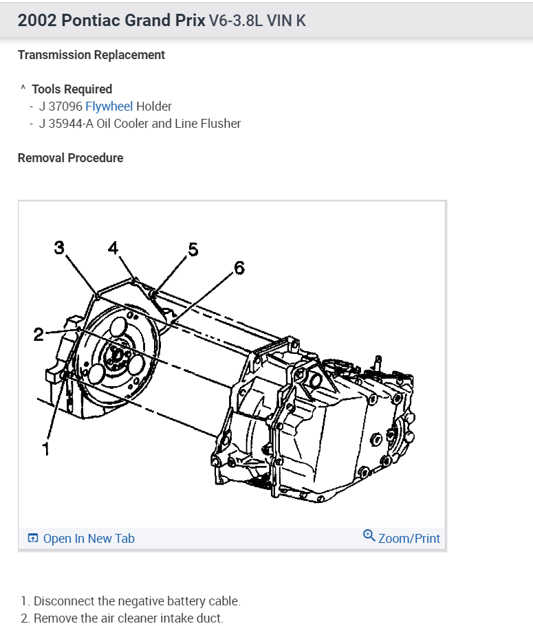

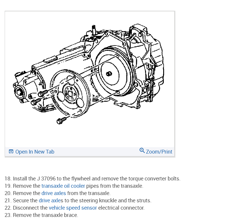

It looks like it. You may be able to remove the transmission and maybe an engine mount to lower it enough to remove the side pan. Here is how the job is done. Check out the images (below). Please let us know what happens.
Jun 5, 2023 at 9:22 AM

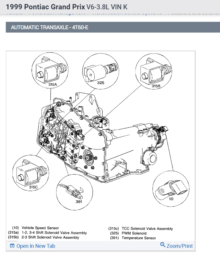

I just found out that the paperwork on the Grand Prix is wrong. It is a 1999 Pontiac Grand Prix. Any chance you could tell me where the shift solenoid is located still?
Jun 8, 2023 at 2:06 PM
No problem, it looks like it is in the same place. Check out the images (below). Please let us know if you need anything else to get the problem fixed.
Jun 9, 2023 at 10:54 AM
