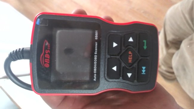

If your ABS and airbag light are on then there has to be codes or the code reader could not communicate with them due to the code reader not being capable or they are not communicating with the tool.
What scan tool/code reader did you use to check codes?
May 13, 2021 at 6:38 PM
BRAD PILLOUD
  • 11 POSTS
I've put my hands on every wire I can reach in this darn thing and I cannot figure it out.
BRAD PILLOUD
  • 11 POSTS
This Chinese dealio.

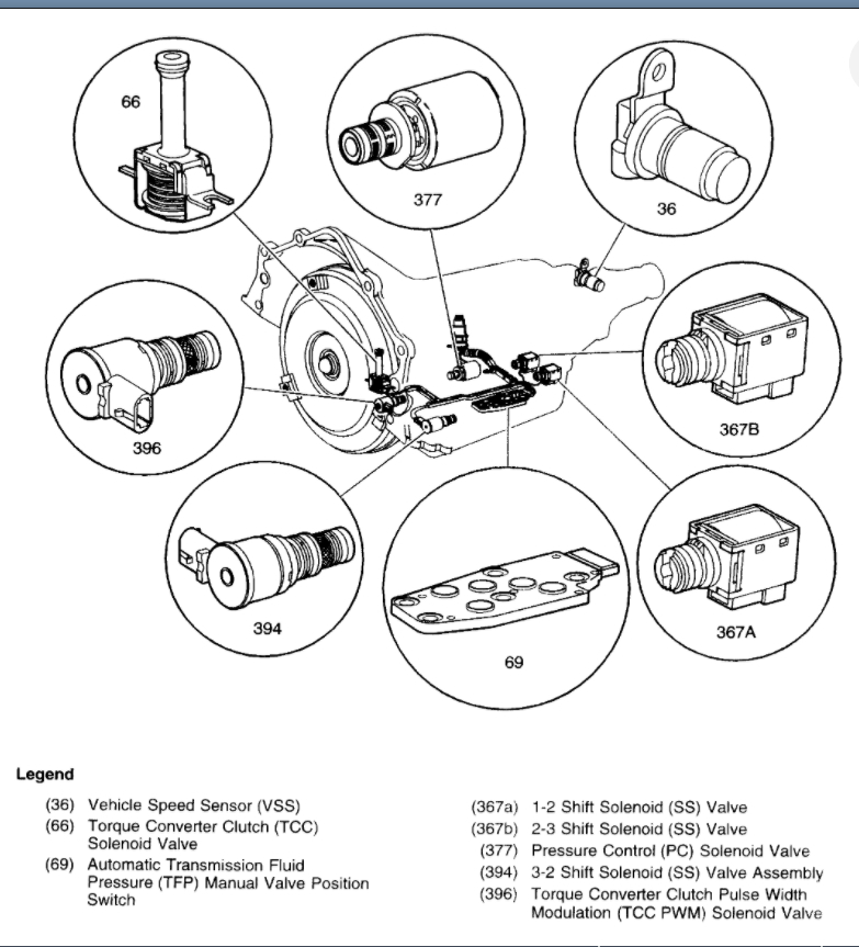

So focusing on the transmission issue, I need a complete breakdown of what you have done so far, what transmission you have (assume you have the 4L60 but you could have the 80). I see you did solenoids but did you do all of them or just the 1-2 solenoid?
Next just double check the fluid for level and condition and we can go from there.
I have seen a bad cluster cause this problem. here is a video to show how to replace it with a rebuilt unit:
https://youtu.be/_HEC44xENxw
BRAD PILLOUD
  • 11 POSTS
I did solenoid 1 and 2 only the fluid was dark, but there was not any debris on the magnet other than the expected amount of the magnet sludge for this many miles, but nothing that would lead me to believe that any part of the transmission broke.
