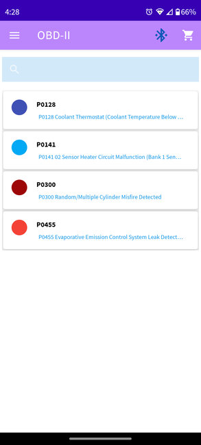

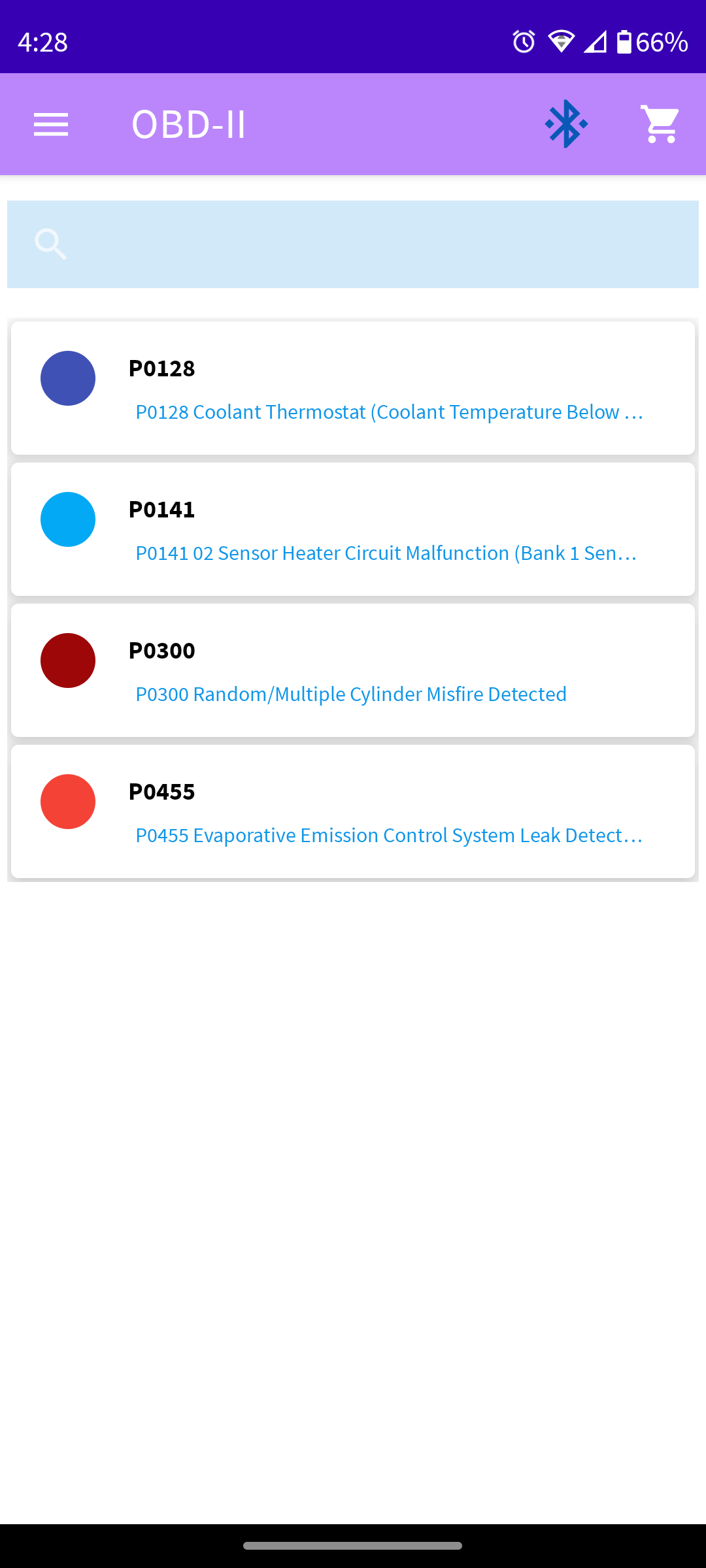

Okay, Y'all, pray all are well. Saturday morning drove it to parts store and back. All good. She takes it to the store and the dang thing starts hesitating on complete stop take off. It is not the stuttering the transmission does, we have that too. I'm going to check vacuum lines and obvious stuff but it threw 4 codes. Attached are them. Which one if any would cause da problem if any?
As always, we appreciate Y'all, BobbyB

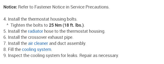

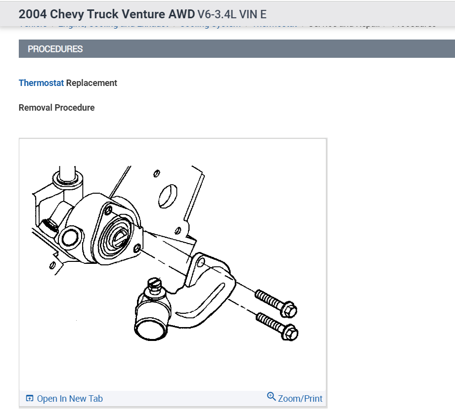

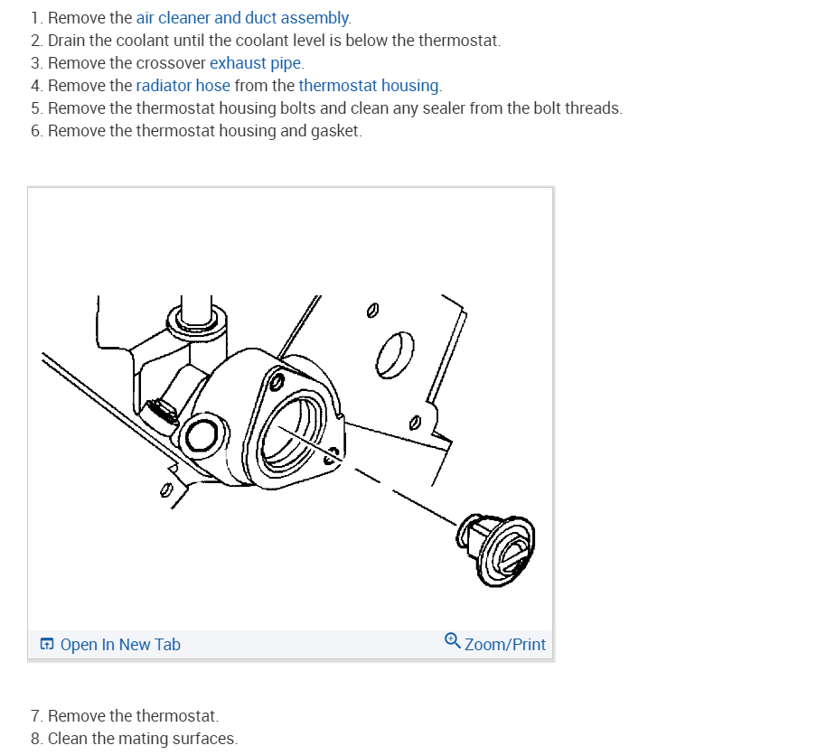

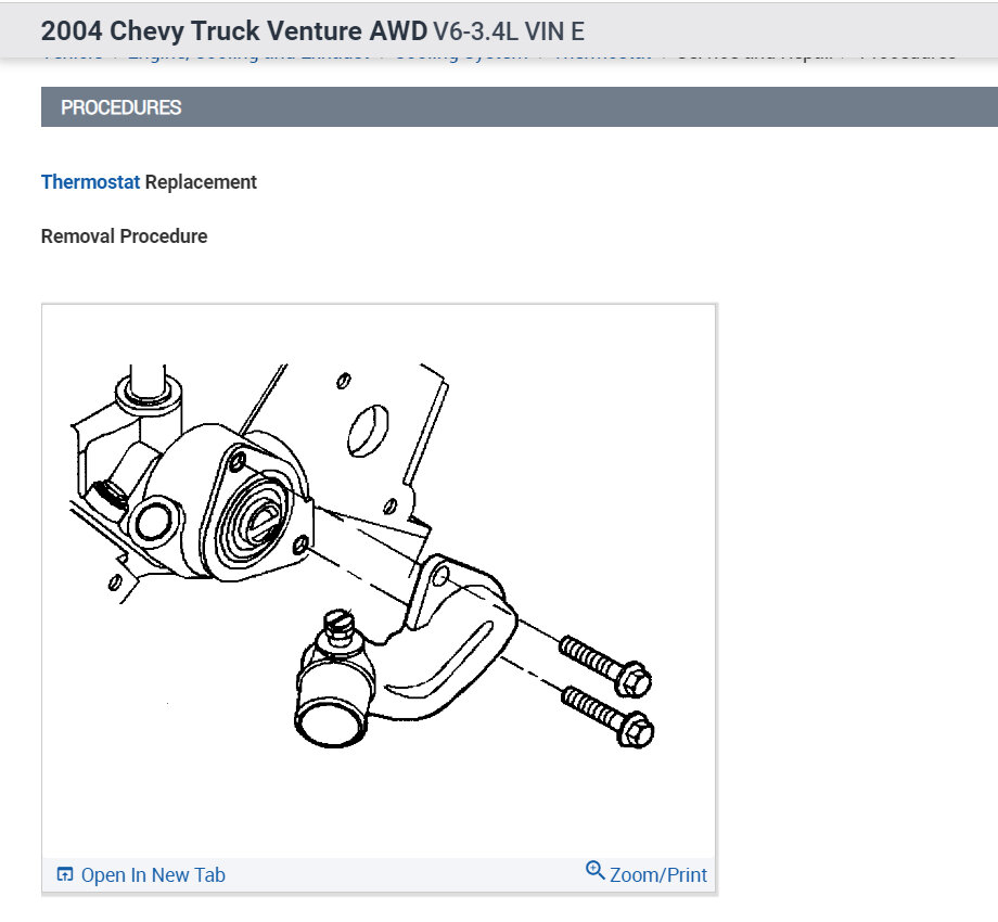

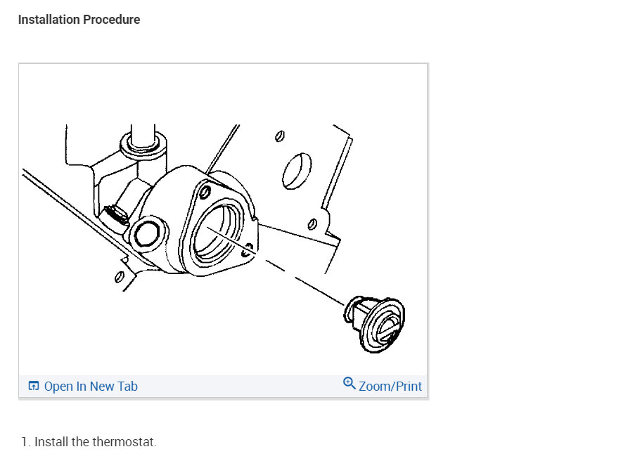

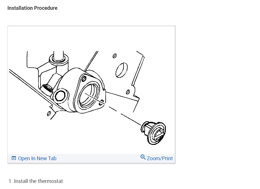

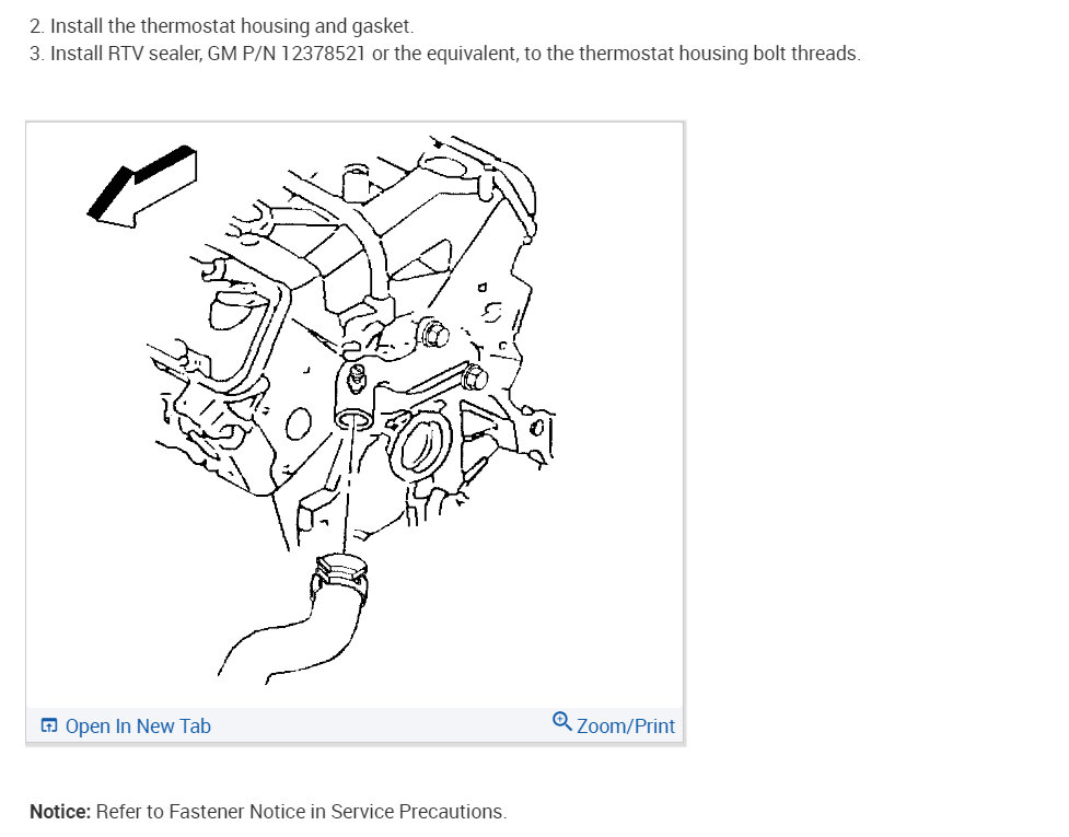

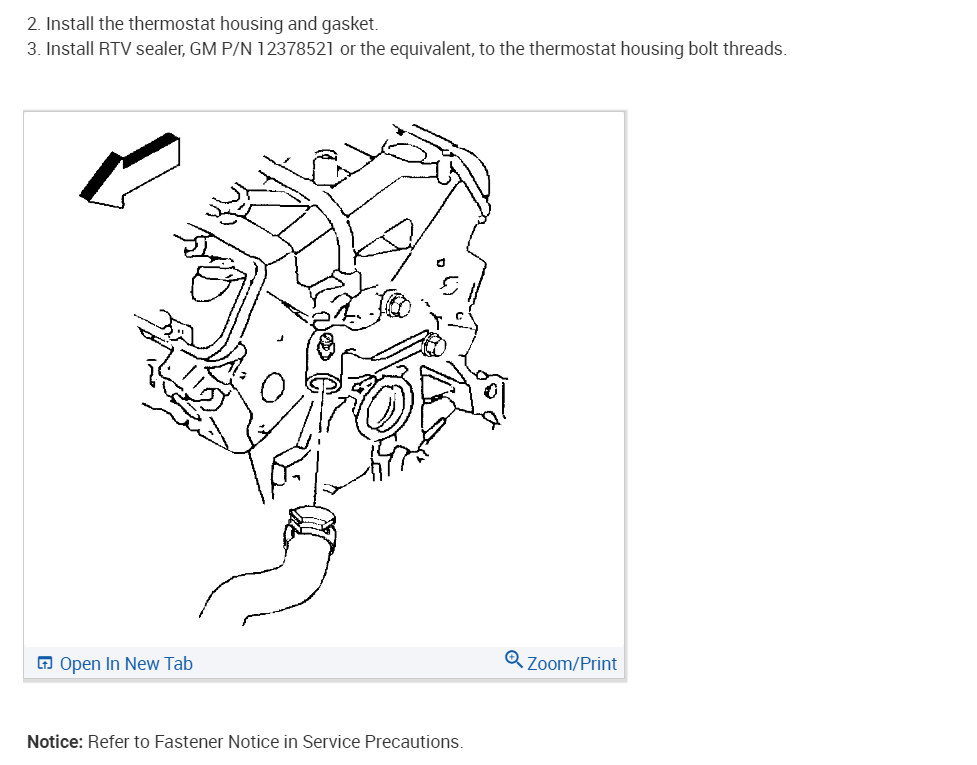

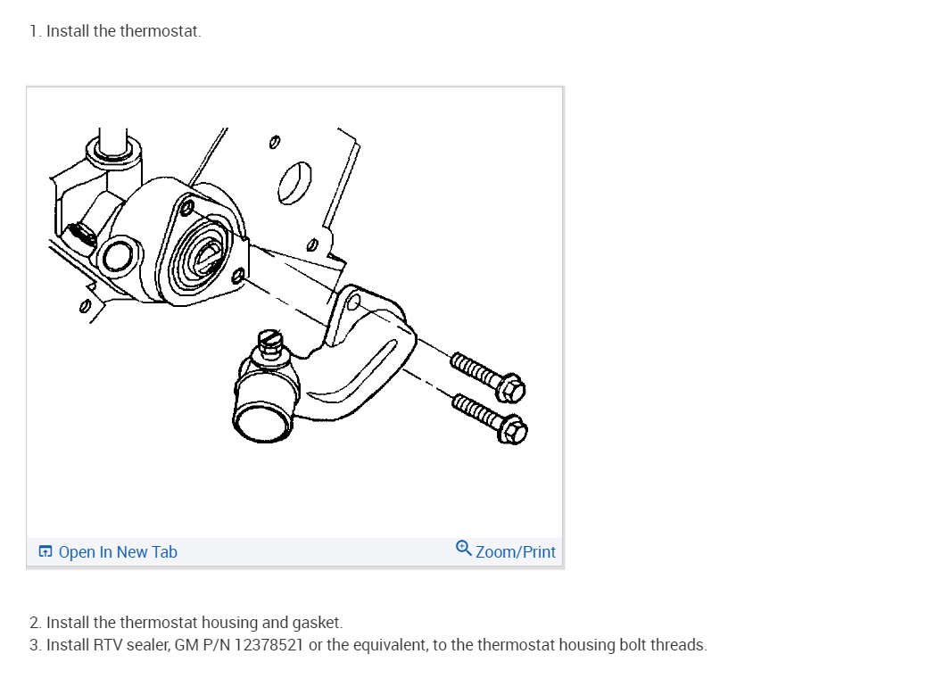

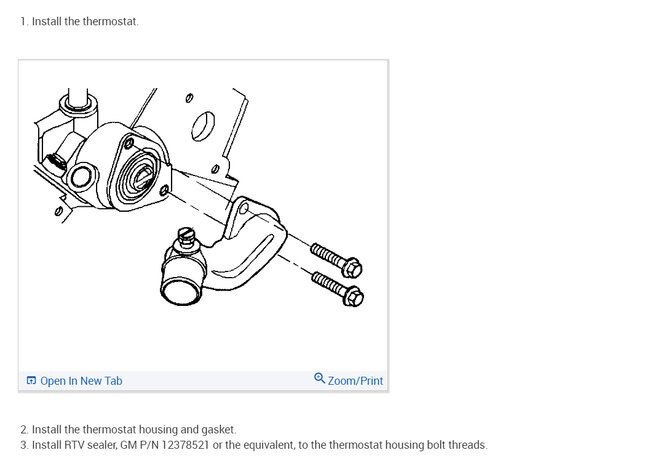

One only handle one problem per thread so you will need to make new question of the other four problems, we will handle the p0128 code on this thread which means you need to change the engine cooling thermostat out for a new unit. this guide can help walk you through the job and I have included instructions in the images below for your car.
Check out the images (below). Please let us know if you need anything else to get the problem fixed.
