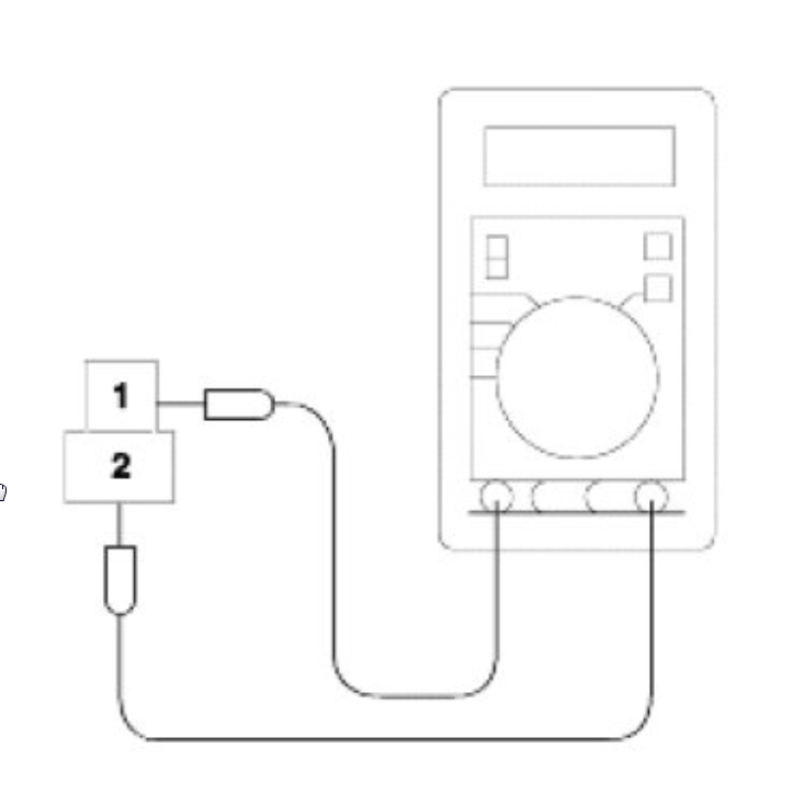

Every time up shifting into third gear the transmission knocks and the car jumps. Seems to be common but can't find a diagnosis.
Oct 7, 2019 at 1:21 PM

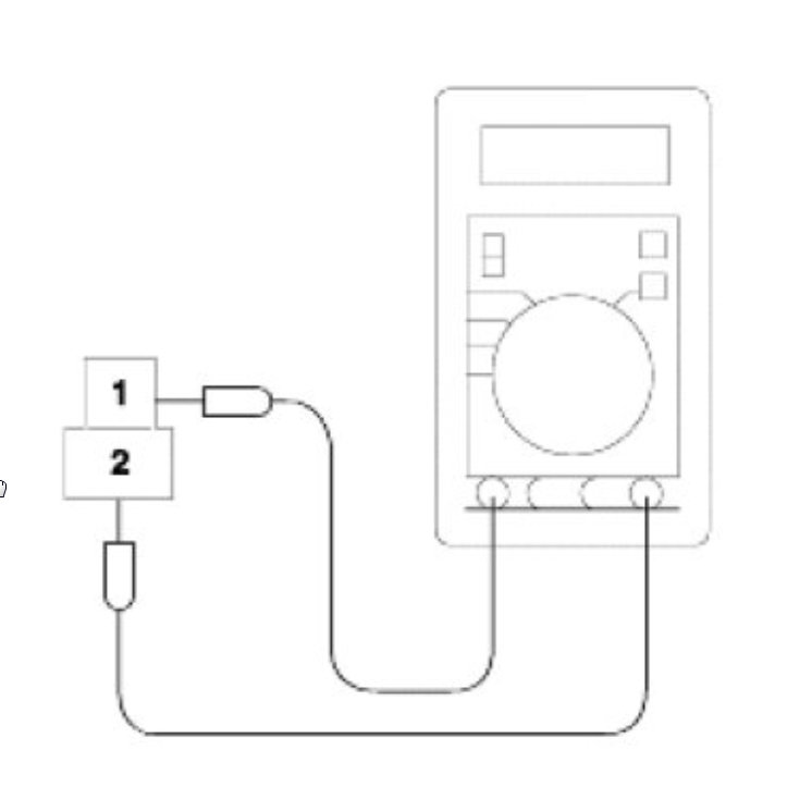

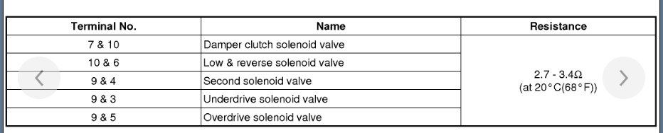

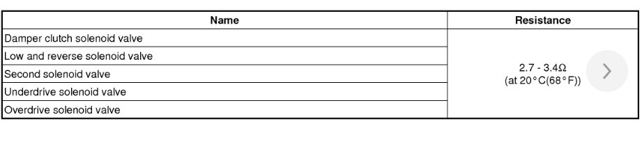

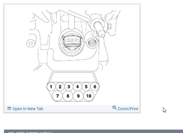

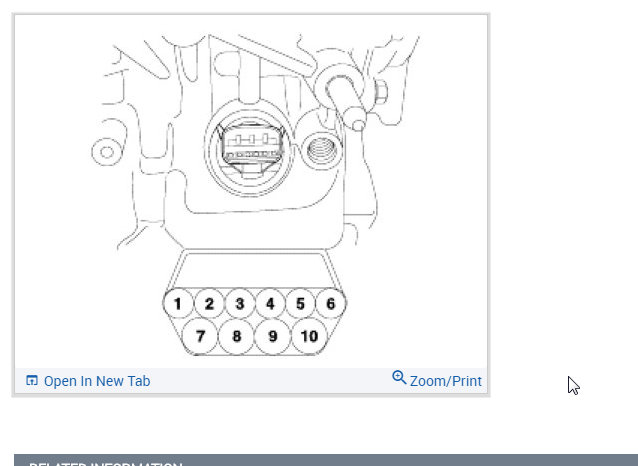

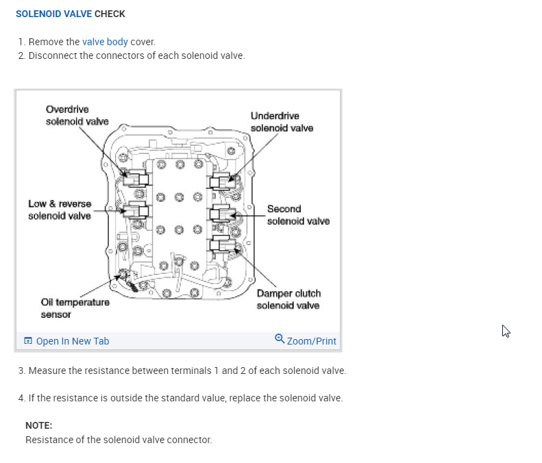

This sounds like a shift solenoid issue. Have you replaced any components in trying to fix it? I attached the info that you need to test these solenoids to try and find the cause.
Please let me know if you need more information.
