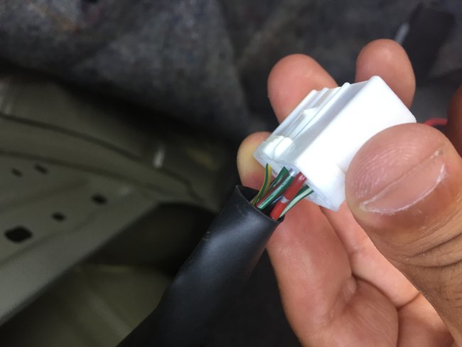

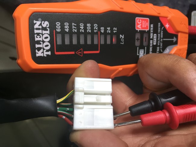

Found sensor, checked red wire and there was a twelve volt reading. so is senior bad or is there a break in the line to the third light ?
Mar 11, 2021 at 11:57 AM

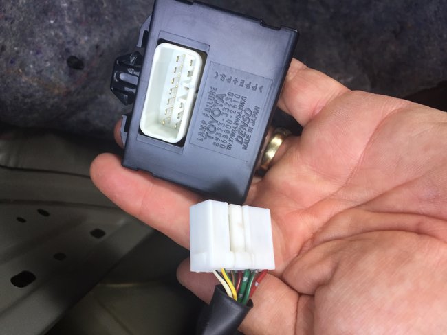

They had big problems with that sensor, if you open it up you will probably see a burnt connection where the sensor fails.
Please let us know what happens so it will help others.
HERRERAJR63
  • 4 POSTS
Thank you. Funny that you say that. Once I took sensor out I shook it a little and heard a little rattling sound and I thought about opening it. Will advise of finding.
CARADIODOC
  • 34,306 POSTS
If you are getting twelve volts on the red wire when you push the brake pedal, it should be good up to that point. That would suggest that wire is broken between that point and the bulb.
