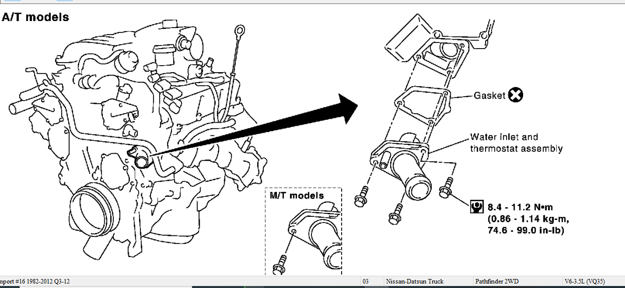

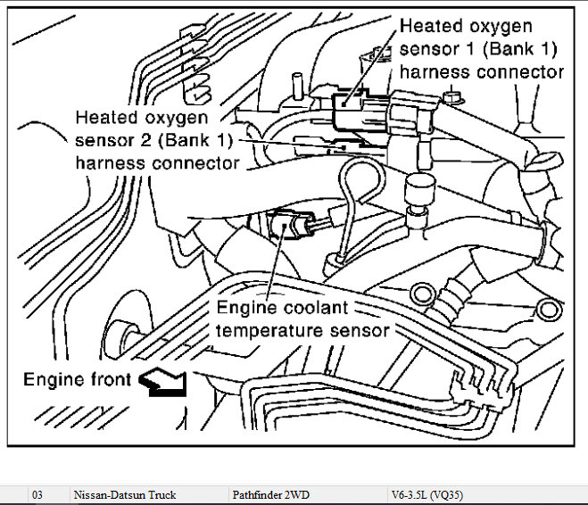

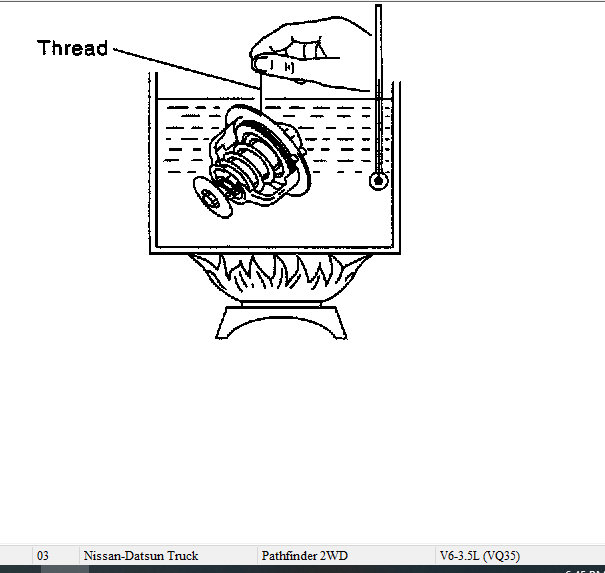

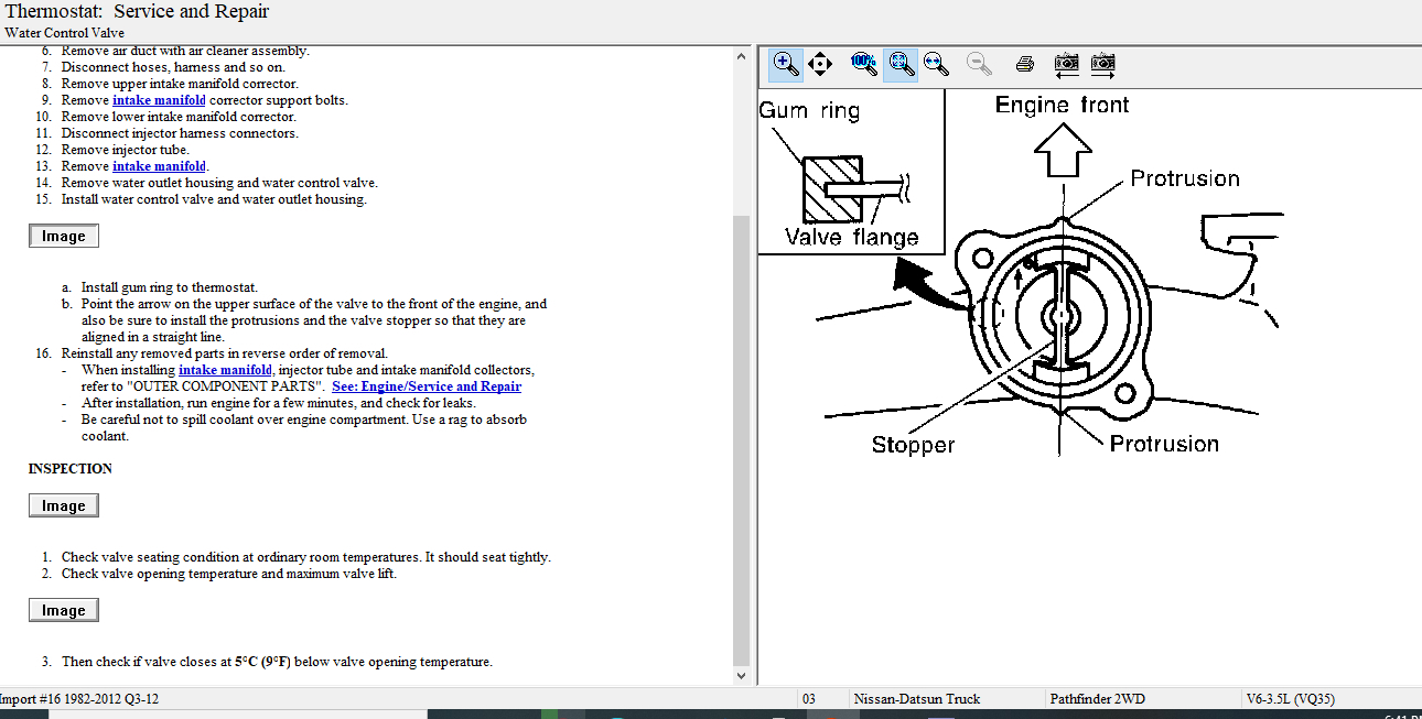

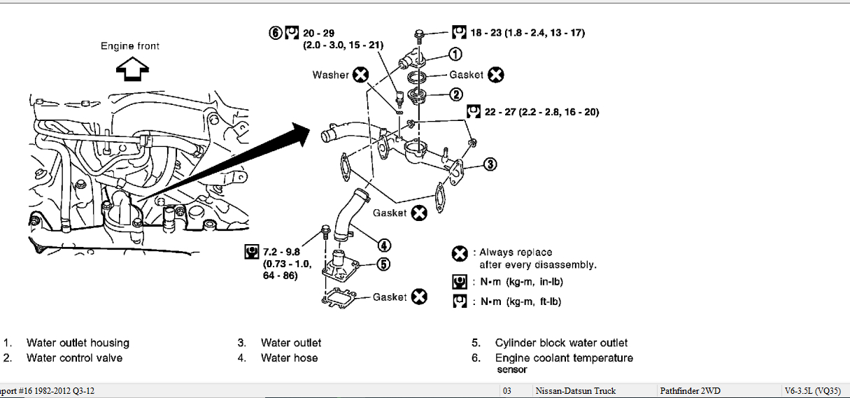

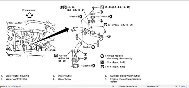

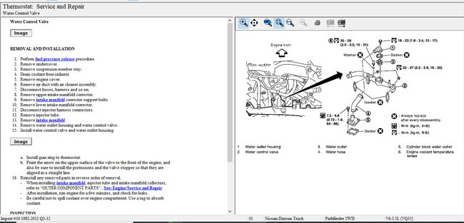

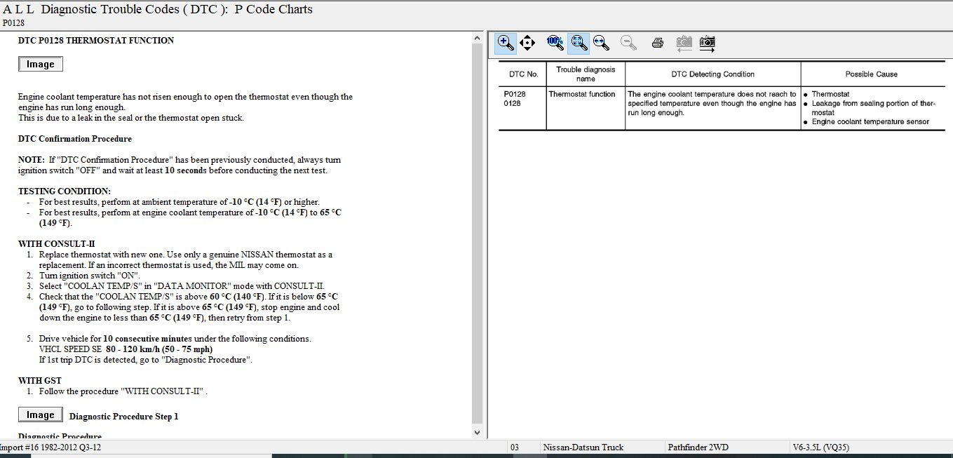

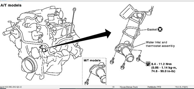

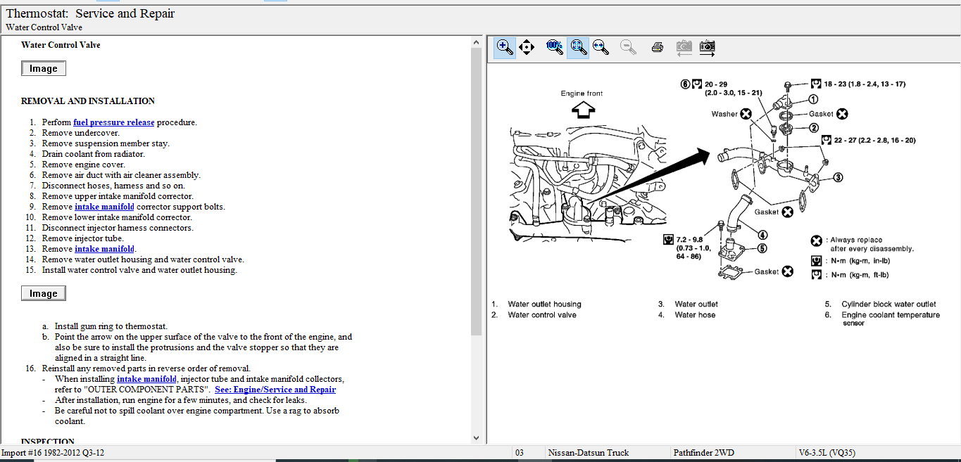

My car has a p0128 code, so I changed the front thermostat. I was told that I would also need to change the thermostat located in the outlet valve because it may put pressure on the outlet valve thermostat and make it run hot. Do I need to change the outlet valve thermostat as well?
