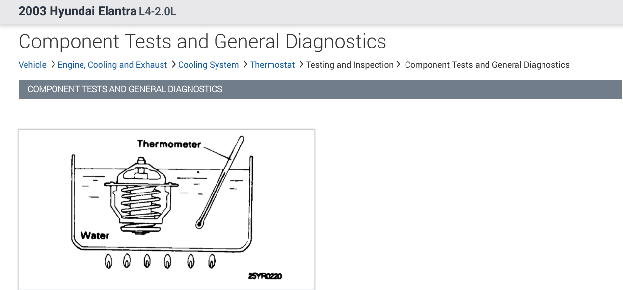

It’s full of coolant so it’s not that. Is it the thermostat and if so how easy is it to replace?
Jan 11, 2020 at 7:38 AM
SCGRANTURISMO
  • 4,897 POSTS

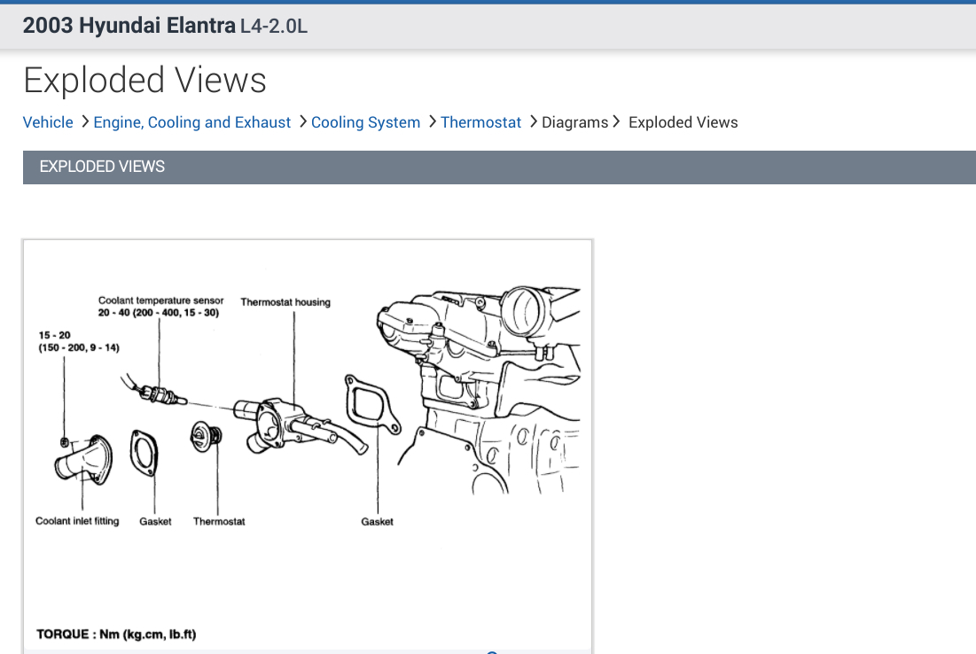

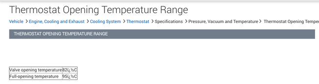

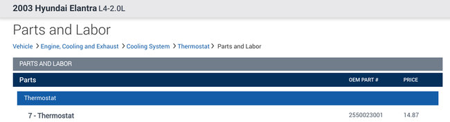

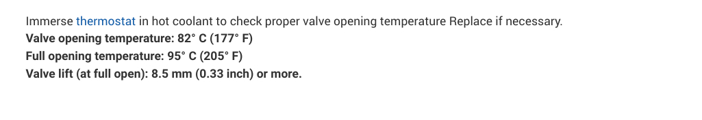

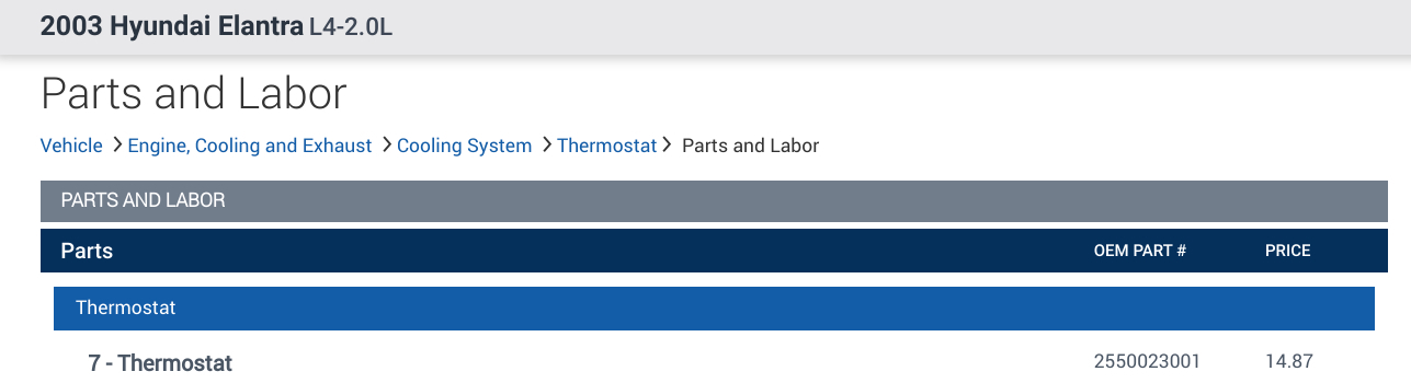

Yes, it could be the thermostat, or it could be a few other things as well, but I would recommend starting with the thermostat. Down below is a link to a general diagram on how to replace a thermostat:
In the diagrams down below I have included the instructions for the removal and installation of the thermostat on your vehicle, as well as the location, instructions for testing, and the Original Equipment Manufacturer[OEM] part number for reference as well. Please go through these guides and report back with how everything turns out.
Thanks,
Alex
