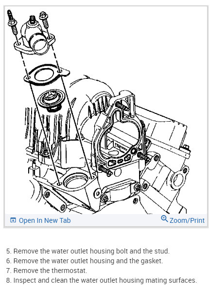

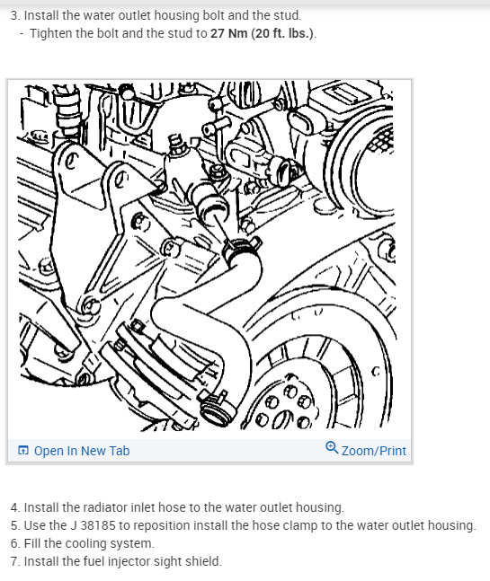

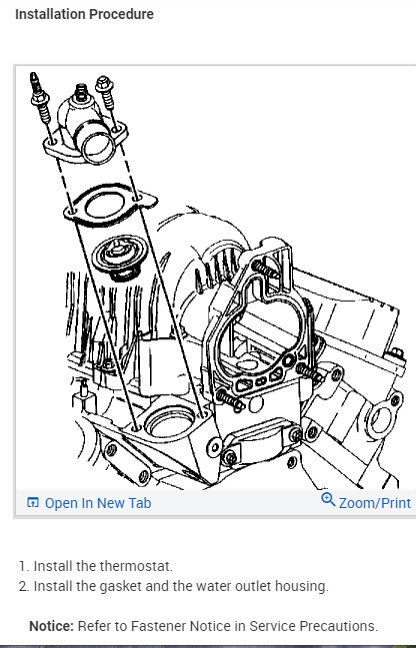

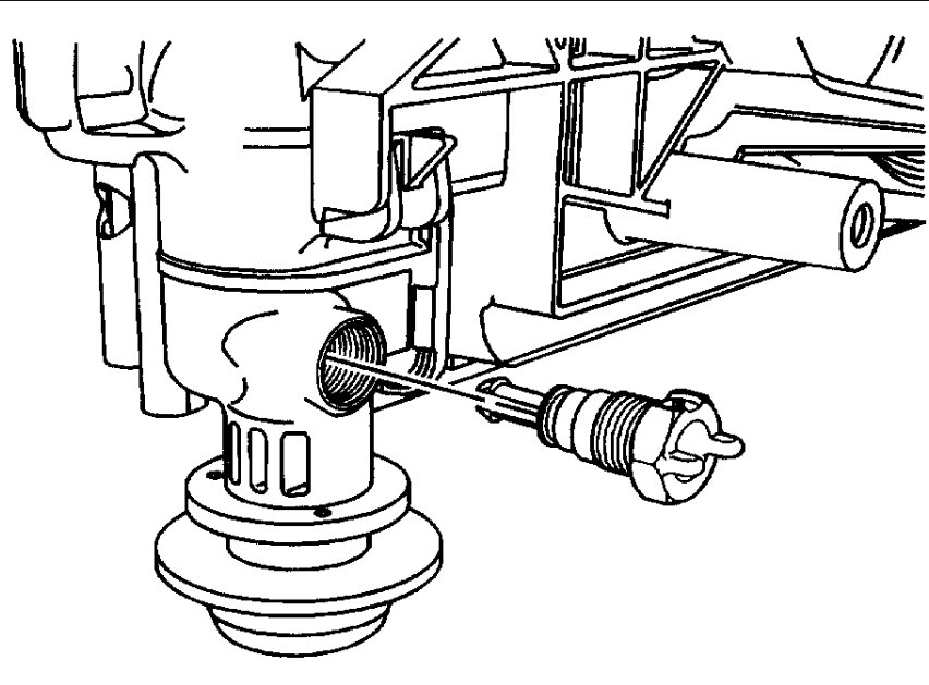

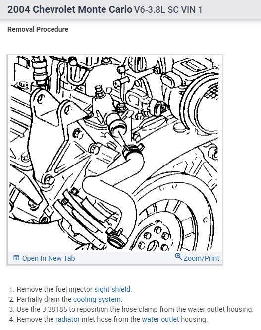

I need to replace my thermostat in my car. I don't know where the thermostat housing is. I see many different sites say that I need to drain the coolant but I don't know how to do that either. I don't know hardly anything about cars and I'm a visual learner so I need to know what's what in order to do anything. Can anyone help?
