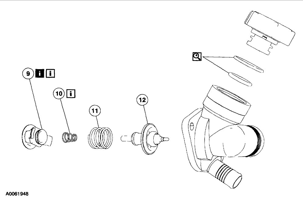

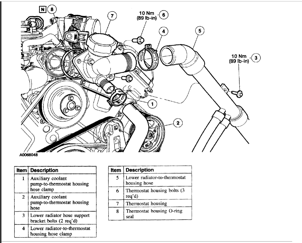

Yes it is best to disconnect the battery and there should not be any reprogramming necessary.
Here are a couple of guides to help you get the job done:
https://www.2carpros.com/articles/how-to-replace-a-car-battery
and
Diagrams (Below) show you what its like on your car.
