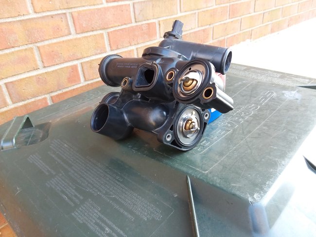

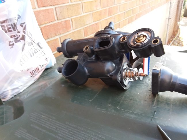

I have the housing off and apart but cannot remember which way the thermostats point. I think the top one points into the engine and the spring is in the housing. but does the bottom one from/to the hose point toward the housing or towards the hose?

Thanks. so does this look right?

If you turn them around, I suspect you will find they will not fit in the housings.

I will keep it the first way then . I am sure of the top one but the bottom will fit either way with the big bell like attachment on the end of the hose.

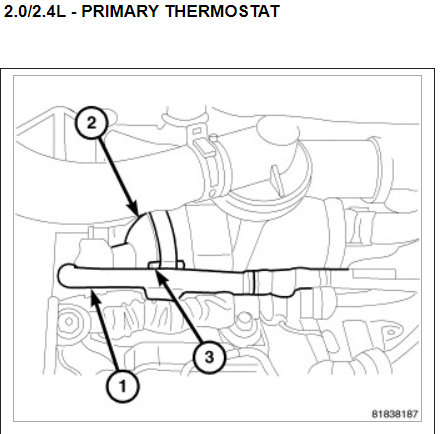

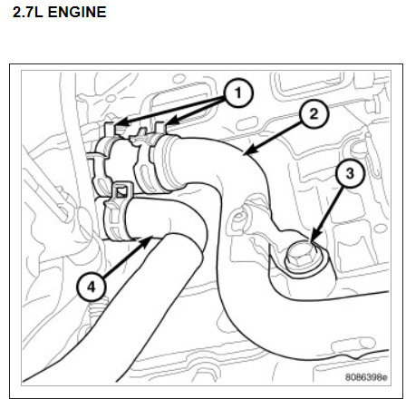

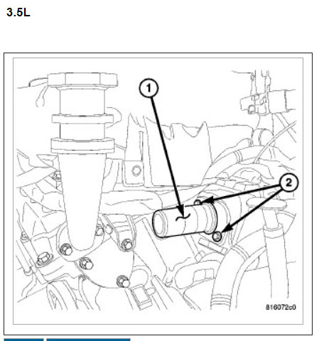

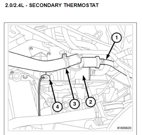

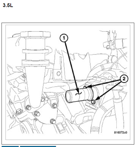

It looks they are both in backwards now can you please give me a picture of the full housing and how it goes onto the block/cylinder head?
The spring side of the thermostat should go toward the engine block/cylinder head.
This may help.
Here are some diagrams (Below) of the locations in all the engine this car came with
Dec 5, 2017 at 3:10 PM
