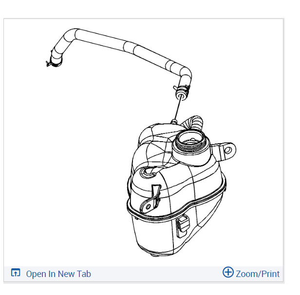

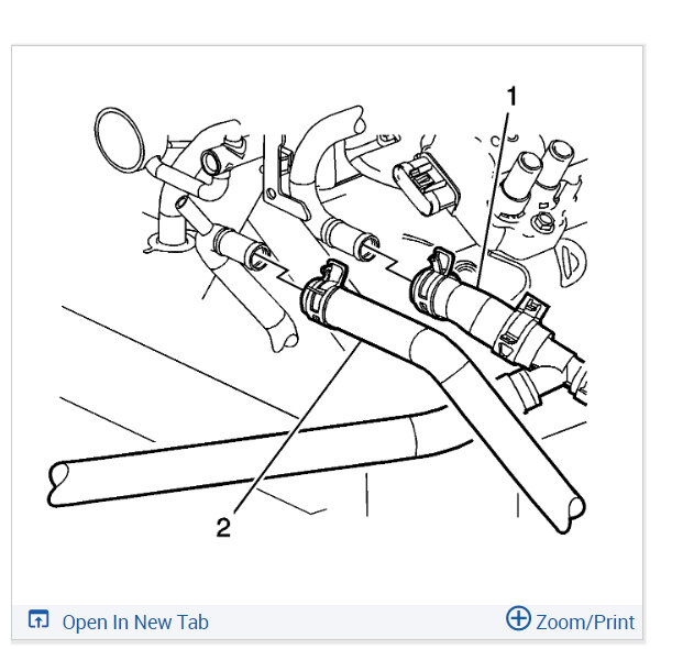

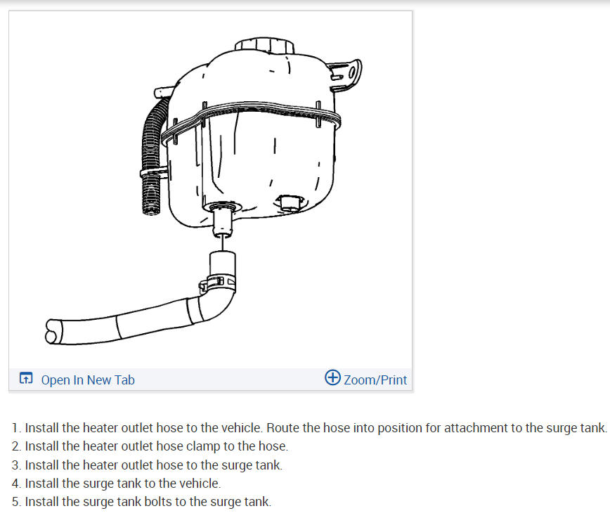

What is the metal pipe/hose that comes out to the thermostat housing, it splits off the coolant reservoir and into the heater I assume.

You are correct, here are images that can help clarify things. Check out the images (below). Please let us know what happens.
