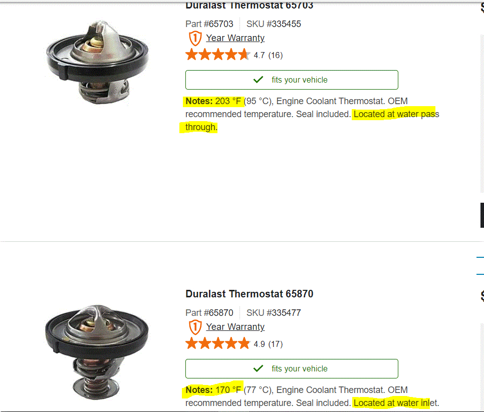

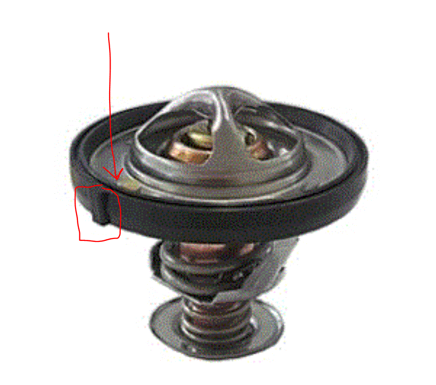

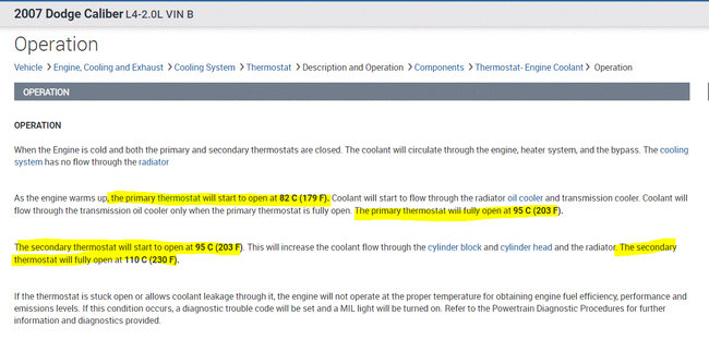

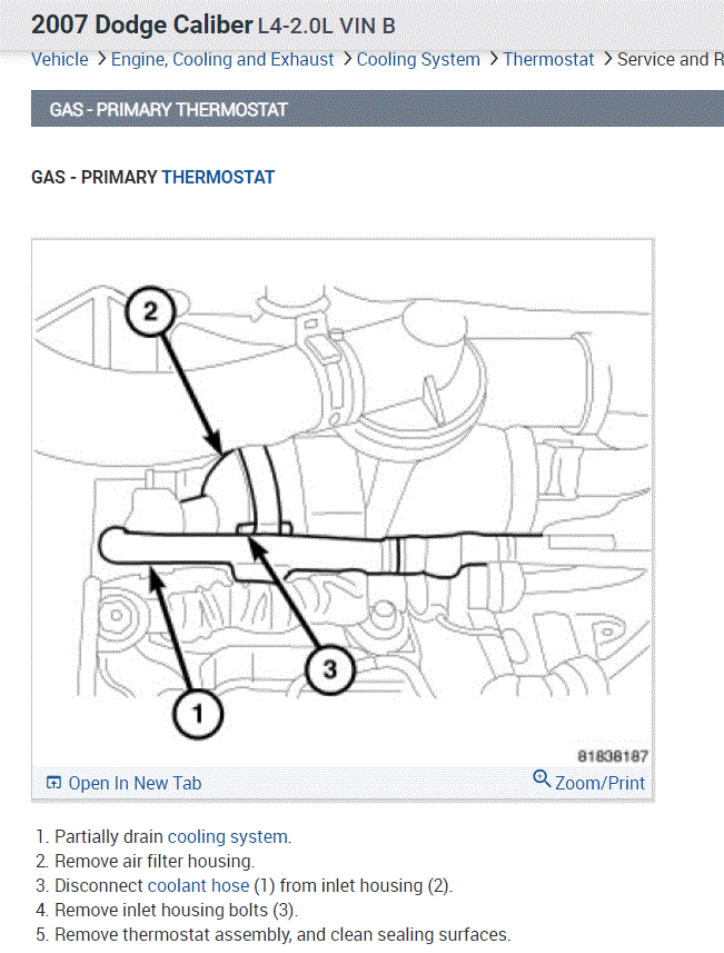

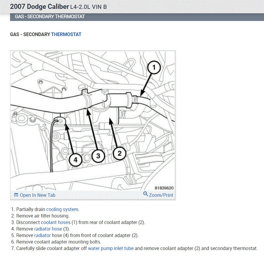

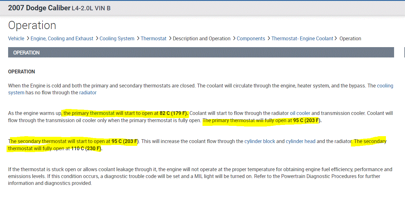

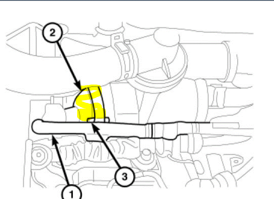

Okay, my problem is thermostats trying to order my therm. For car listed above SE model. The problem is there's some confusion about where this second thermostat is located and the part number. I'm trying to purchase a new thermostat housing which comes with only one thermostat. Now the photo display of the thermostat housing sent by 2CarPros does not match my vehicle. Mine is also plastic the one sent is metal or aluminum. Please check and verify second therm location.
