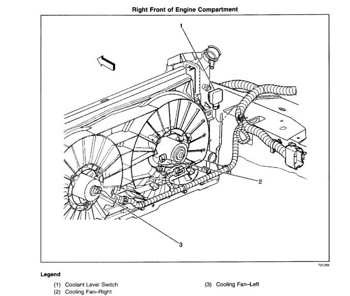

Did you check and see if the cooling fan was working?
https://www.2carpros.com/articles/replace-electric-fan-motor

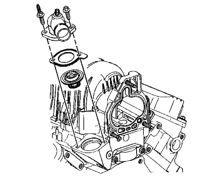

How old is the thermostat?

I would replace the thermostat, add new coolant and drive the car and see if it is fixed or if it still has issues.
