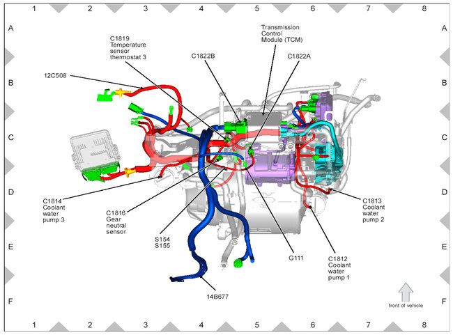

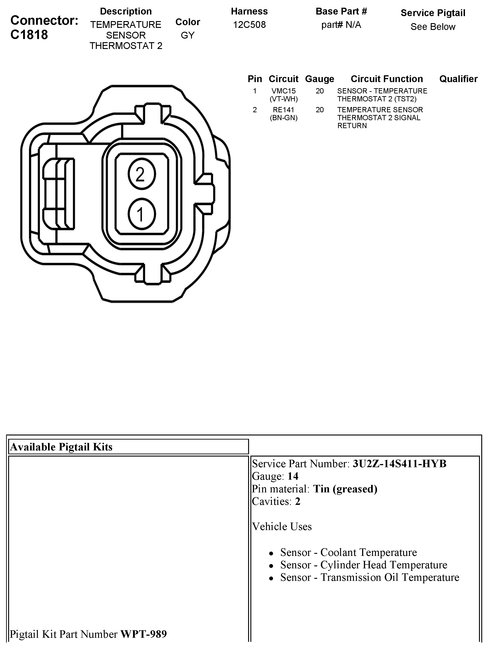

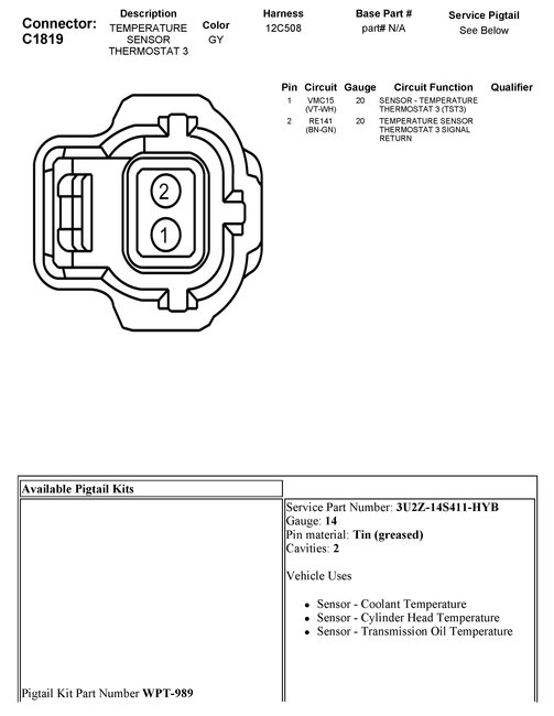

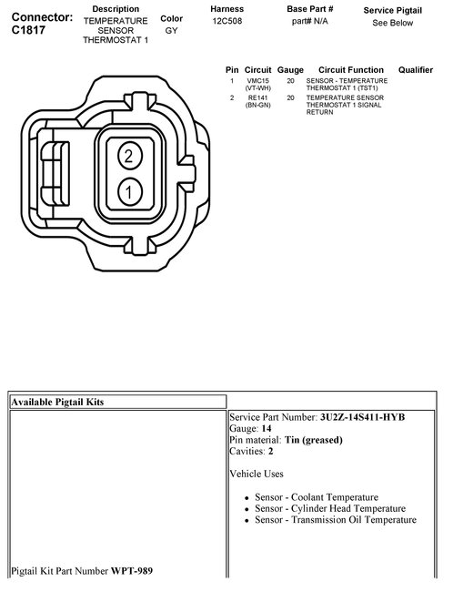

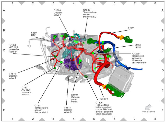

Here are some location pictures from the manual. You can also reference the wire colors from the connector pictures to identify what sensor you have when you locate them. Check out the diagrams (Below). Please let us know if you need anything else to get the problem fixed.
