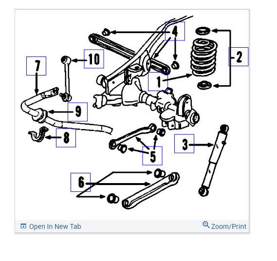

Their is a pole snapped on my rear passenger tire it snapped from a longer pole connected to both tires.
Sep 9, 2021 at 5:23 AM
CERTIFIED EXPERT
52,796 POSTS
Good morning,

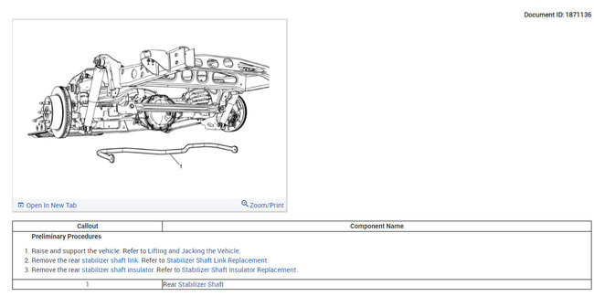

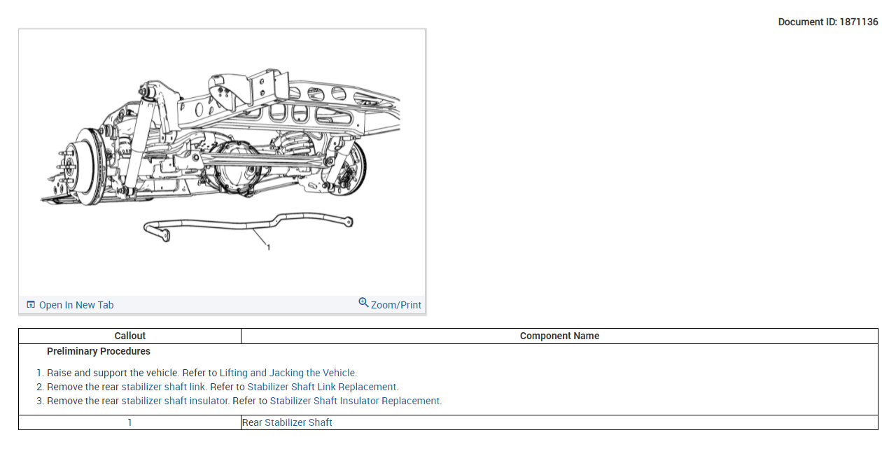

There is a stabilizer bar that runs from the tire to the tire.
I attached a picture of the rear suspension for you and the procedure for replacing the bar.
Make sure you replace the bushings on either side as well. You can get the parts at any parts store.
