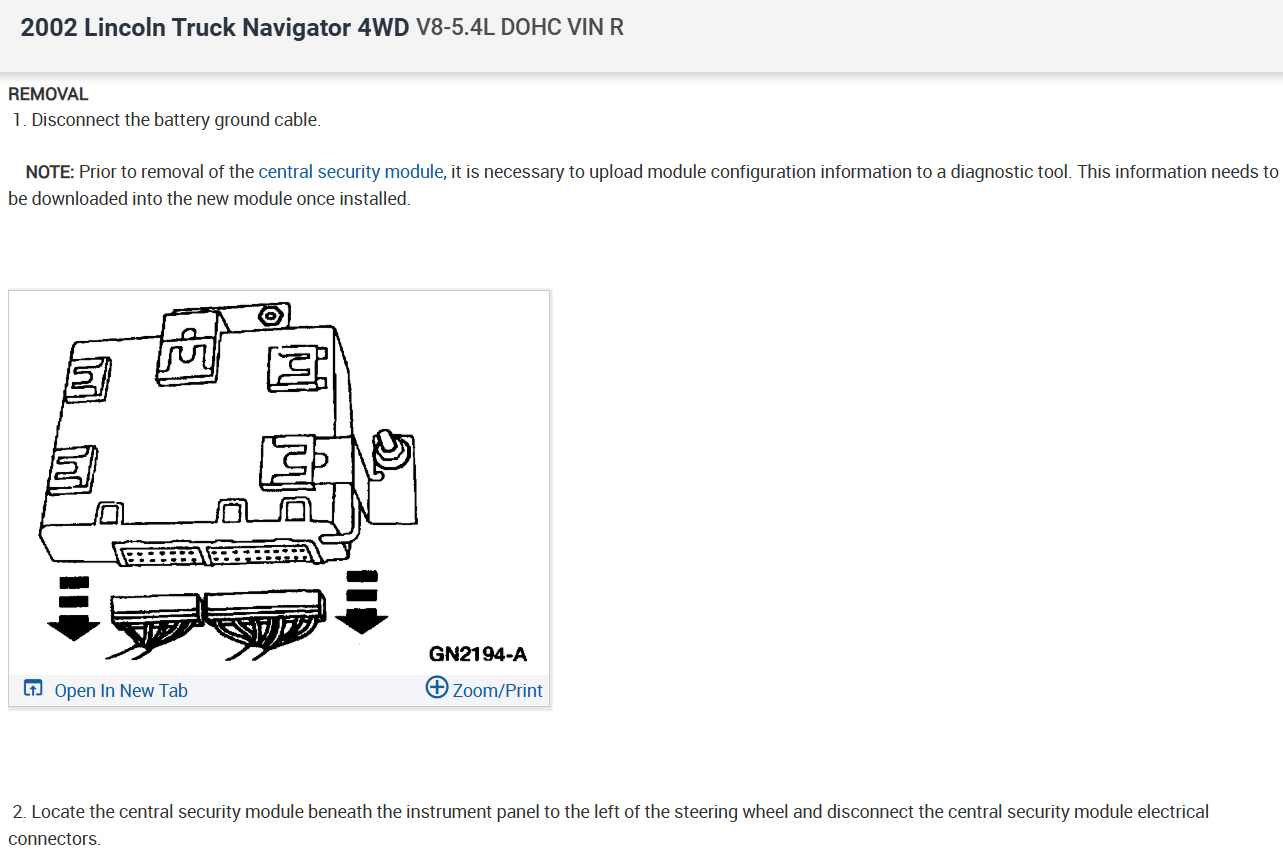

I have replaced the PCM relay, The battery and got a new key programmed. The car has stalled while driving, resetting the battery only works sometimes. I haven't gotten any codes except for a few for ABS. What could be my problem?
