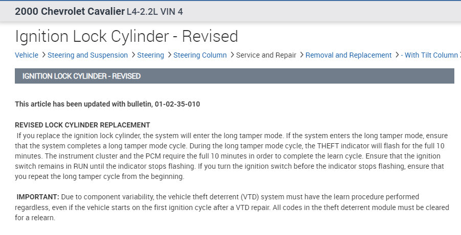

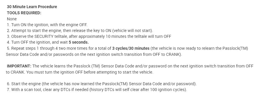

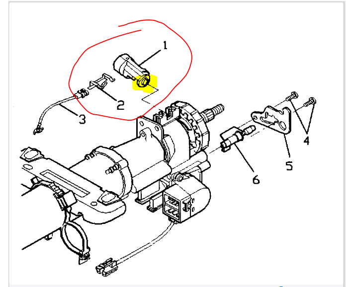

The ignition got drilled out, replaced with a new ignition. Followed steps to relearn key and reset theft system. Everything seemed to work just fine, no theft light. Wait a few seconds and the theft light comes on, accompanied by a buzzer and the daytime light indicator flashing. I’ve tried almost everything. Please help.
