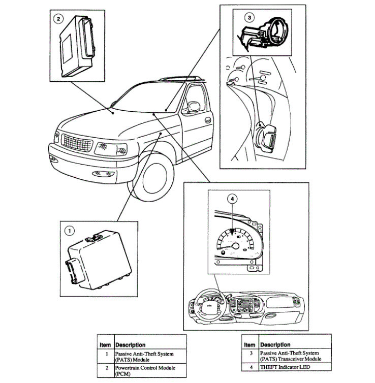

lost the key had a new one made and programed. it didn't program so replaced elecring on the ignition. anti theft still flashing.
Nov 29, 2020 at 3:18 AM
Here are the directions for reprogramming the new key without a scan tool. Take a look through it and let me know if it is what you have already done. Also, I'm not sure what you mean by elecring. I attached a pic below. Do you see the part that was replaced?

The theft light does not flash for 15 minutes it flashes for about a minute and a half. oh, it was the transponder that i replaced with the ignition relays and fuses are all good.
Dec 2, 2020 at 2:09 PM
Take a look at the attached list of possible causes.

Because there are several different possible issues, we really need to scan the computer for codes. The new transceiver could be bad, not recognized, or simply not communicating with the PCM.
