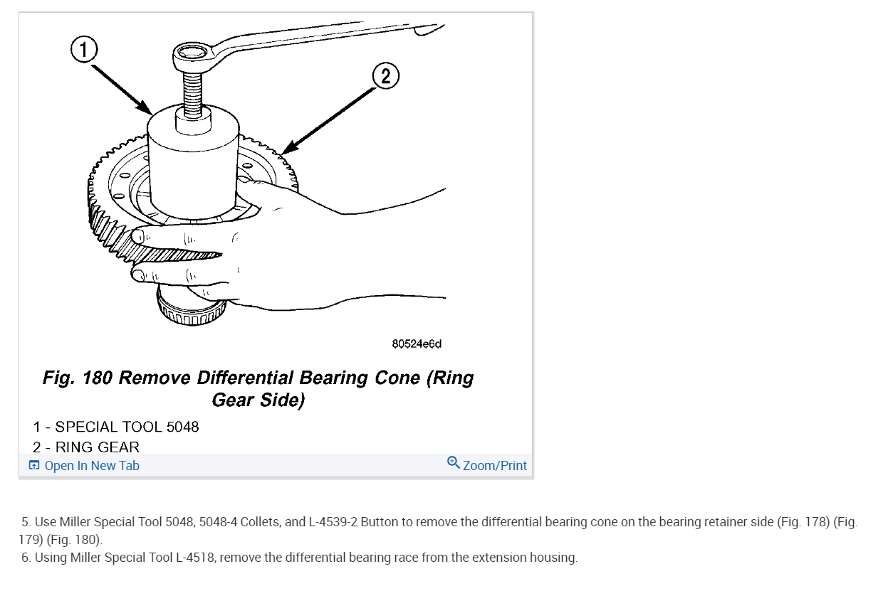

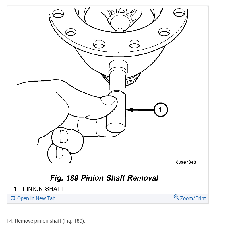

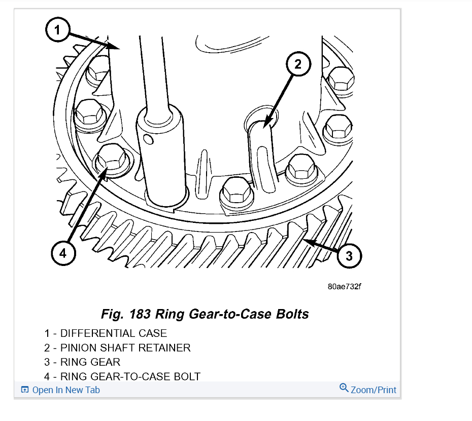

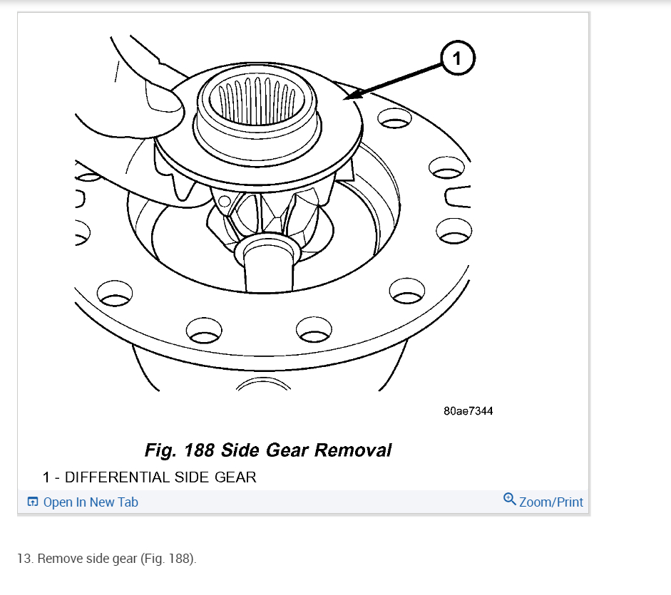

This is not related to the problem. The side gear was broken causing the power not to be transferred from ring gear to side gear and finally to drive shaft. Can I replace the ring gear (drive train) without dropping the transmission? If yes, send me the procedures.
Thanks
Jan 18, 2023 at 7:41 PM

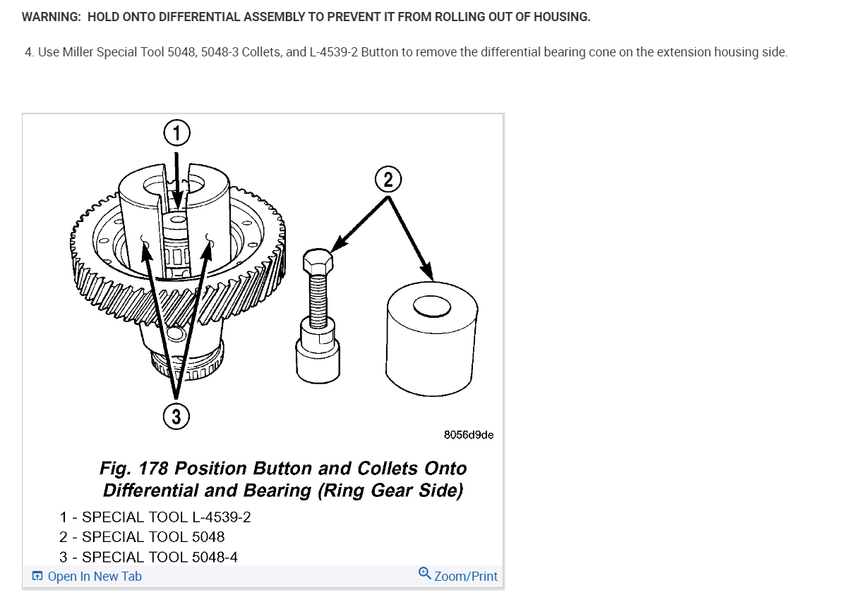

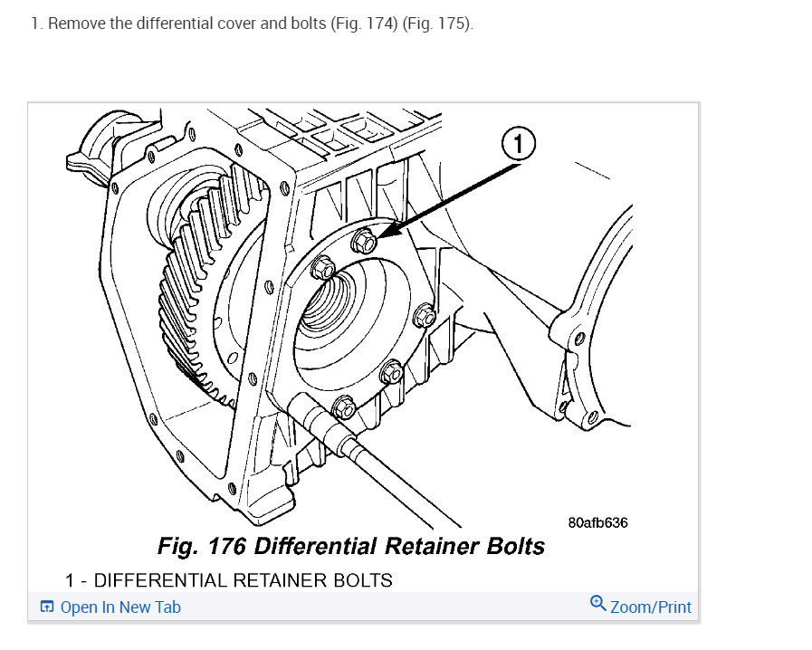

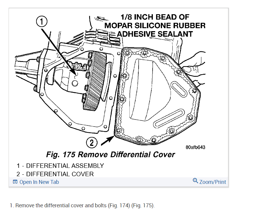

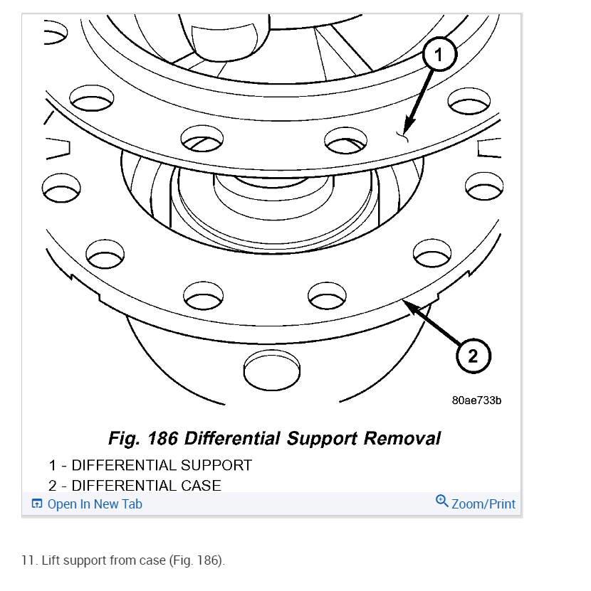

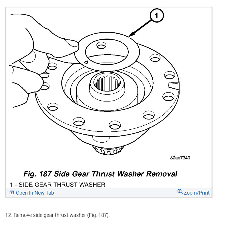

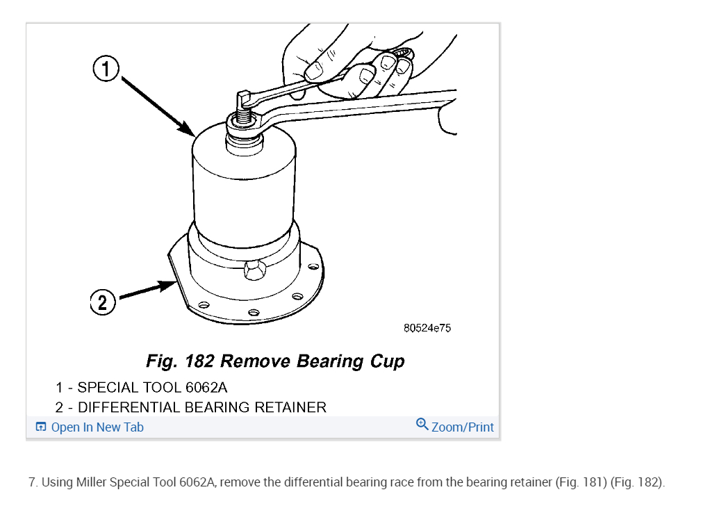

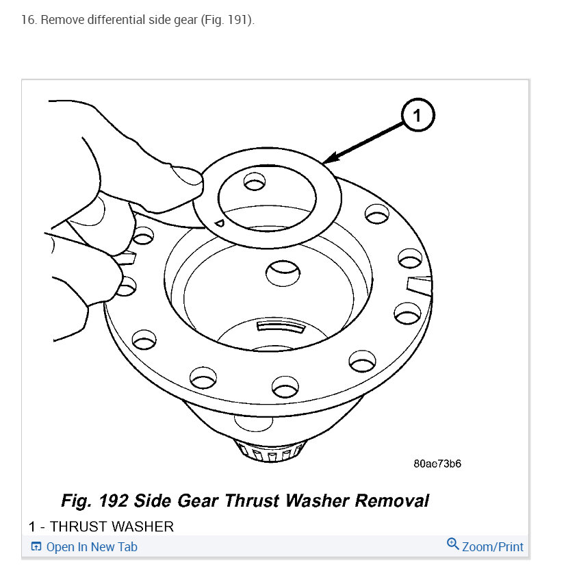

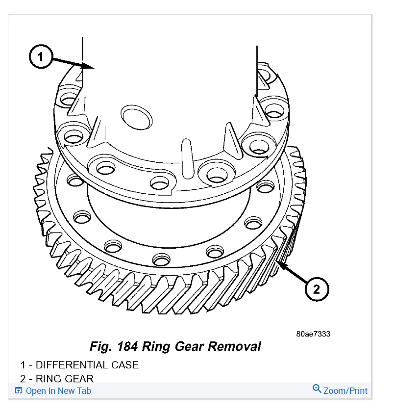

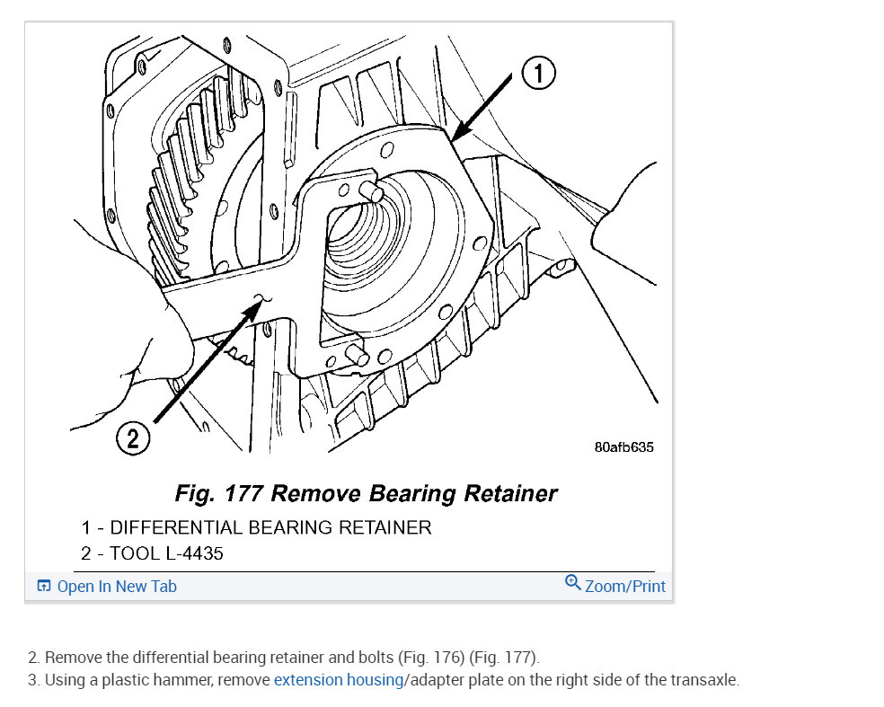

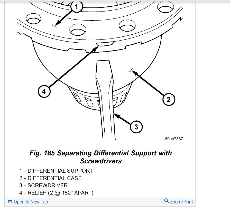

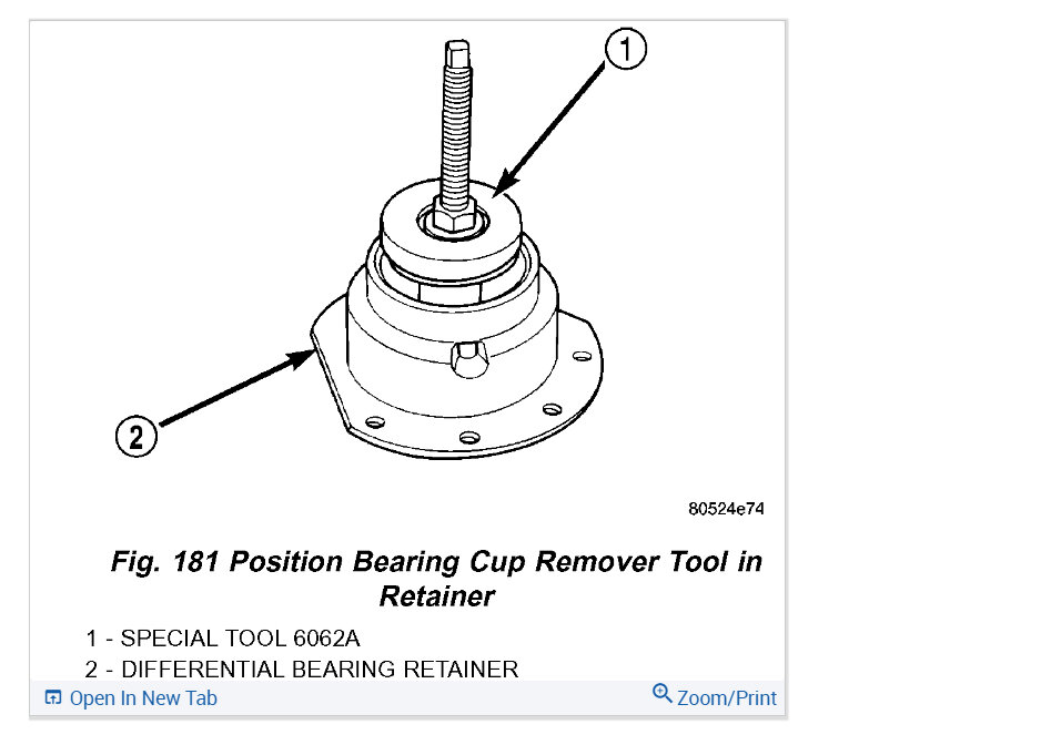

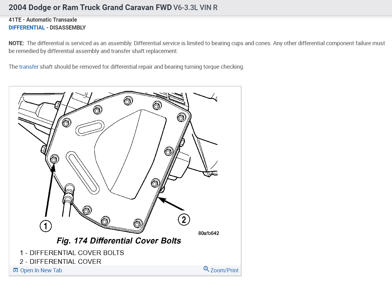

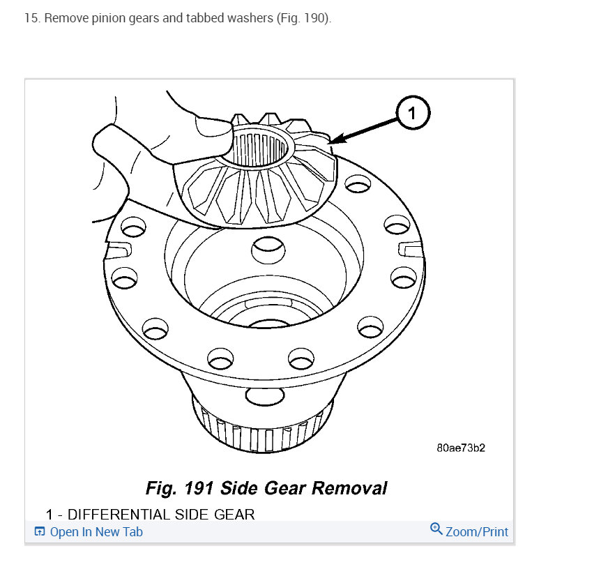

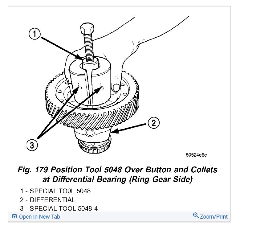

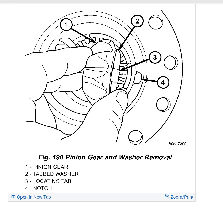

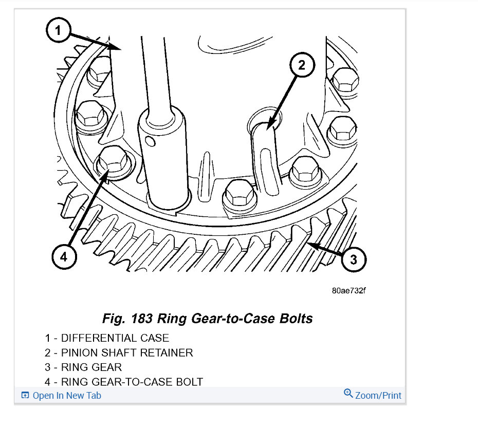

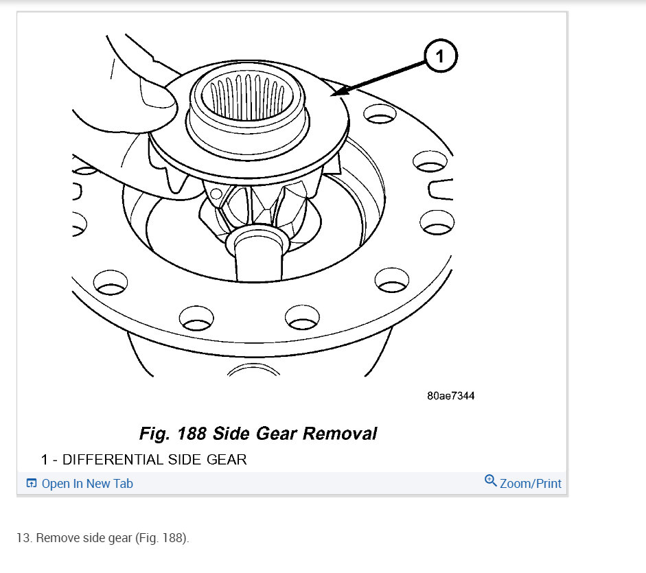

Yep, it looks like you can replace the ring gear without removing the transmission, check out the images below. Please let us know if you need anything else to get the problem fixed.
