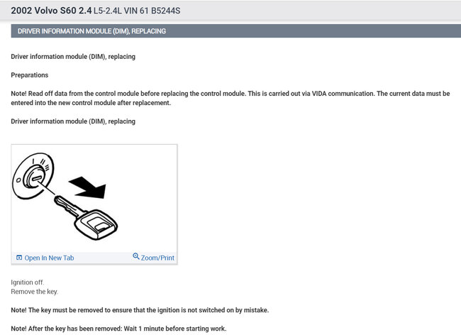

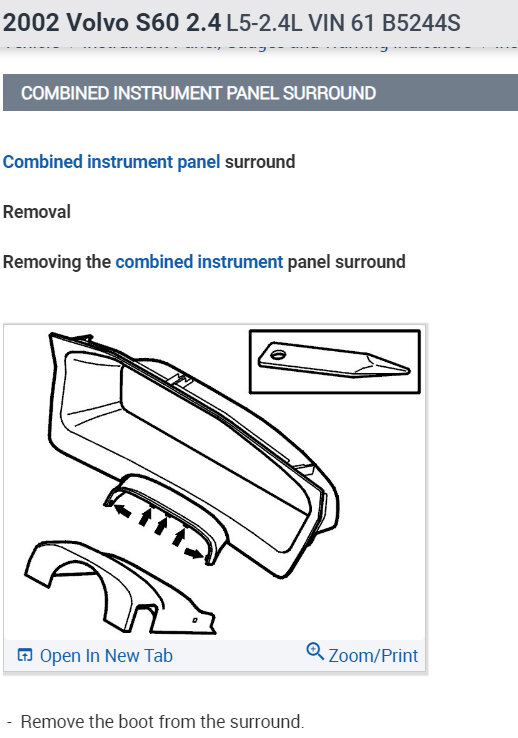

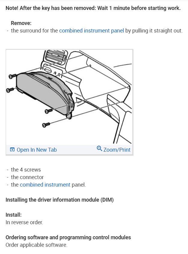

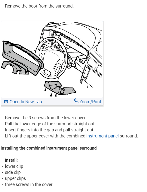

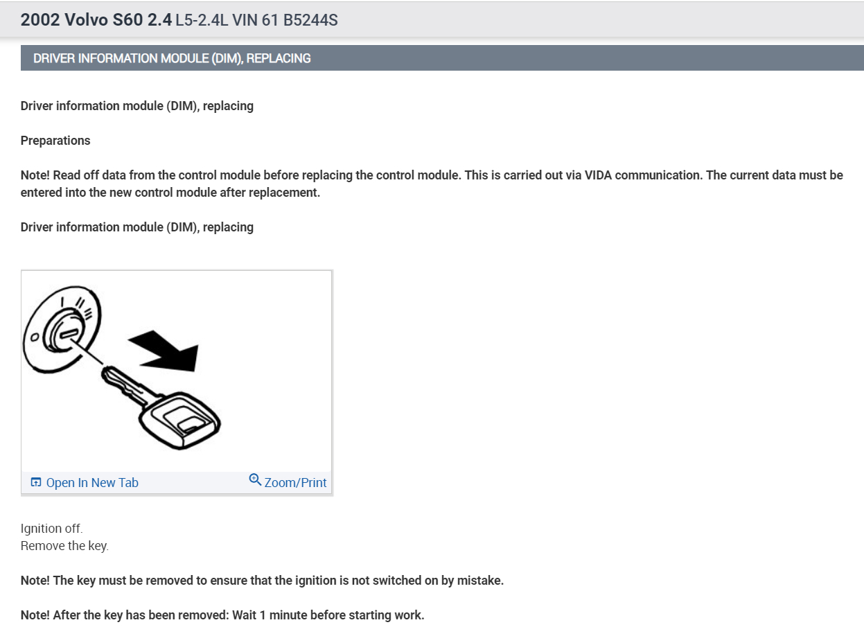

So, I would start by checking the fuses this guide can help:
If the fuses are good chances are the IPC (DIM) has gone bad, here is how to change it out in case you need it. Check out the images (below). Let us know what happens and please upload pictures or videos of the problem so we can see what's going on.
