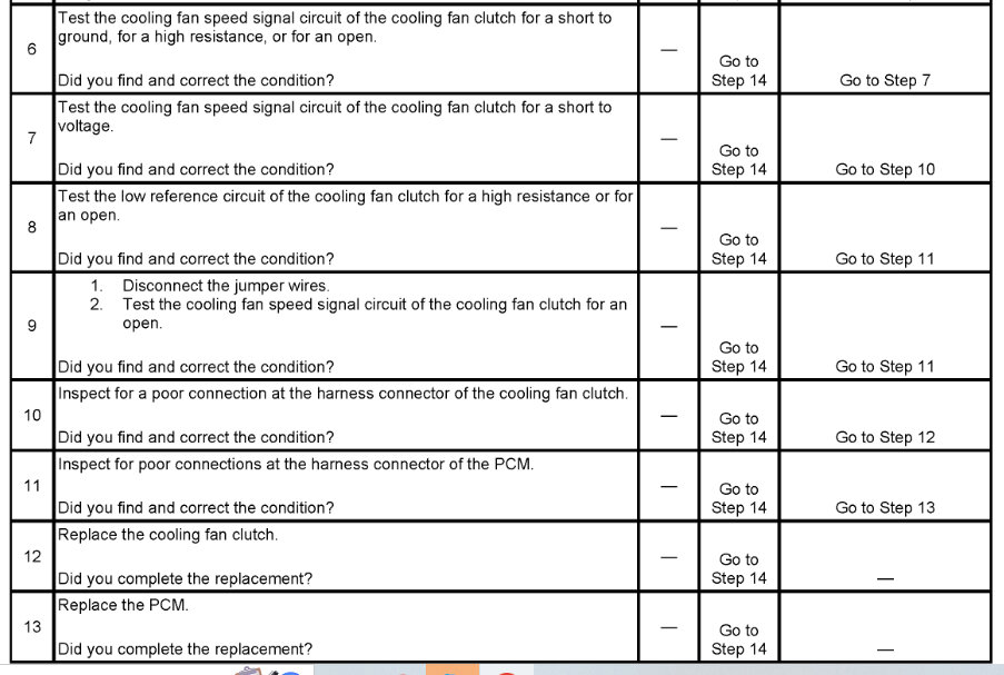

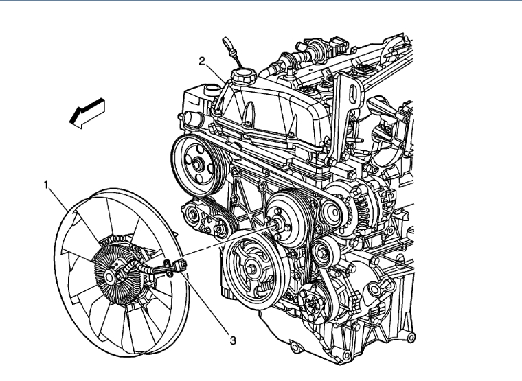

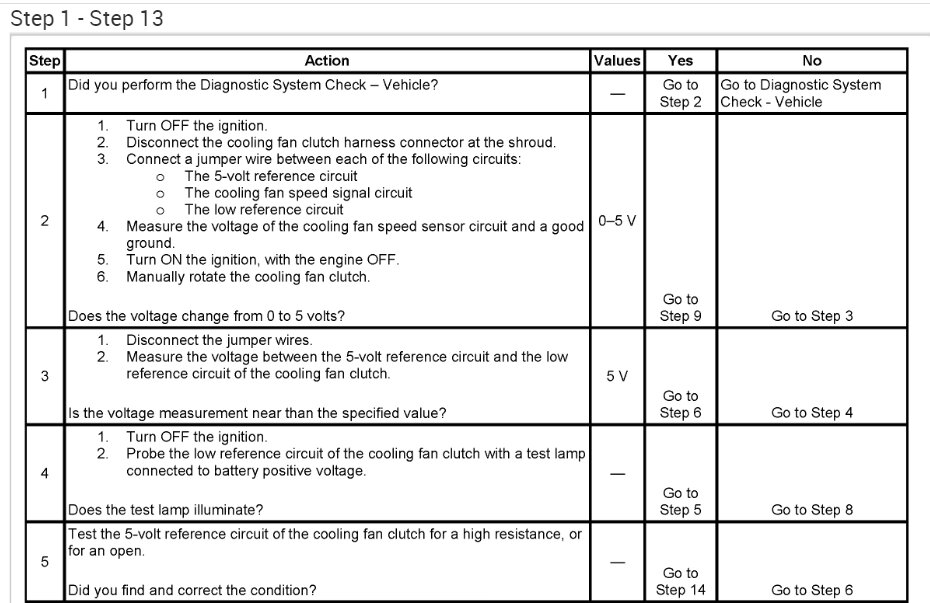

The fan on the motor revs high and makes a pound revving sound sometimes when the vehicle runs for a while, but it seems to only do it when it's hot outside. I get the error code from the check engine light P0 something and it says it could be fan speed sensor.
