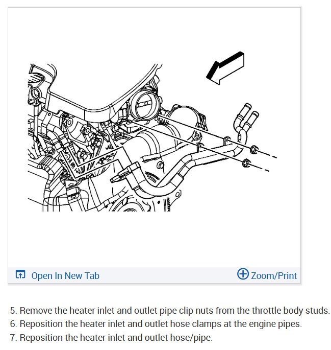

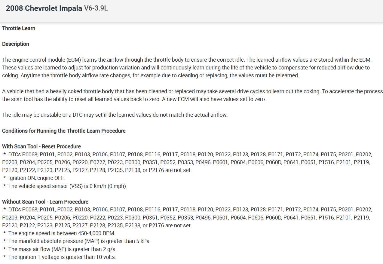

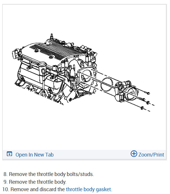

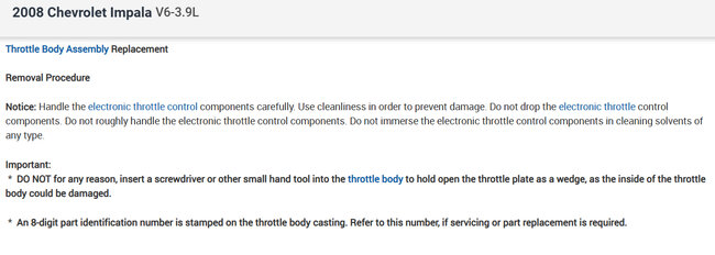

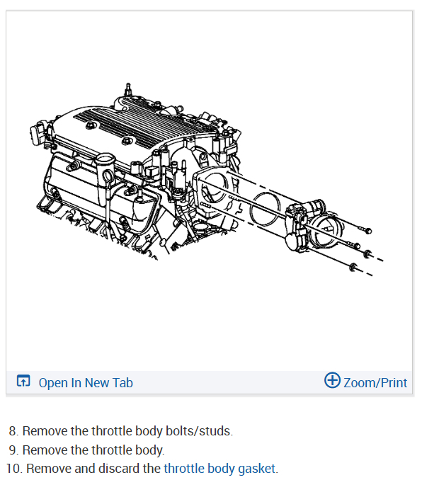

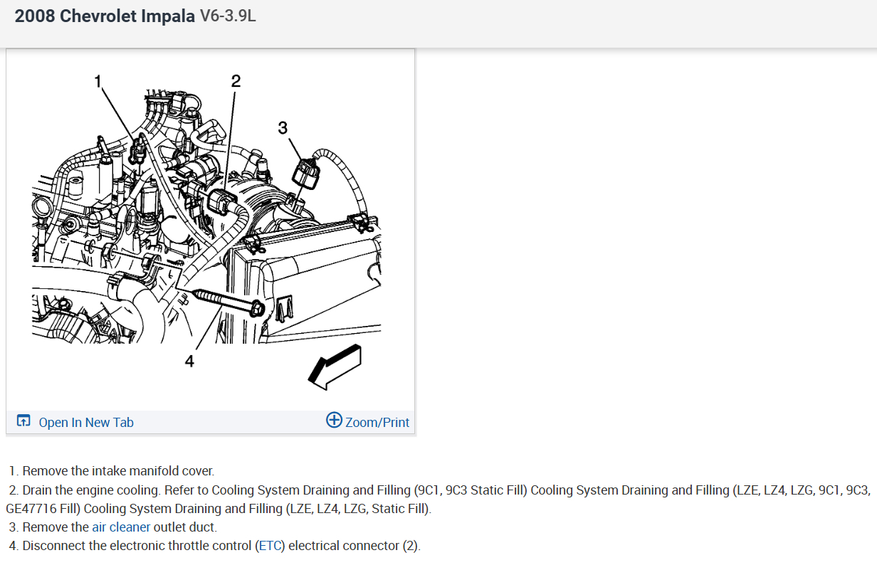

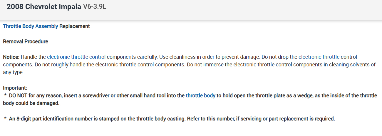

Please give me the code numbers so I can help you. I can tell you that the limp mode can be caused by a bad throttle body or if it needs to be cleaned which you can try first.
Here are two guides to help us while you get me the code numbers:
https://www.2carpros.com/articles/reduced-power-limp-mode
and
Here is how to service the throttle body on your car. Check out the images (below). Please let us know what happens.
Dec 7, 2024 at 11:23 AM (Merged)

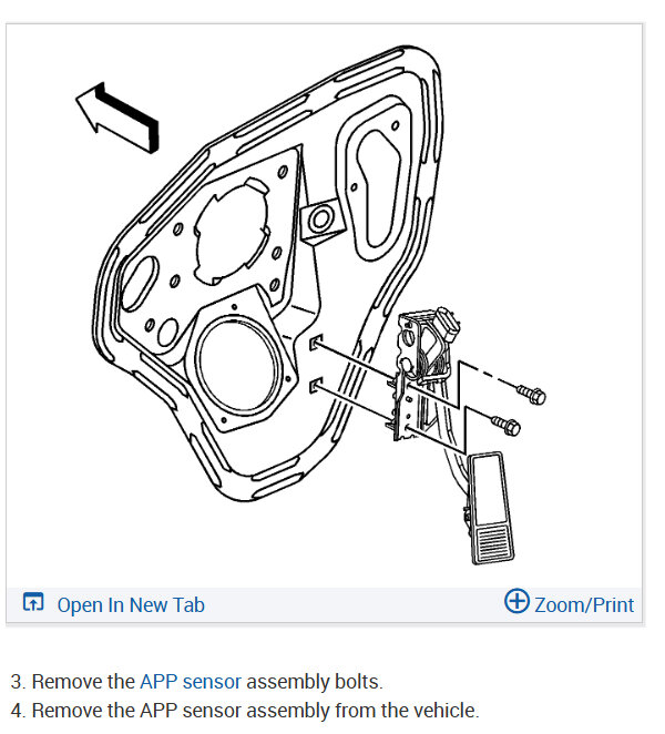

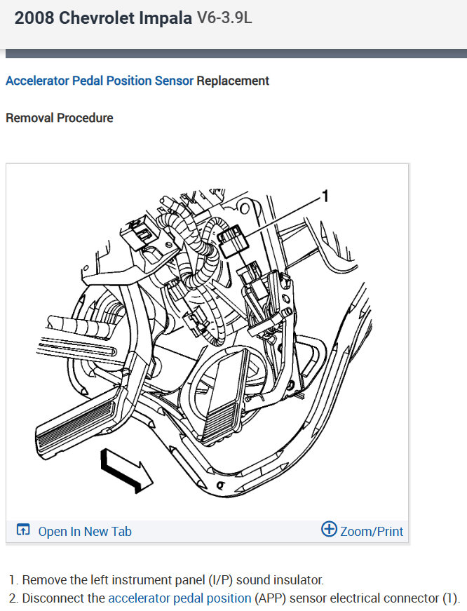

So the first code will cause the problem and the third code, let's try replacing the accelerator pedal sensor and then clear the codes.
P2122 - Throttle/Pedal Position Sensor/Switch 'D' Circuit Low Input
P0452 - Evaporative Emission System Pressure Sensor/Switch Low Input
P0641 - Sensor Reference Voltage 'A' Circuit/Open
Here is how to replace the part in question. Check out the images (below). Please let us know what happens.

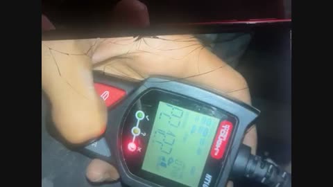

No only have those and for some reason my car die extremely fast it was at 12v checked the alternator and it went to like 14v but I started a timer to let the computer shut down and literally 16:21. Minutes the car was dead had to jump it.

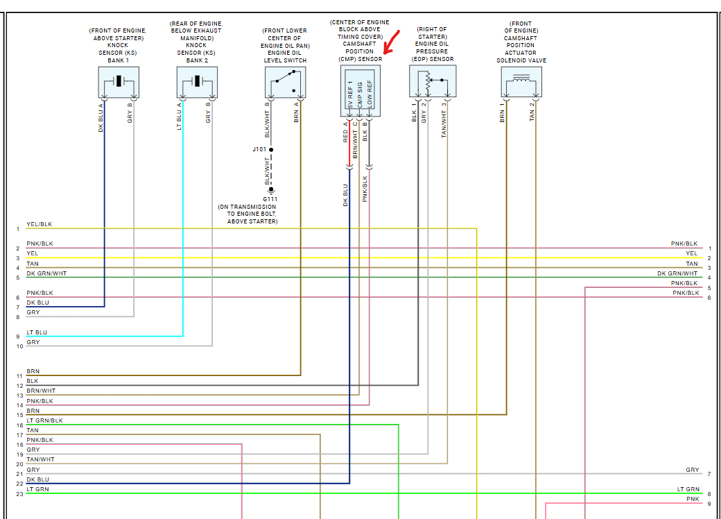

Here is the camshaft sensor wiring.
Dec 7, 2024 at 12:17 PM

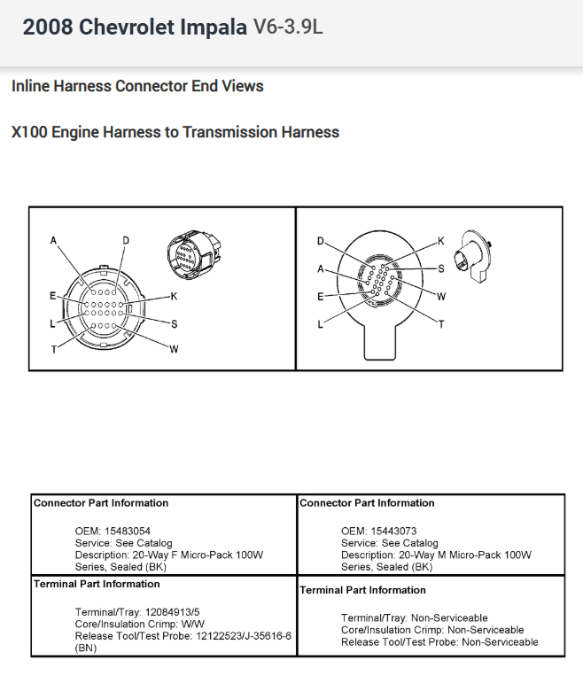

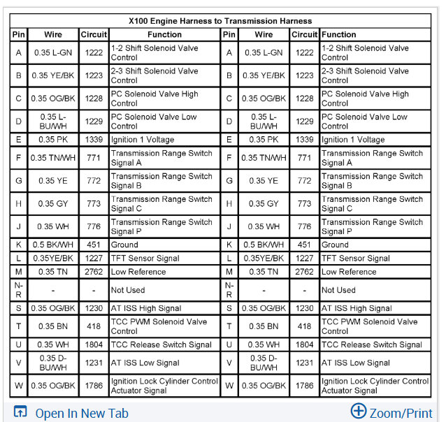

I know I have that. thanks, though I cannot find what wire color the x100 connector is, any help on that?
Dec 7, 2024 at 12:19 PM
Sure, can I ask what the connector plugs into? here is the x100 connector info. Check out the images (below). Please let us know what happens.
Dec 7, 2024 at 12:50 PM

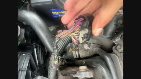

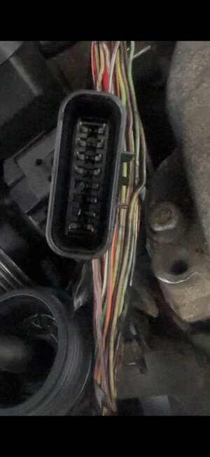

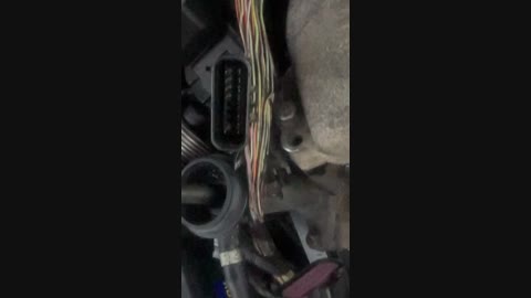

Would you happen to know what this plug is called? It’s a 16-pin right near the power steering pump.
Dec 8, 2024 at 8:09 PM
It must be a main engine wiring harness connector; can you tell me the colors of the wires so I can look them up? Thanks for the video, it helped.
Dec 9, 2024 at 8:46 AM

It’s like 16 colors lol I am going to try to check in a few. it’s raining. I see green, purple, black, white, red, probably got a whole rainbow there.
Dec 9, 2024 at 8:57 AM

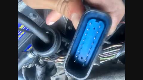

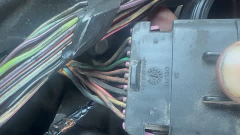

Here’s the back of the connector if this helps.
Dec 9, 2024 at 2:25 PM
Can you take a picture of the wires in the connector?
Dec 10, 2024 at 10:03 AM

The connector does not matter just the wiring colors which I can see, please take still shots that don't move around.
Dec 11, 2024 at 9:54 AM
