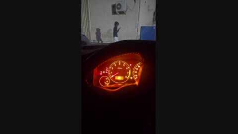

Well my car just stopped working basically stalled as I spammed the brakes repeatedly and now it just cranks and even if I manage to turn it on the rpm just jumps up and down the 1 range and turns off like it ran out of fuel but the injectors work everything is working took it to a workshop they said its the security module but the immobiliser light turns off when key is inserted as I bought a key smith to duplicate a key and program it and the key smith said it was not the security system it's something else these mechanics are trying to scam what could it be?

Man, that is a good one, it looks like the battery might be shorting out internally, if the battery is old I would change that out first, next we need to run the codes to see which codes are stored with a CAN scan, please go over this video to see what I am talking about.
https://youtu.be/u-4syLc-ifQ
Let us know how it goes.
