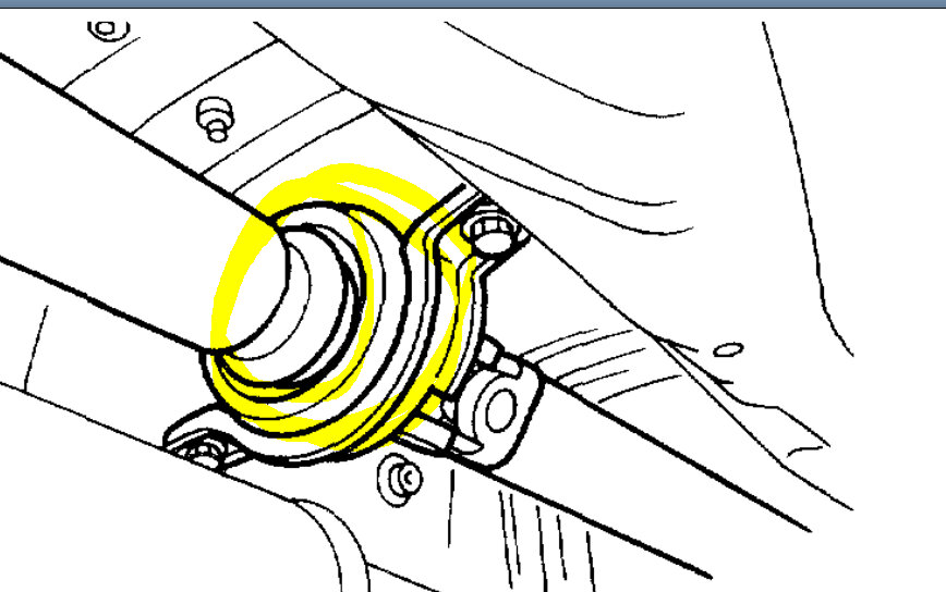

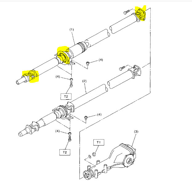

Also, the idea that it only does it in 4th gear is odd. It could even be a failing universal joint or center bearing. In pic 1 below, I highlighted the center bearing and both universal joints. You can inspect those for evidence of wear. Also, pic 2 shows the carrier bearing. That can certainly cause what you described.
The bearing in the carrier is mounted in rubber, so check to see if anything is worn or loose.
Let me know what you find.
