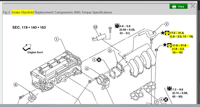

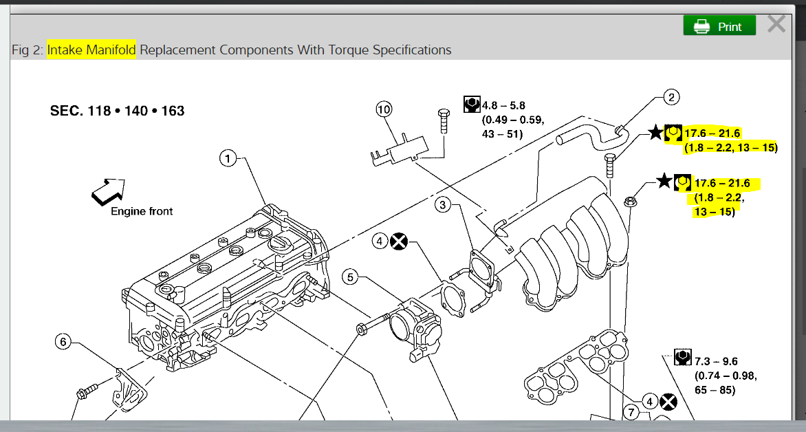

This sounds to me like you have a intake leak problem. You might want to check the intake manifold bolts torque and the gasket again. In the diagrams down below I have included the torque values for the intake manifold bolts. Please follow these torque values and do not over tighten. If you over tighten, you can smash the gasket out, causing an intake leak.
Thanks,
Alex
2CarPros
Apr 21, 2019 at 8:08 PM

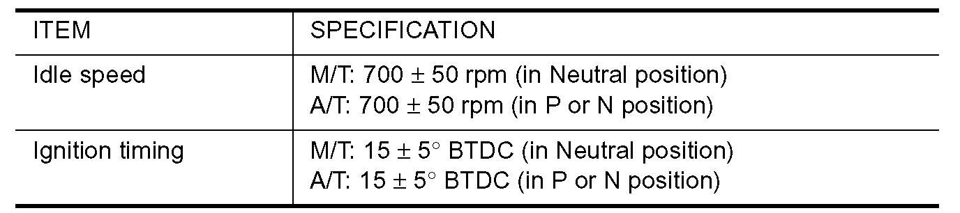

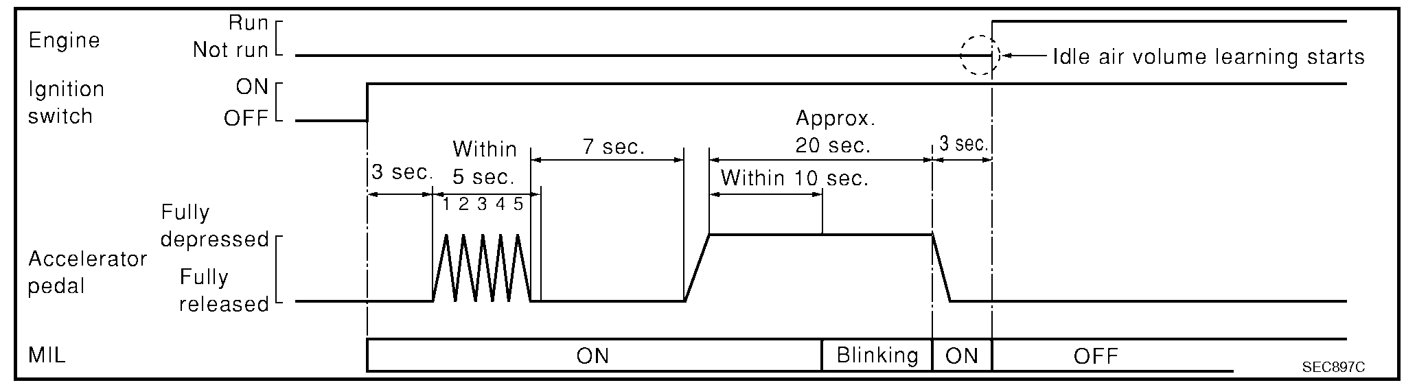

Since you replaced the throttle body, the vehicle has to relearn the idle air volume needed for a smooth idle. I will provide directions for this. There are two ways to do it. One requires a upper level scan tool and the other can be done without. I will provide the directions for without the scan tool. The two attached pictures correlate with the directions.

5. Turn ignition switch OFF and wait at least 10 seconds.
6. Confirm that accelerator pedal is fully released, turn ignition switch ON and wait 3 seconds.
7. Repeat the following procedure quickly five times within 5 seconds.
a. Fully depress the accelerator pedal.
b. Fully release the accelerator pedal.
8. Wait 7 seconds, fully depress the accelerator pedal and keep it for approx. 20 seconds until the MIL stops blinking and turned ON.
9. Fully release the accelerator pedal within 3 seconds after the MIL turned ON.
10. Start engine and let it idle.

12. Rev up the engine two or three times and make sure that idle speed and ignition timing are within the specifications.
13. If idle speed and ignition timing are not within the specification, Idle Air Volume Learning will not be carried out successfully. In this case, find the cause of the incident by referring to the Diagnostic Procedure below.
