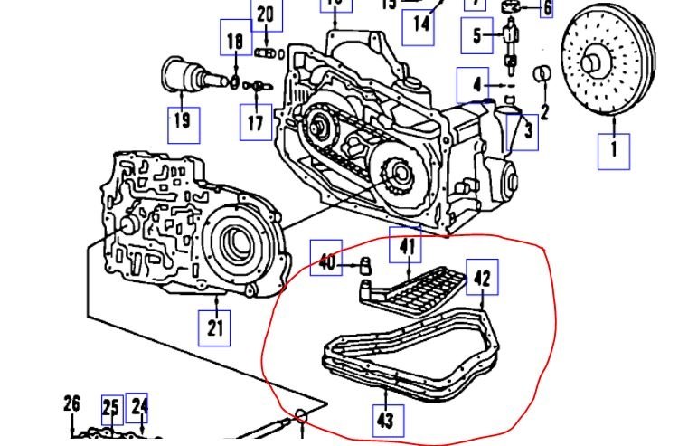

This sounds like the filter is clogged in the transmission.
https://www.2carpros.com/articles/automatic-transmission-problems
I would drop the pan and change the fluid and filter. This is the most likely cause.
1. Raise and support vehicle, then position drain pan under oil pan.
2. Remove front and side oil pan attaching bolts, then loosen rear pan attaching bolts.
3. Carefully pry oil pan loose from transaxle case and allow fluid to drain.
4. Remove remaining attaching bolt, oil pan and gasket. Thoroughly clean pan before reinstalling.
5. Remove and discard screen and O-ring seal.
6. Install replacement screen and O-ring seal, locating screen against dipstick stop.
7. Install gasket on oil pan, then apply Loctite 242 or equivalent to oil pan bolts to prevent leakage.
8. Torque oil pan bolts to 12-13 ft. lbs.
9. Lower vehicle and add approximately 6 quarts. of fluid.
10. With selector in park, parking brake applied and engine at idle speed and operating temperature, check fluid level and add fluid as necessary. Do not race engine or move shift lever through ranges.
