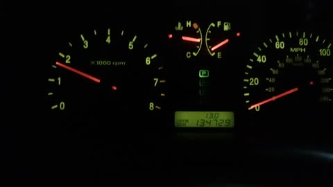

Hello, my car has just come out of a year-long exhausted repair, we are talking about big heads, pistons, new OEM sensors, timing belt, tension-er, oil, spark plugs, OEM coils, MAF new, Etc.
The moment I start the car it goes up to 1500 rpm's to 1900 rpm's (parking), then if I change the gear to "D", the revolutions go down to 900 rpm's. And I can drive normal. Then I put the car back in P when parking and climb up to 1500 to 1900 rpm's.
The same happens in neutral, the revolutions go up.
Now read this: When I turn on the car and the revolutions go up I must hit (accelerate) the accelerator quickly and lower to 1000 rpm's. (The right thing).
Fault found: I could find that the throttle spring is too tight and the throttle does not return to its position, so I lubricated it with WD40 and it worked a bit.

I have included a video to illustrate, thank you.

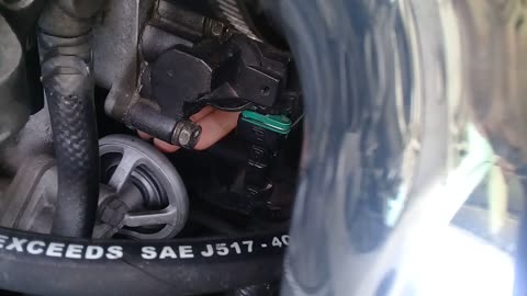

Hello, I tried with the car on by disconnecting the EGR valve and the revolutions increased even more. So again I connected them and it seems that the valve works well, I show you a video.
You can also see how the spring causes the accelerator not to return to its initial position. I tried to dismantle it to give the spring another turn, but it is very difficult and I do not know if it is correct.
Should I lubricate the cable?
All this is programming of the ECM, I SORRY, forget to mention that this car was repaired the computer because it did not send signal to the coils.

Thanks for the video it really helps. I don't think the problem is the EGR although you might want to test it anyway.
Here is a video
https://youtu.be/DqUCbbKdWf4
It like like the cable it to tight to the throttle body can you disconnect the cable to see how it idles?
