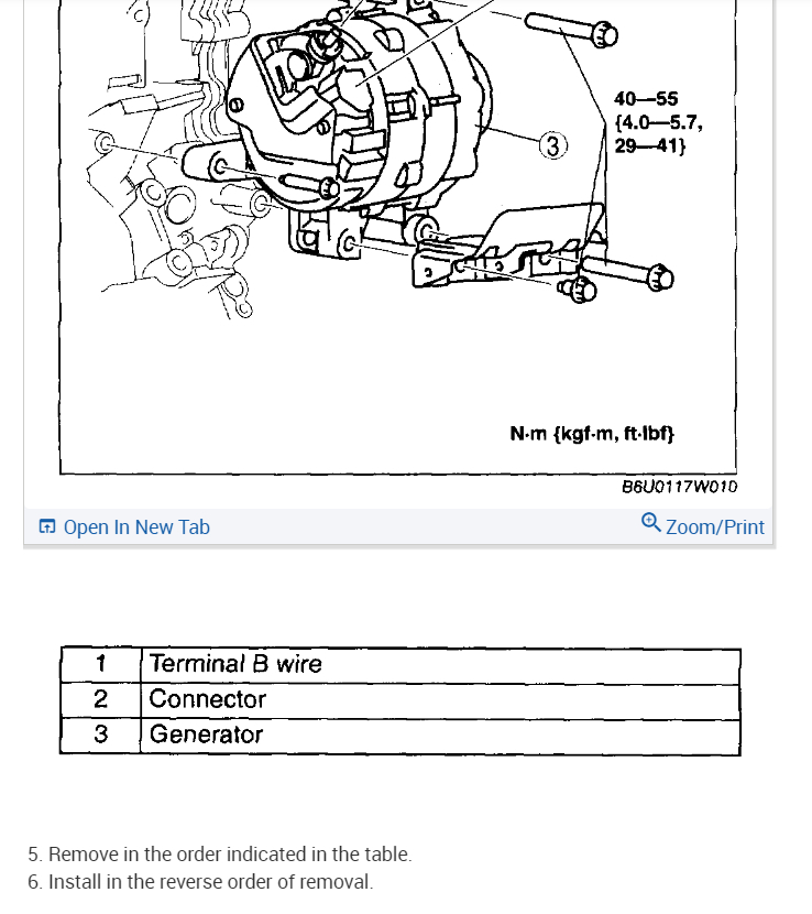

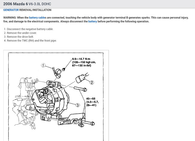

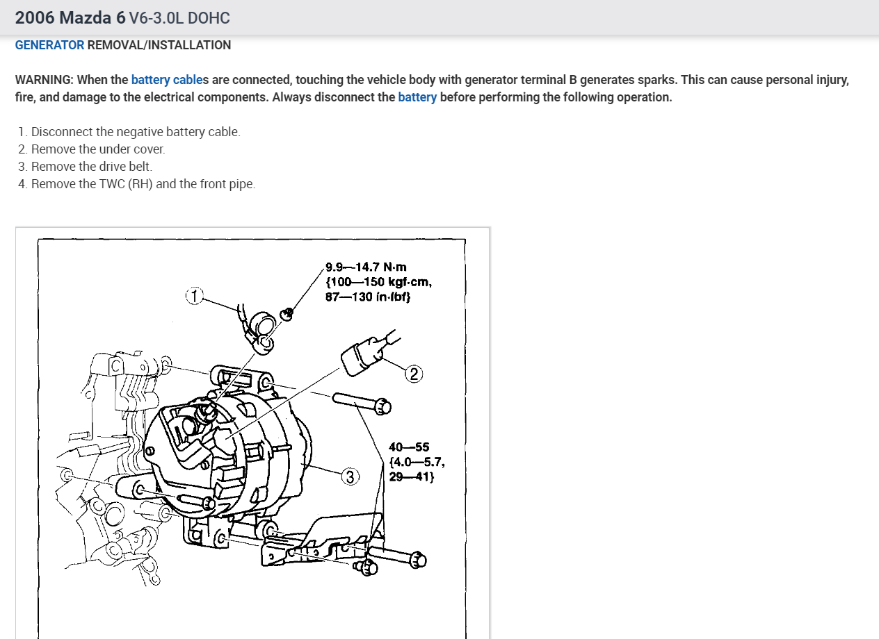

Yep, that is true it can take a while for the system to run down especially when the problem is intermittent. Here is a guide to help confirm the non-charging issue and I have included how to change the alternator our in the images below.
And this guide can help walk you thought the replacement steps:
https://www.2carpros.com/articles/how-to-replace-an-alternator
Check out the images (below). Please let us know how it goes
