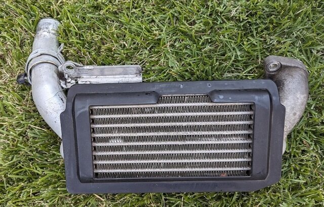

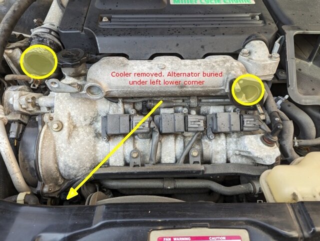

The vehicle listed above is an S (supercharged) Battery is good, but the charging system light is on. Tested voltage at battery posts while running, and it was below 13, so it looks like battery isn't charging. I had to remove the charge air cooler to access the connector plug and post from the top. I want to test voltage from the post, before assuming the alternator is toast, but can I safely run the engine with the air cooler removed? Can't access the buried alternator with the cooler in place.

You should be able to but if you upload images of what you are talking about, I can tell for sure.

Thanks for the quick response, Ken! I already watched that video - very helpful. I've attached a couple images - hope they're useful. I don't want to risk doing any damage to the supercharger or engine. I think they built the entire car from the alternator out. ;-)
Sep 6, 2023 at 2:09 PM
You should be okay, if the engine goes to full throttle shut it off, I would not rev the engine. Let me know what happens.

I have an update on the alternator issue, and a follow-up question for you. I found a post on a forum that said the Millies tend to have an issue where the alternator gets "gummed up," and stops charging the battery. The recommended fix was spraying it down with WD-40 and giving it a few taps to shake the buildup loose. I tried that, and it worked! My question is: Is there any way to ensure that the alternator won't just crap out again while I'm driving, or is it time to replace the alternator to play it safe? Pretty pricey job, because it's a nightmare to access the thing on this car.
Dec 16, 2024 at 10:49 AM
Yes, I would replace the alternator because it sounds like the brushes are worn out, this is why the wd40 and tapping will get it to work again.
