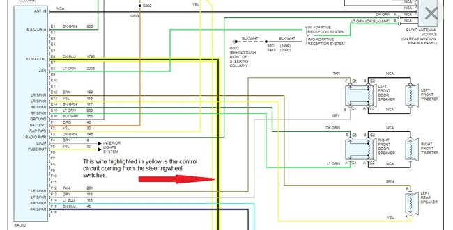

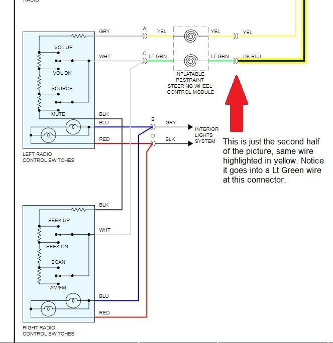

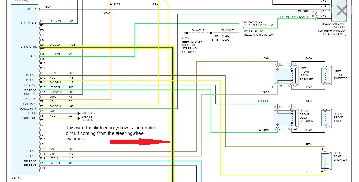

Here is a wiring diagram of a system with an amplifier. Even though both systems with or without still use this Dark Blue wire for control from the steering wheel. Different voltage signals come from the steering wheel on this same wire, going to the radio to tell it which command signal was sent.

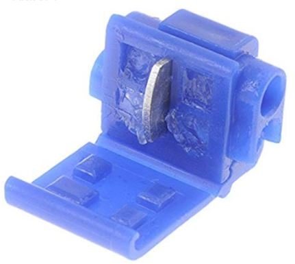

Can I use the splicer below to connect the dark blue steering control wire with the wire from my aftermarket radio to create the connection?

You have to make sure the new radio can except the voltage signals coming from the steering wheel controls. That's why I was asking if the new radio was aftermarket or not. If you notice on the second wiring diagram, the dark blue wire runs threw the front airbag module. So I wouldn't be hooking up aftermarket components to this circuit. You don't want to set the airbag off because of sending the wrong voltage threw that module.
