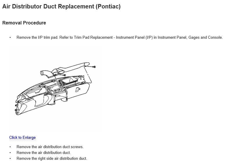

Well then, you might have had a rodent crawl into or chew through the duct work under the dash and die. How they got into the vehicle is another mystery but I suspect you should start dismantling the entire climate control duct work in search of whatever is causing the smell.
I do not have instructions for the ducts but most likely everything will be easier to get to with the instrument panel removed.
INSTRUMENT PANEL > Removal & Installation
1.Disconnect negative battery cable. Remove defroster grille and instrument panel end caps. On Cavalier, remove instrument panel trim pad. On Sunfire, remove accessory trim plate. On all models, remove instrument cluster trim plate.
2.Remove A/C-heater control panel and radio. Remove air ducts and disconnect glove box light electrical connector. Remove instrument panel from tie bar and remove instrument panel from vehicle. To install, reverse removal procedure.
I did just find this for removing the air duct.

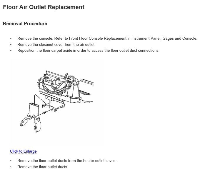

The floor air duct too.

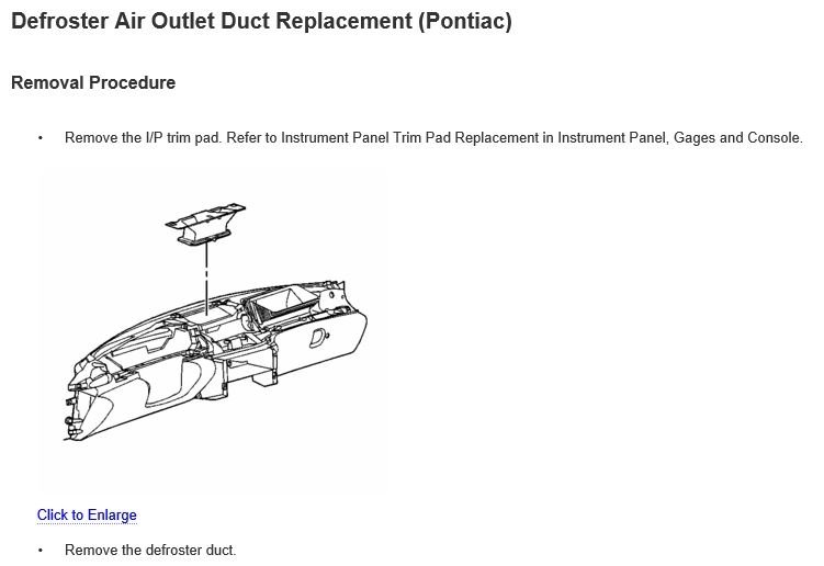

And defrost duct.
