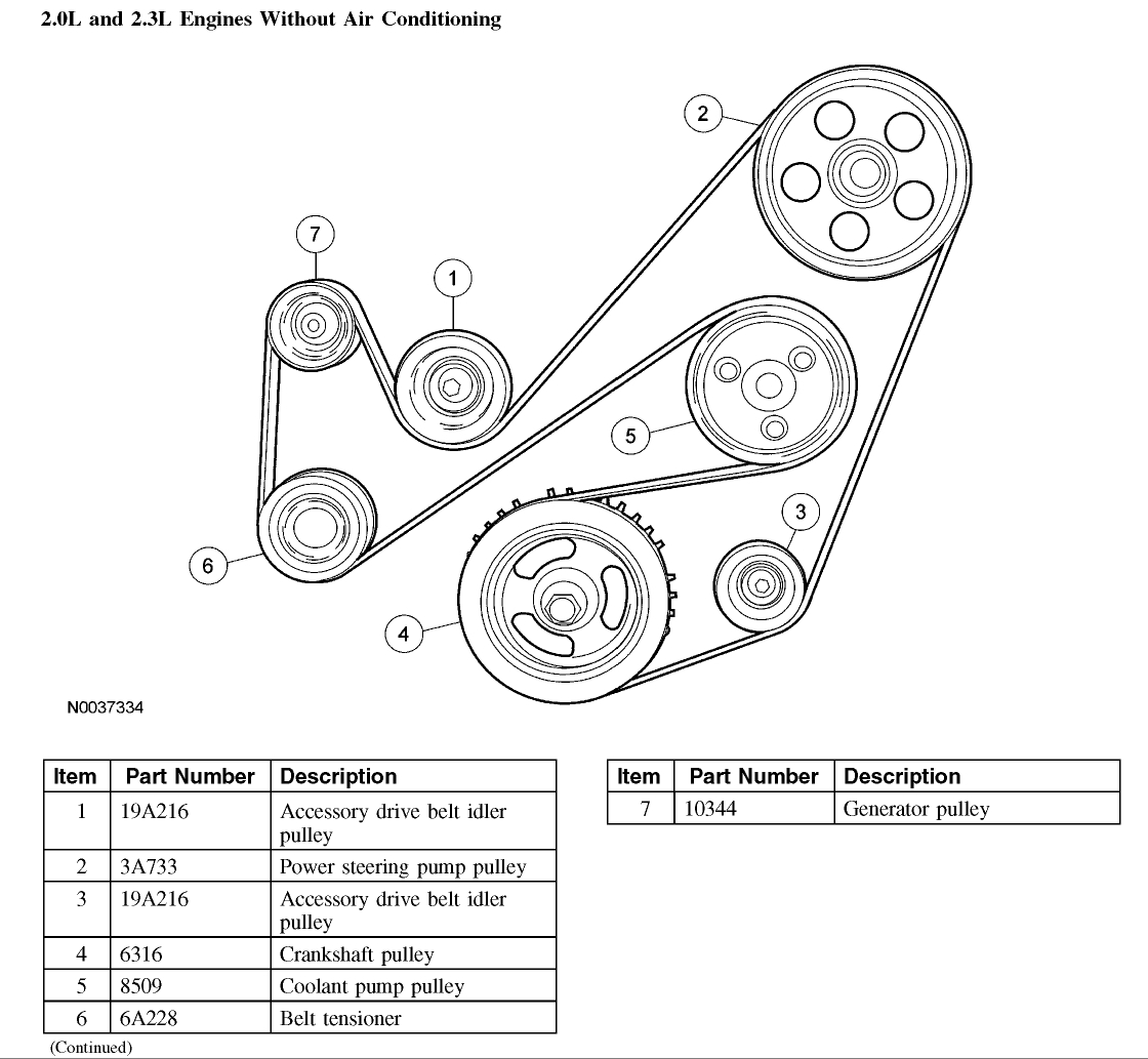

Need to know where the tensioner pulley is.

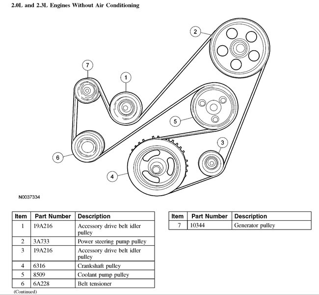

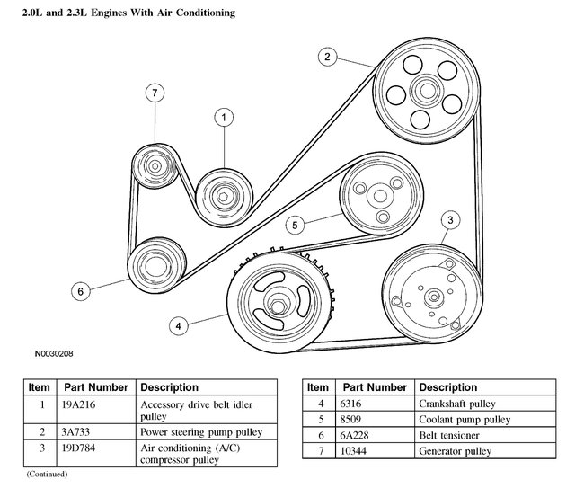

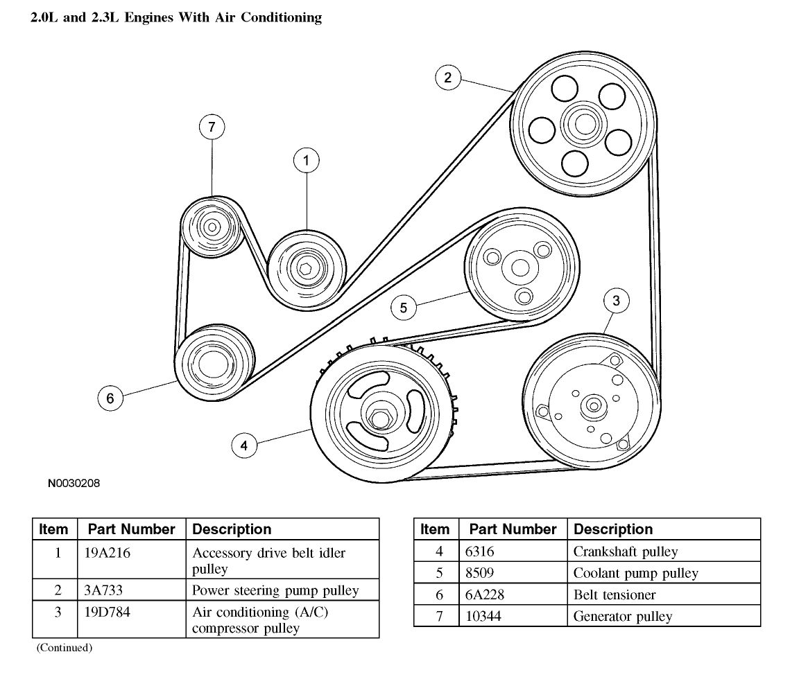

It is item 6 in these images. Spring loaded to hold constant tension. Check out the diagrams (Below). Please let us know if you need anything else to get the problem fixed.
