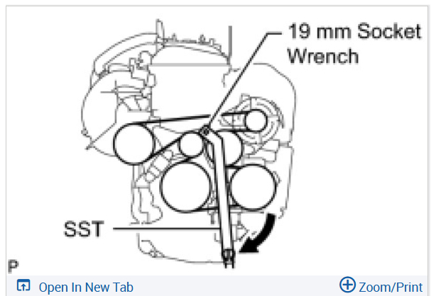

I saw on YouTube it is a 19mm but the only 19mm bolt/nut just spins the belt - where can I find a diagram or a caveman drawing how to remove the serpentine belt?

I got you covered,
Using SST and 19 mm socket wrench, loosen the V-ribbed belt tensioner arm clockwise. When retracting the tensioner, turn it clockwise slowly for 3 seconds or more. Check out the images (below). Let us know if you need anything else. Ken

Thank you very much for your concise and accurate response! Because of your response we were able to replace the alternator without removing the passenger tire or the engine splash shield! Thank you Ken
