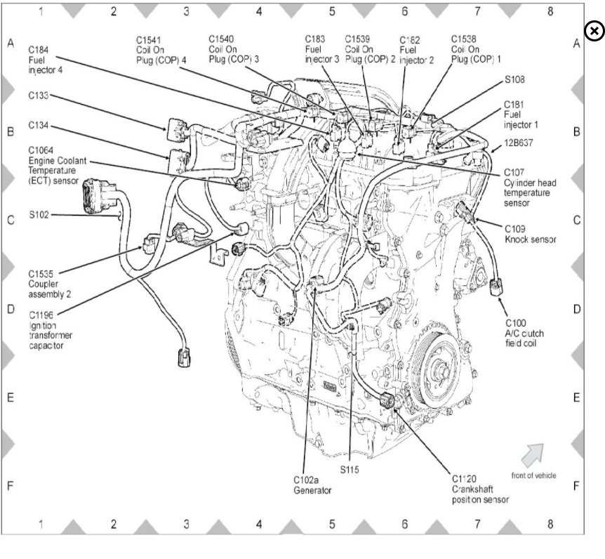

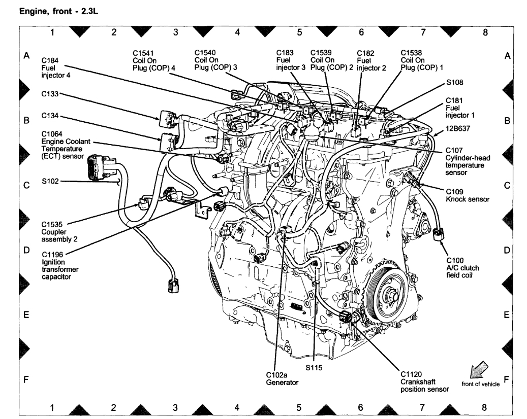

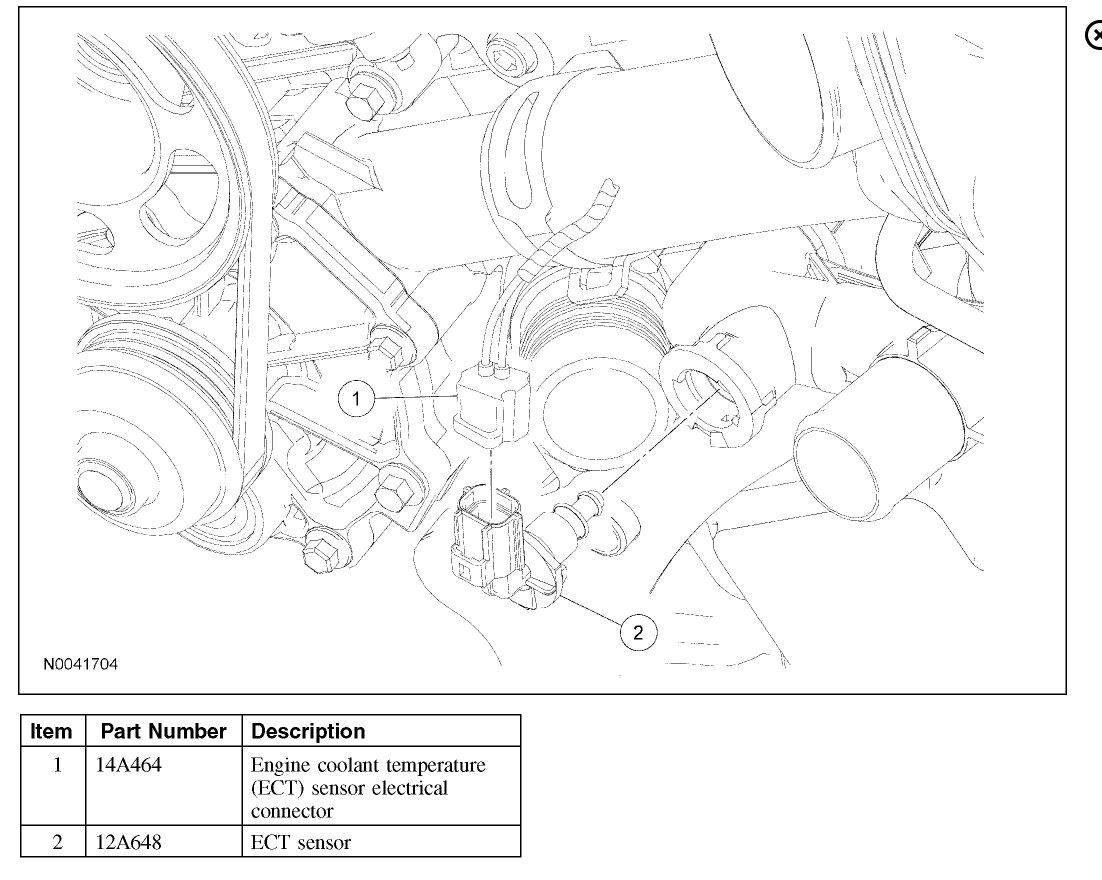

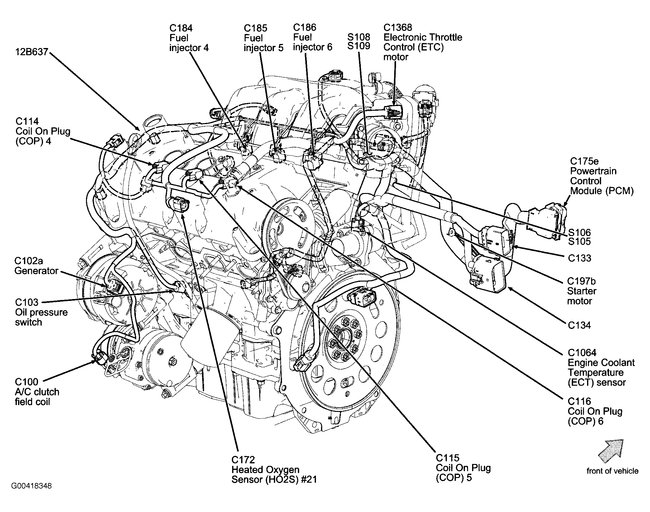

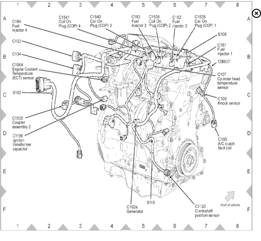

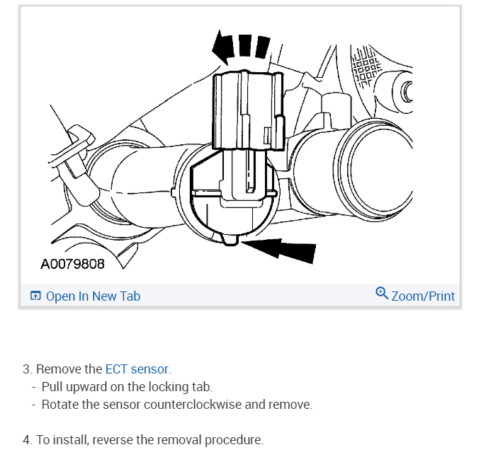

The sensor is located near the front of the engine on a coolant hose fitting. Here is a diagrams for both engines, (below) and a guide that will walk you through the steps of changing the coolant temperature sensor.
https://www.2carpros.com/articles/coolant-temperature-sensor-cts-replacement
Jul 12, 2017 at 4:05 PM
DOCFIXIT
  • 18,828 POSTS

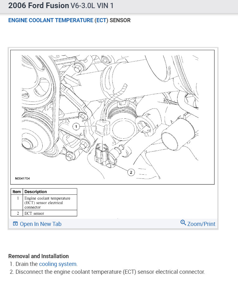

It is located on rear of engine on the thermostat housing. Follow top radiator hose to thermostat housing to find the sensor.

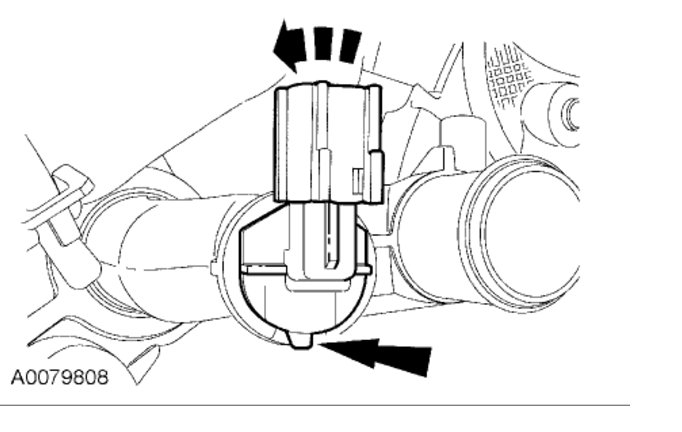

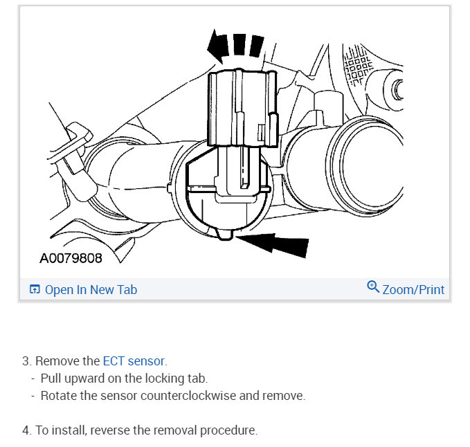

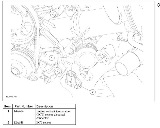

It is located near the thermostat housing at the upper radiator hose near the engine.
Here is a diagram below.

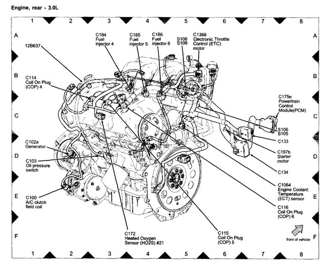

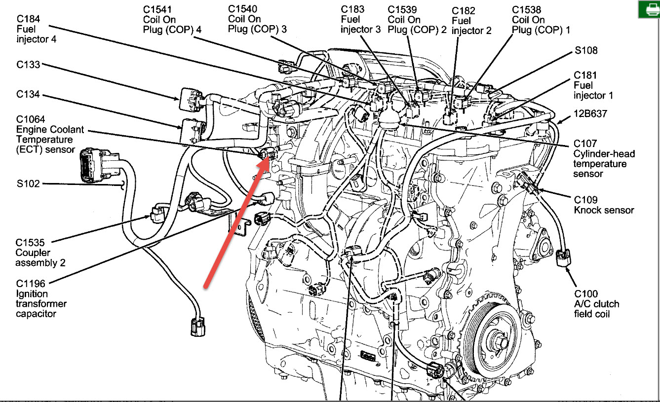

see picture marked with an arrow.

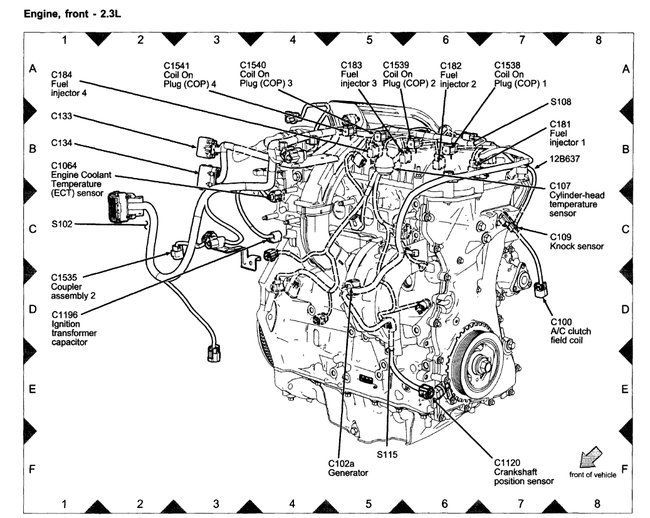

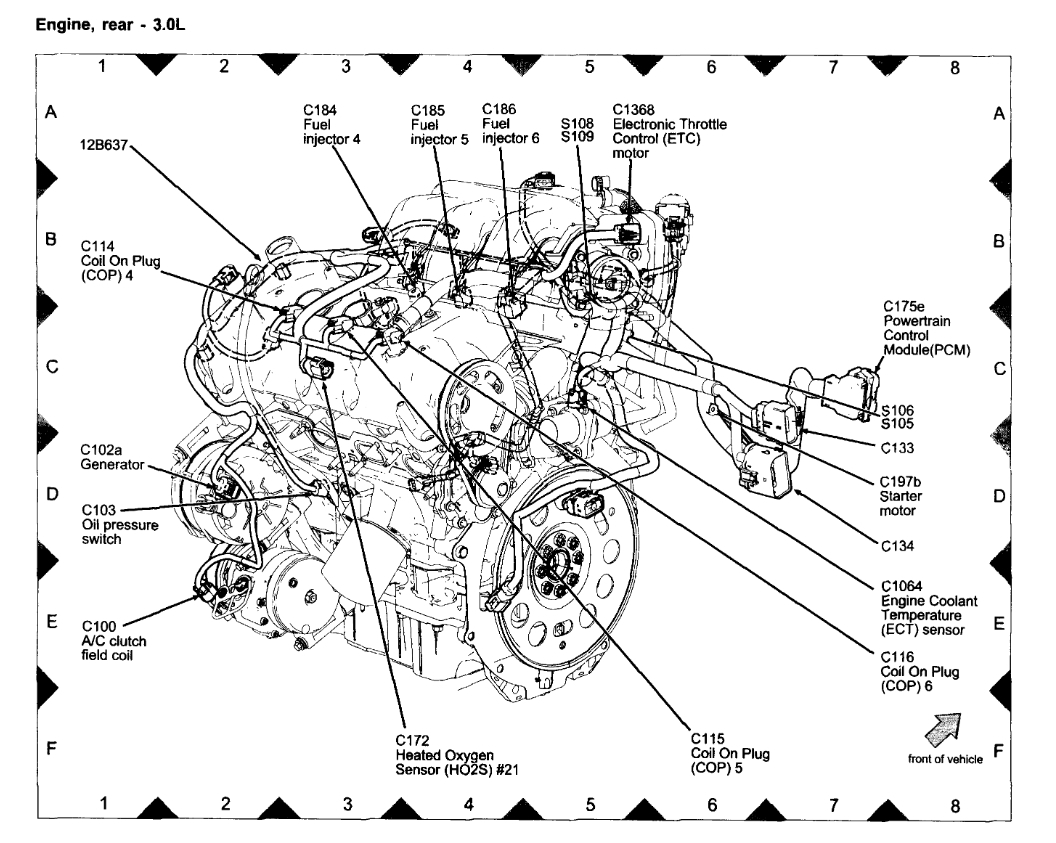

Here is a guide to help walk you through the steps of the repair with instructions and locations for both engine in the diagrams below.
