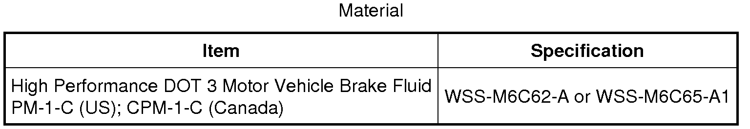

WARNING: Do not use any fluid other than clean brake fluid meeting manufacturer's specification. Additionally, do not use brake fluid that has been previously drained. Following these instructions will help prevent system contamination, brake component damage and the risk of serious personal injury.

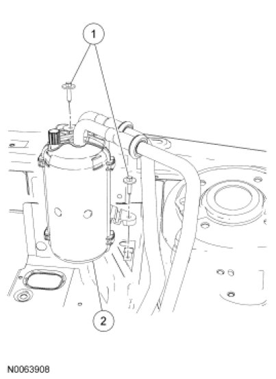

1. Position the A/C suction accumulator aside.
1. Remove the 2 bolts.
2. Position the accumulator aside.

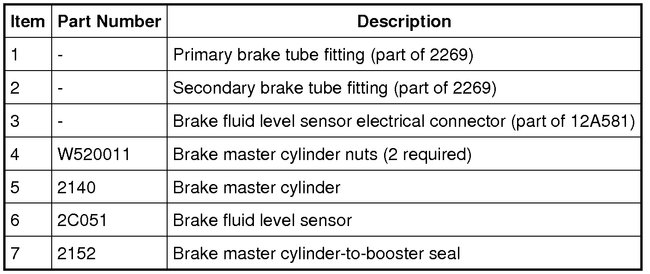

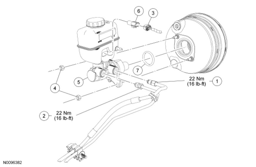

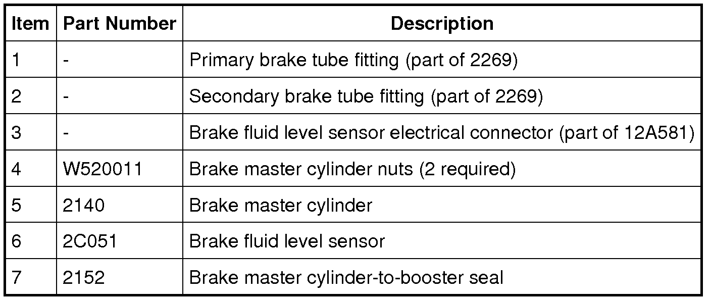

2. Disconnect the brake fluid sensor electrical connector.
3. If equipped with a manual transmission, remove the clutch hose clamp and disconnect the clutch hose from the brake fluid reservoir.
4. Disconnect the 2 brake tube fittings from the master cylinder.
- To install, tighten to 22 Nm (16 lb-ft).
- Cap the brake lines and plug the master cylinder ports.
5. Remove and discard the 2 nuts and remove the brake master cylinder.
- To install, tighten the new nuts to 23 Nm (17 lb-ft).
6. To install, reverse the removal procedure.
