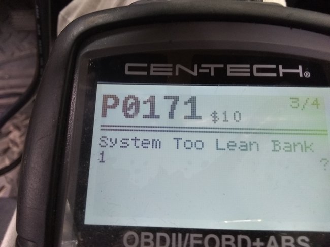

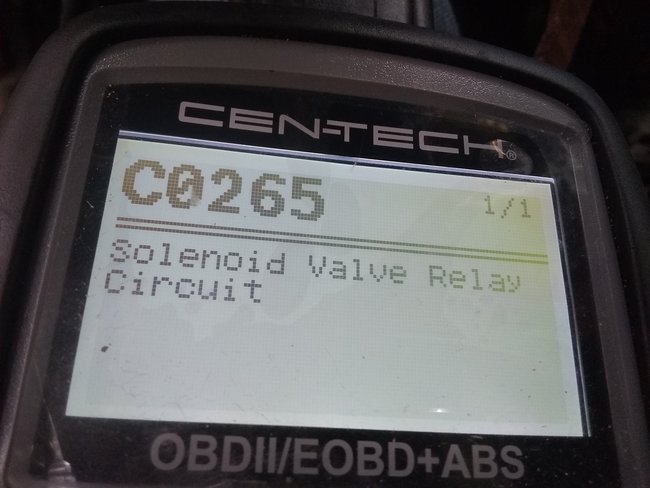

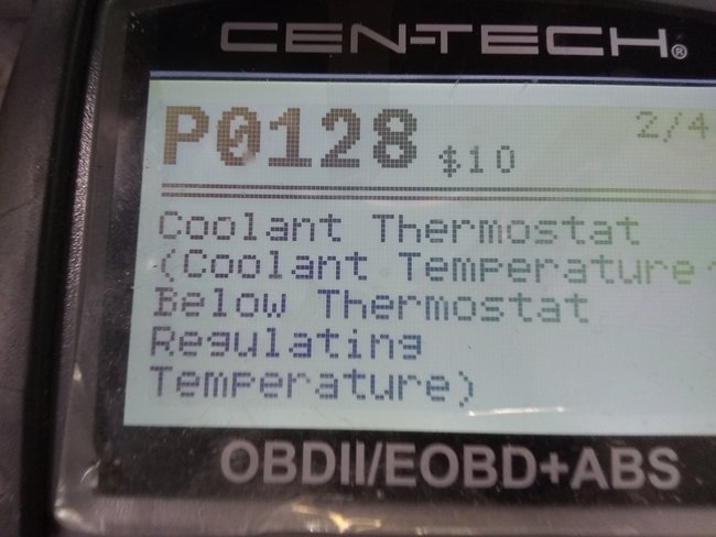

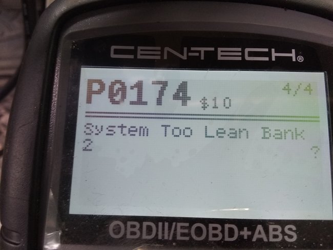

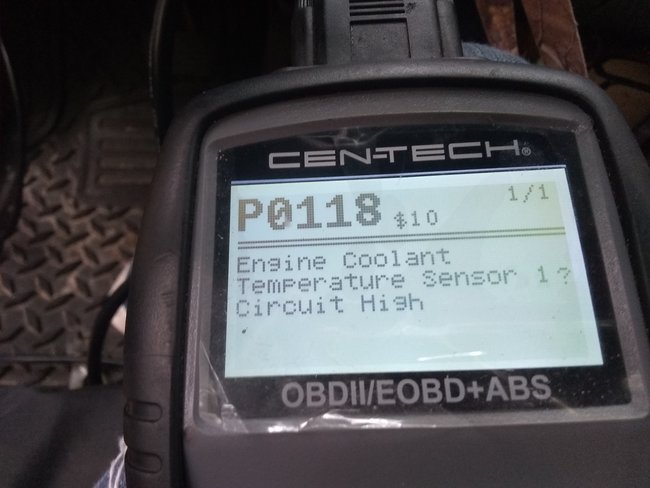

These are the codes I'm getting.
Now I have changed the thermostat twice, I have changed the coolant sensor, however neither one of these things made a change to my problem.
P0118
P0597
P0171
P0174
And most recently
C0265
My temperature gauge is still sitting on 100 and the only time it moves is when it accelerates on its own, and I'm not touching the gas pedal. It just wants to drive itself, then it cuts the truck off, like stalling the motor.
Dec 15, 2020 at 6:35 PM

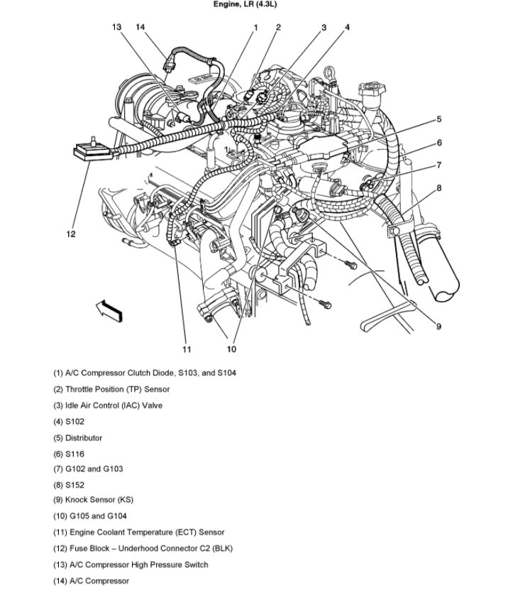

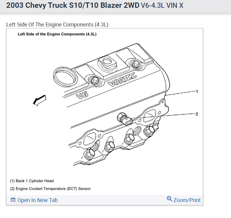

The P0118 is a coolant sensor issue. lets start there with a replacement/inspection check the connector. Here is a guide to help you step by step with instructions in the diagrams below to show you how on your car:
https://www.2carpros.com/articles/coolant-temperature-sensor-cts-replacement
