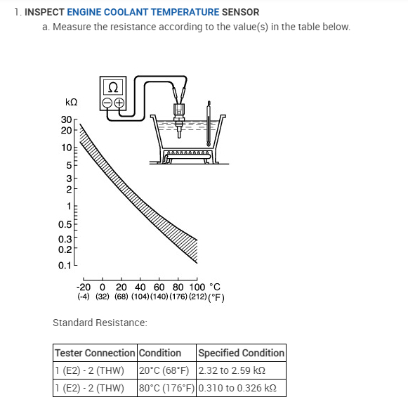

Good morning, vehicle experience overheating, the temperature gauge was on normal at the combination meter, when observing it on the scan tool, the temperature was increasing when the engine was started but it stops increase at some point and the vehicle engine was overheating.
Please is there any reading or chart that compare temperature of the sensor to resistance or voltage?

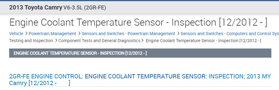

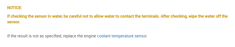

To test the sensor, you need to remove it and place it in heated water while testing resistance. I attached the directions for testing below.
I have a question. How long does it take to overheat? When it overheats, is there coolant blowing out of the coolant reservoir?
See pics below.
