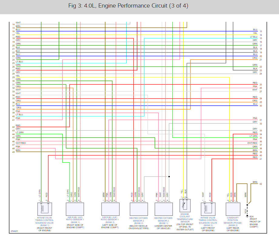

May you please help me with the color code of the lead that feeds into the coolant temperature sensor of the vehicle listed above? The loom was tempered with. So I'm failing to locate it.
