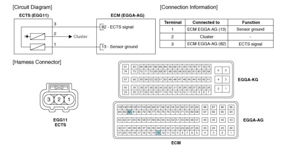

Description of Problem: I scan . P0118 KIA - engine coolant temperature sensor 1 circuit high input. Well, sir, my cooling fan has broken down. Now I replaced a new assemble cooling fan when I started the engine simultaneously with the cooling function it did not trip off. The A/C was not cool too. Even the temperature gauge is not working. Now I replaced the new temperature sensor. I still have the same result. The other mechanic said the engine computer module might be faulty. Then by checking the ECM there is only 3.28 voltages on the ECM going to the temperature sensor and there is nothing like continuity connection. sir it is possible the ECM is so broken sir. Thanks
