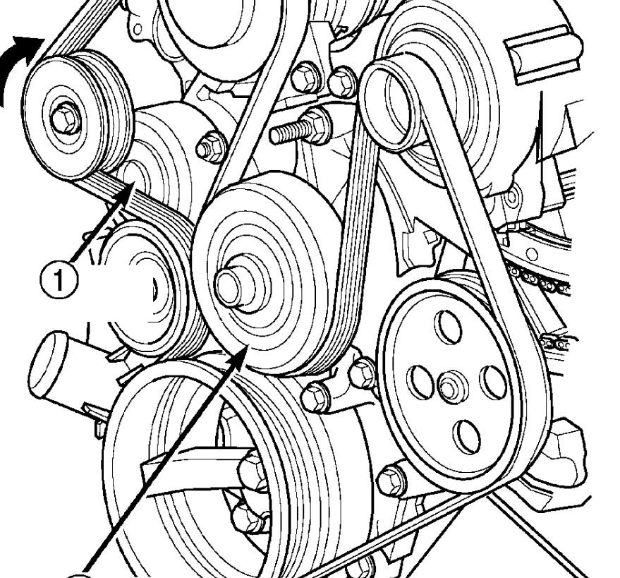

Now remove the drive belt from the water pump pulley (2) by using the tensioner to release it.

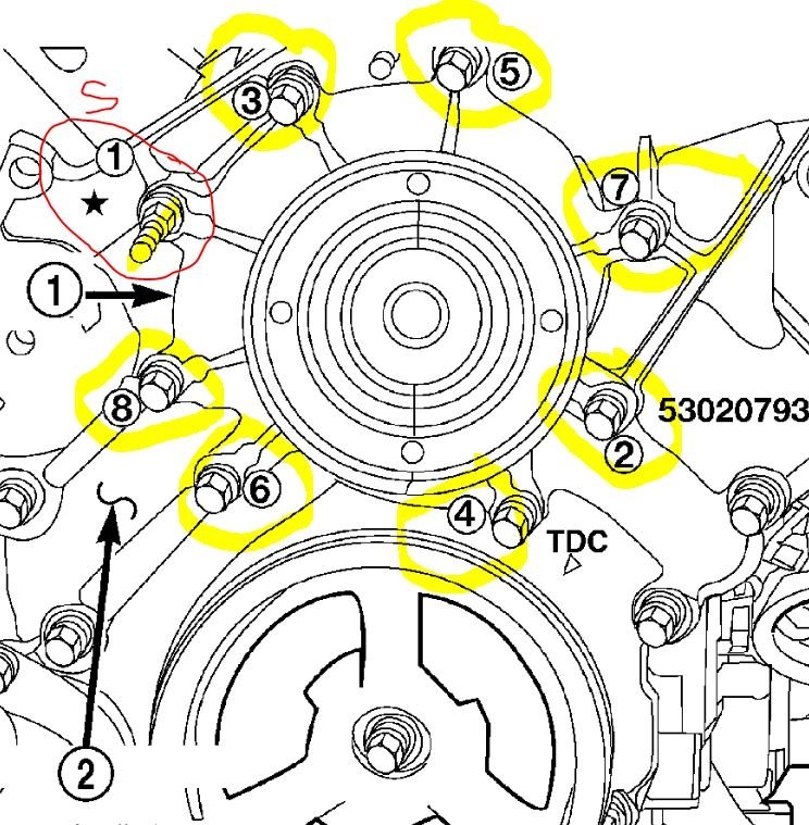

Remove seven water pump mounting bolts and one stud bolt and the pump will come off with a bit of force.
Now use a scraper to gently remove all traces of the old gasket.
To install the replacement you reverse the process and use the pattern shown to tighten the bolts down to 43 foot pounds. The red circle is where the stud goes. Both engines use the same pump and this is one area I tend to go with aftermarket because the OE pumps use a plastic impeller, Gates makes a replacement 43263M with a metal impeller that seems to hold up better.
Once the pump is in place and snug spin it to be sure it doesn't rub, that happens on some of them when the impeller isn't exactly correct, more so on the plastic ones though.
The gasket goes on dry, or if you need something to hold it in place a quick spray of high tack on the pump side can help but isn't usually needed if you put a couple bolts through it to hold the gasket. Then final torque the bolts, put the belt on and reverse the rest to put it back together. I usually replace the fan clutch at the same time if there is any doubt that it is working. The common test for them is to start the engine, let it run and listen to the fan, it should engage for about 30 seconds or so from a cold start and then sort of just idle along even if you tap the throttle. Then once the engine warms up fully it should start to cycle on and off, at that time you should hear the sound change from very little sound to a roaring as the fan starts pulling air. If you don't hear that then it's likely the fans clutch is bad and will need replacement.
