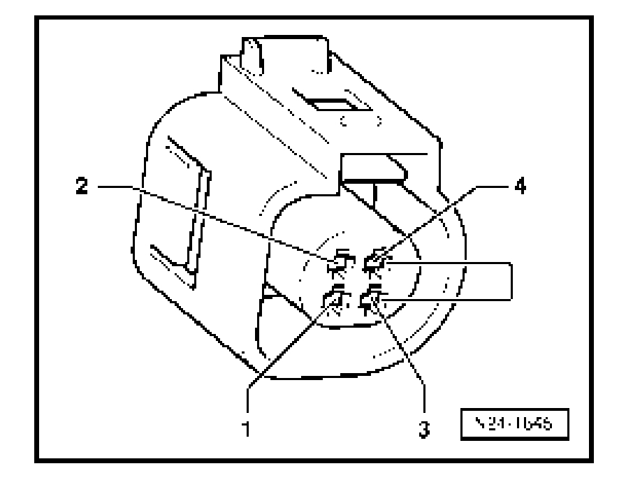

Test requirements
pic 1
- The respective fuses of Motronic Engine Control Module (ECM) -J220- must be OK.
- Parking brake must be engaged or else daylight driving lights will be switched on.
- For vehicles with automatic transmission, selector lever must be in position -P- or -N-.
- Engine must be cold.
Function test, Vehicles with engine code AVH, AZG, BDC

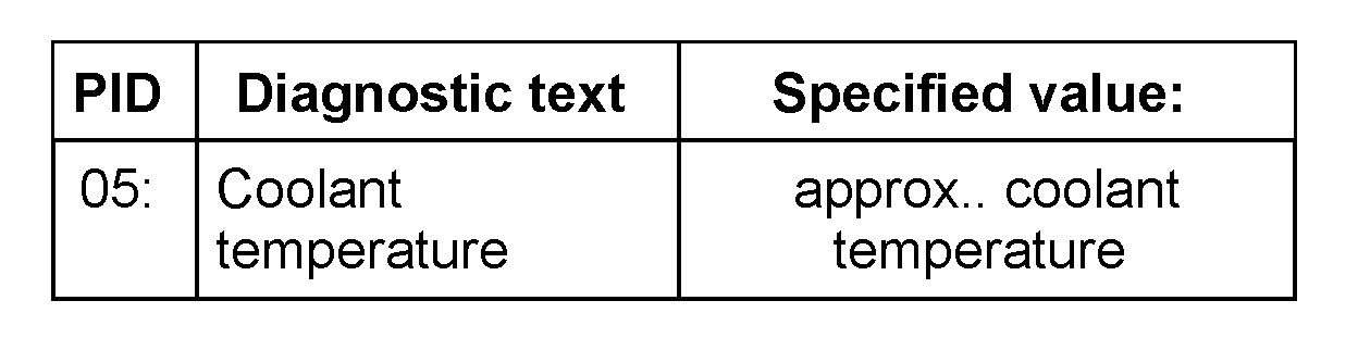

- Under address word 33, select "Diagnostic mode 1: Checking measured values."
- Select the measuring value "PID 05: Coolant temperature".
- Check specified value of coolant temperature:
pic 2
If specified value is not obtained:

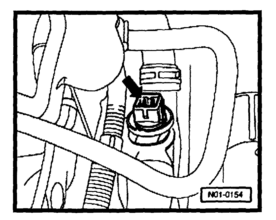

pic 3

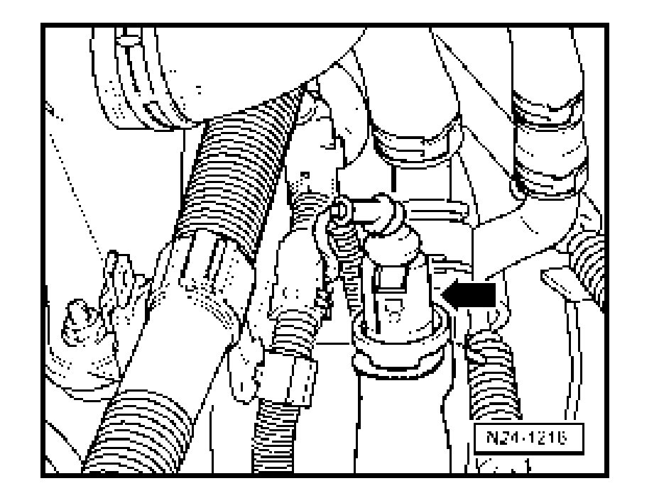

- Disconnect 4-pin connector from Engine Coolant Temperature (ECT) Sensor -G62- with Engine Coolant Temperature (ECT) Sensor -G2- (arrow).
pic 4
- Bridge terminals 3 + 4 of connector using the respective adapter cables and observe the indication on display.

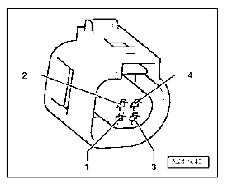

Continuation of test if indication is approx.. 140.0 degrees C:
pic 5
If indication jumps to approx.. -40.0 degrees C:

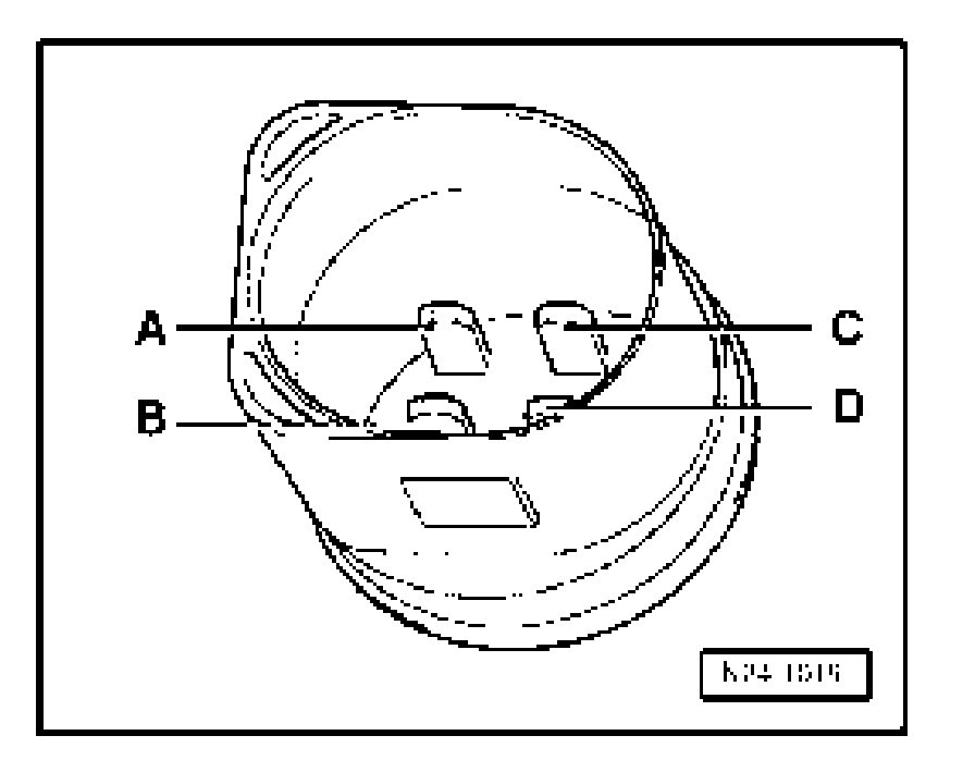

pic 7
- Measure resistance at Engine Coolant Temperature (ECT) Sensor -G62-, terminals C (signal) and D (Ground -GND-).
pic 8

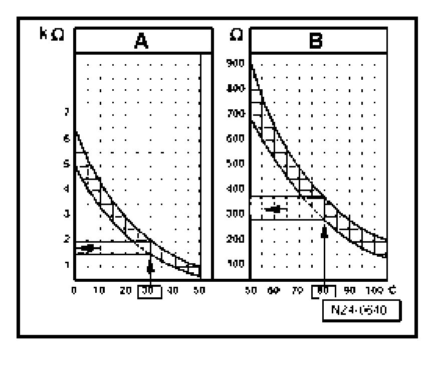

- Range A displays resistance values for the temperature range of 0 to 50 degrees C, range B displays resistance values for the temperature range of 50 to 100 degrees C.
Read-out examples:
- 30 degrees C is in range A and corresponds to a resistance of 1.5 to 2.0 k Ohms
- 80 degrees C is in range B and corresponds to a resistance of 275 to 375 Ohms

- Replace Engine Coolant Temperature (ECT) Sensor -G62-:
- Vehicles with engine code AVH, AZG, item 17,
- Vehicles with engine code BDC, item 15.

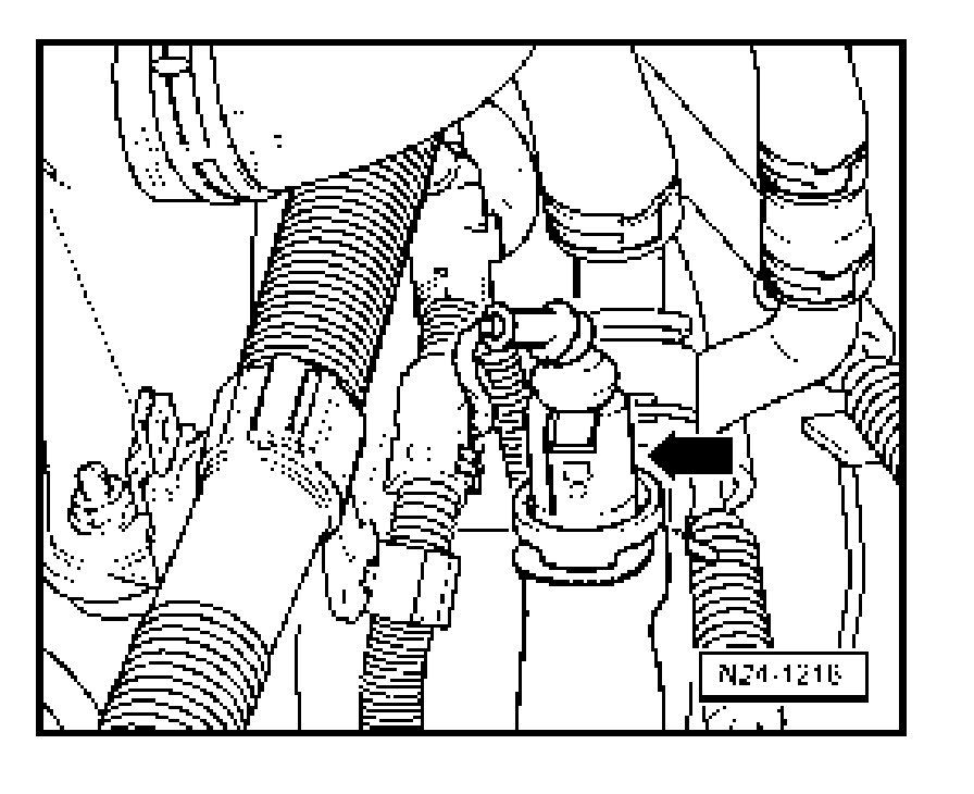

The last pic I attached shows the sensor's location. It will be on the driver's side of the engine. Make sure the connector isn't corroded, damaged, or just loose.
