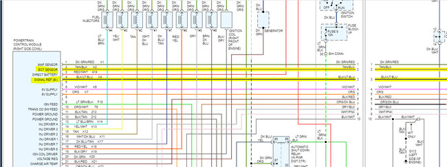

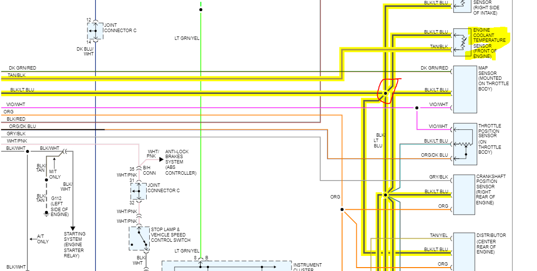

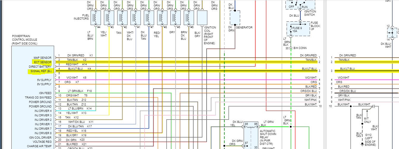

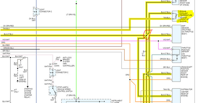

There is a chance the wiring is causing issues, the PCM isn't receiving a signal, or the gauge is faulty.
Here is what to do: At the ECT, there are two wires. One is tan with a black tracer and the other is blue with a light blue tracer.
The tan/black wire provides a 5v reference from the PCM. With the key on, confirm that is the case.
The blue/light blue wire is a ground reference from the PCM. Again, with the key on, check that wire for continuity to ground.
Let me know what you find.
See pic below.
