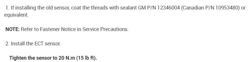

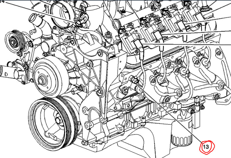

I've attached 2 picture below of its location circled in red number 13 and the torque specification.Keep me updated and let me know if you have any further questions on this issue.Hope this helps and thanks again for using 2CarPros.
