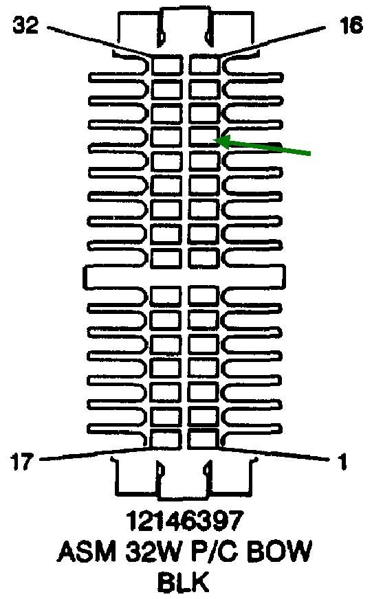

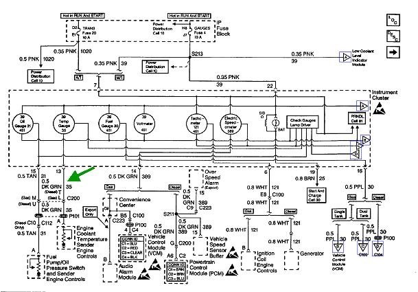

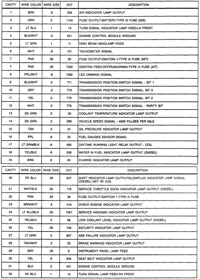

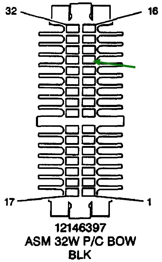

The green arrow is pointing to terminal 13 in the instrument cluster's plug. That's for the coolant temperature sending unit.
