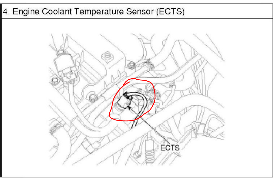

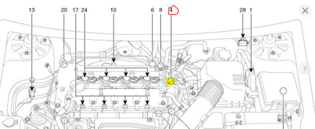

Chances are either there is a connection issue or the sensor is going bad. The engine coolant temperature sensor is located at the rear of the cylinder head. See pictures 1 and 2. Check to make sure the connections is tight. If it is, here are the directions for testing.

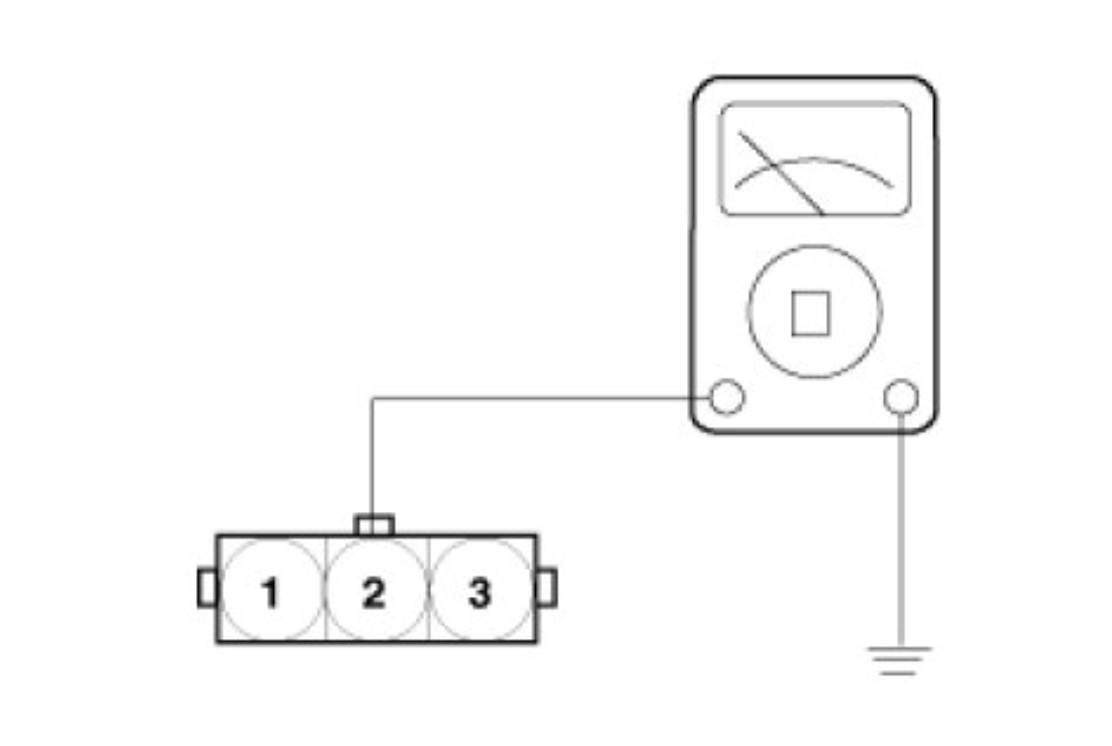

1. Using an ohmmeter, measure the resistance between the terminal 2 and ground.

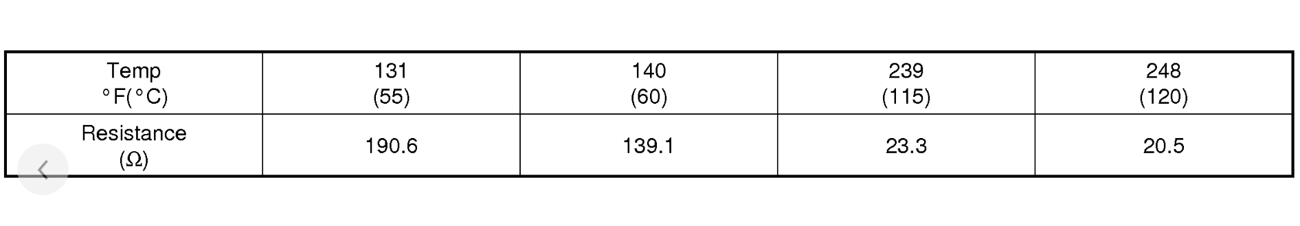

2. If the resistance value is not as shown in the table, replace the temperature sender.
