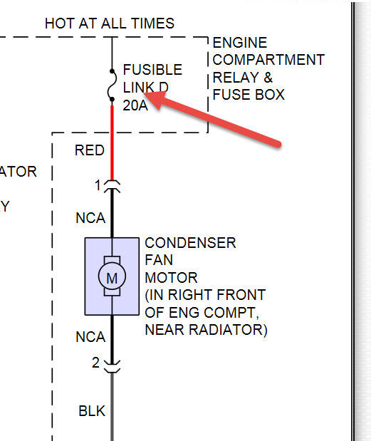

the temp on car may go up a tad due to circumstances around you like how hot it is, stop and go traffic etc. however see if your condenser fan is working it's in front of radiator and should go on when you turn your a/c on. then check item in pic as well as condenser fan relay. you can switch with a like relay is easiest way
