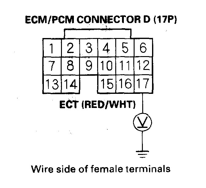

There is a chance of a short to the IAC and IAT. I'm going to provide the diagnostics for both codes. Let me know if it is something you are comfortable doing.
I want you to note that when looking at the connector views below, both sensors are located right next to each other. I can't be sure, but I suspect that is where you will find the issue.
The attached pics correlate with the directions.

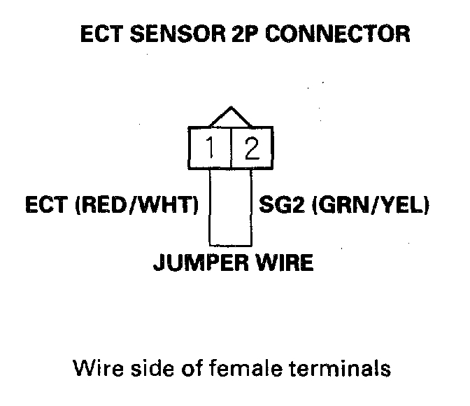

3. Turn the ignition switch OFF.
4. Disconnect the ECT sensor 2P connector.
pic 1
5. Connect ECT sensor 2P connector terminals No.1 and No.2 with a jumper wire.
6. Turn the ignition switch ON (II).
7. Check the ECT SENSOR in the DATA LIST with the HDS.
Is about -40 °F (-40 °C) or less, or 4.90 V or higher indicated?
YES - Go to step 8.
NO - Go to step 13.

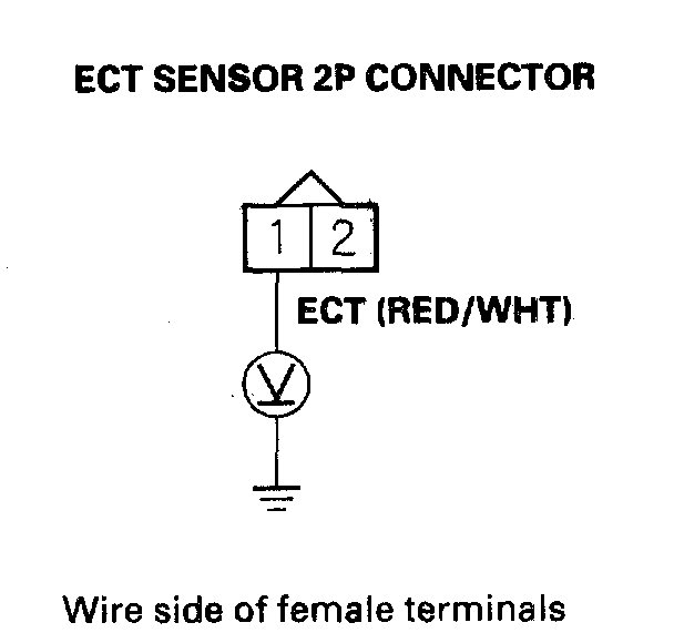

8. Turn the ignition switch OFF.
9. Remove the jumper wire.
10. Turn the ignition switch ON (II).
pic 2
11. Measure voltage between ECT sensor 2P connector terminal No.1 and body ground.
Is there about 5 V?
YES - Repair open in the wire between the ECM/PCM (D10) and the ECT sensor, then go to step 15.
NO - Go to step 12.

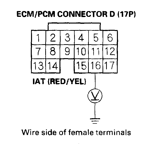

pic 3
12. Measure voltage between ECM/PCM connector terminal D17 and body ground.
Is there about 5 V?
YES - Repair open in the wire between the ECM/PCM (D17) and the ECT sensor, then go to step 15.
NO - Go to step 19.

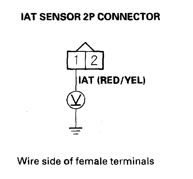

4. Disconnect the IAT sensor 2P connector.
pic 4
5. Connect AT sensor 2P connector terminals No.1 and No.2 with a jumper wire.
7. Check the IAT SENSOR in the DATA LIST with the HDS.
YES - Go to step 8.
NO - Go to step 13.

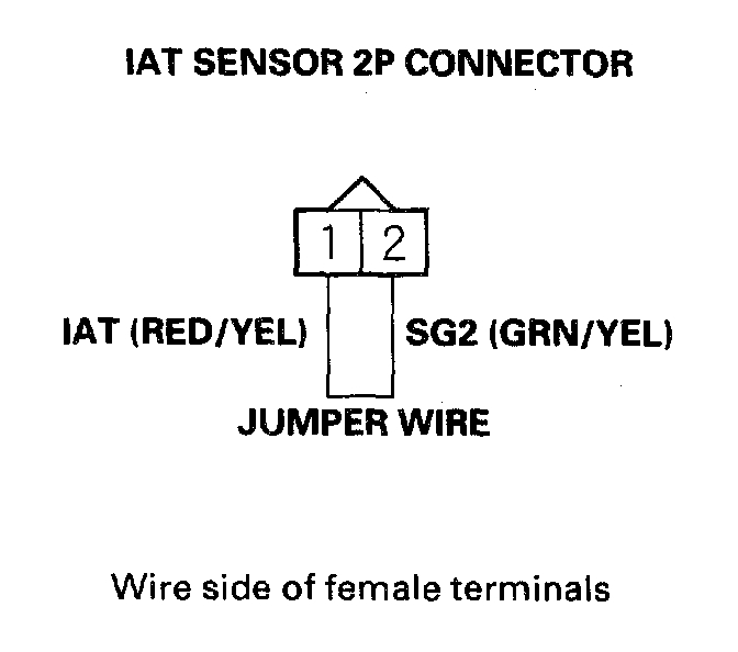

pic 5
11. Measure voltage between IAT sensor 2P connector terminal No.1 and body ground.
Is there about 5 V?
YES - Repair open in the wire between the ECM/PCM (D10) and the IAT sensor, then go to step 15.
NO - Go to step 12.

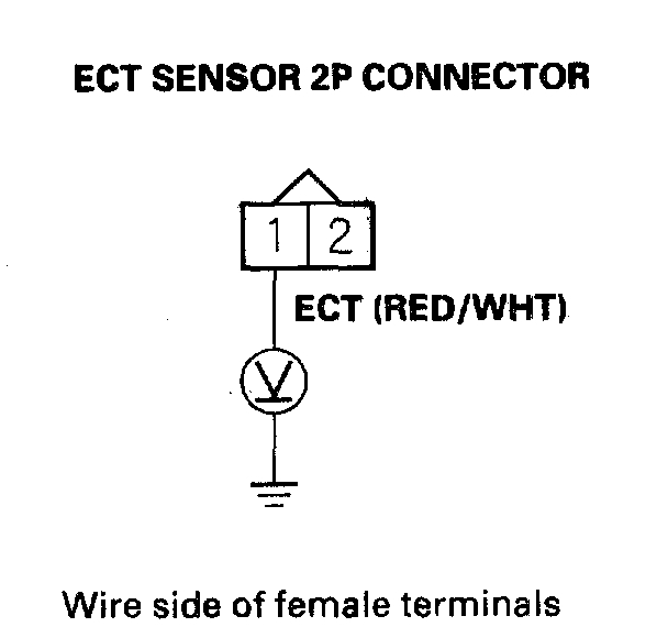

pic 6
12. Measure voltage between ECM/PCM connector terminal D16 and body ground.
Is there about 5 V?
YES - Repair open in the wire between the ECM/PCM (D16) and the IAT sensor, then go to step 15.
NO - Go to step 19.
