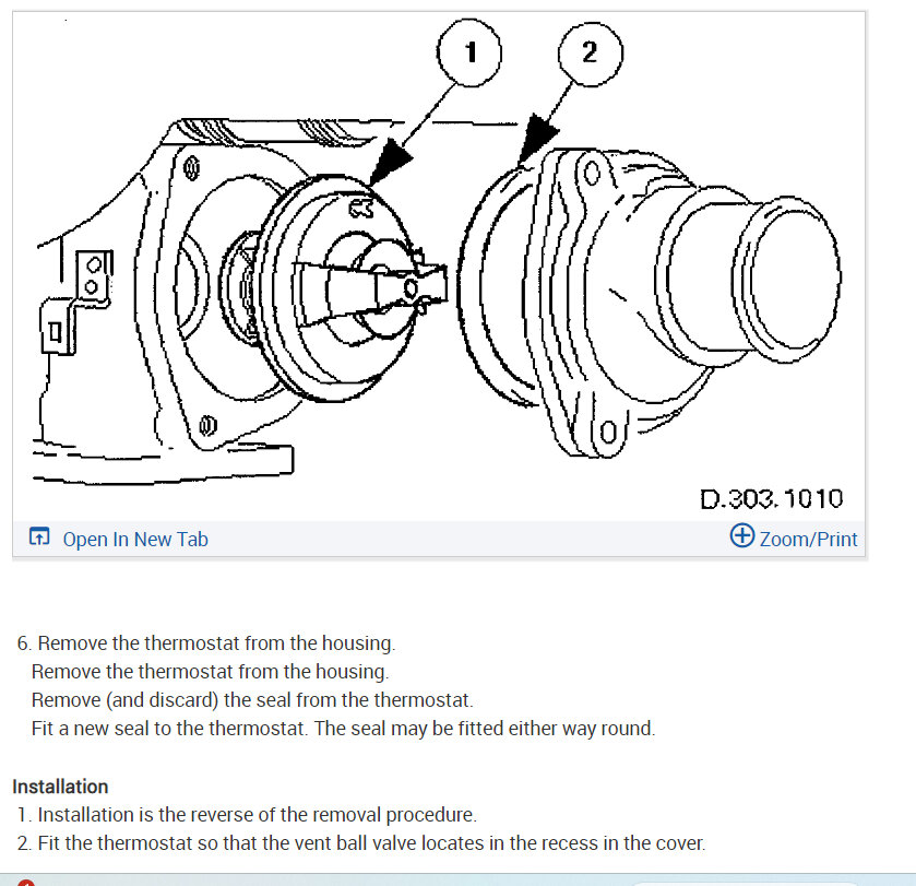

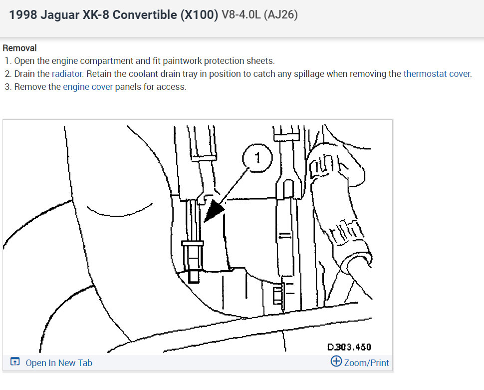

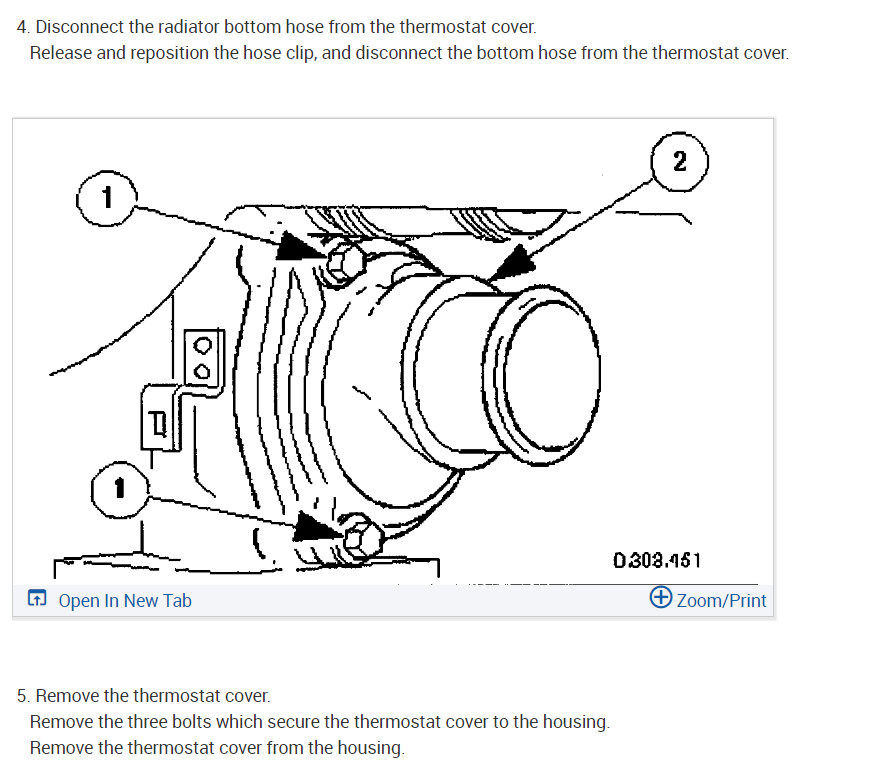

It sounds like the thermostat is stuck but can I ask if the cooling fans were on when the car was overheating? If so, I would swap out the cooling system thermostat. Here are two guides that will help, and I have included how to change the thermostat out in the images below.
https://www.2carpros.com/articles/engine-overheating-or-running-hot
and
https://www.2carpros.com/articles/symptoms-of-an-overheating-engine
Check out the images (below). Please upload pictures or videos in your response of any problems so we can see what to help you with.
