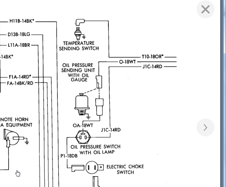

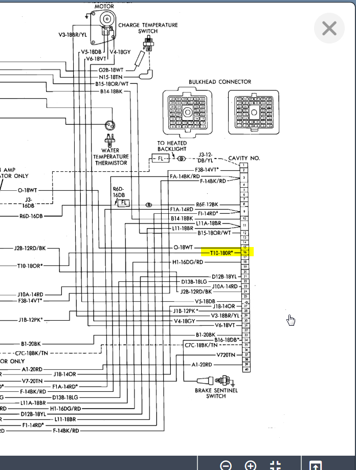

This is most likely one of three things. Either the sensor, the wiring or the gauge.
Most likely it is the sensor or the wiring. I assume you already put a sensor in it so if it were me, I would just run a new wire from the sensor to the gauge.
Let me know if there is more to this and if I am missing something and we can go from there. Thanks
