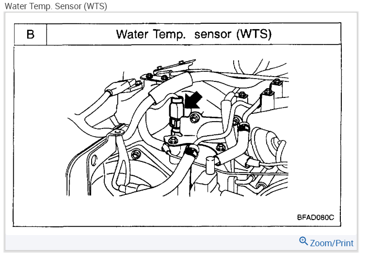

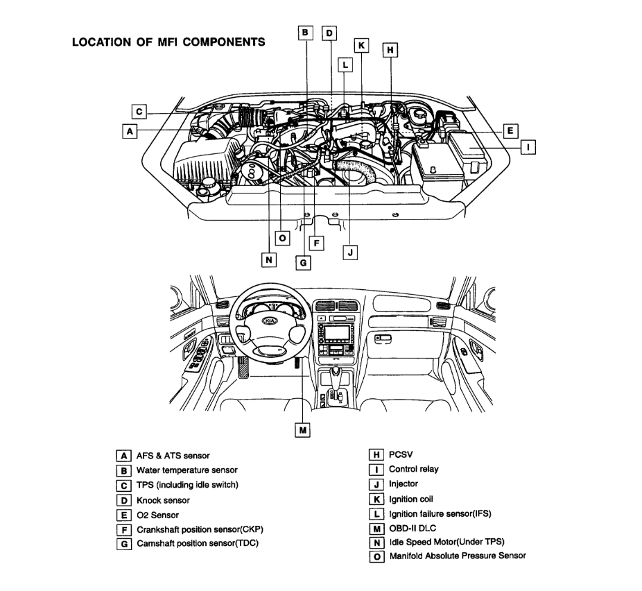

It sounds like the engine coolant temperature sensor is not working right. The engine should start cold and then go up to operating temperature which is about 205-210 Degrees.
Here is a guide that will walk you through the steps and a diagram below to show you the location of the sensor for your car:
https://www.2carpros.com/articles/coolant-temperature-sensor-cts-replacement
